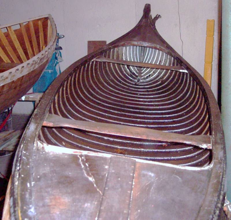

The photos below show what I think you are describing. The first two are of a canoe with typical rounded deck profile, showing no top cap running the length of the canoe. The last proto is of a canoe with "peaked" decks- deck panels are flat and come to a sharp peak at the kingplank. The cap covering the inwale between decks is raised on a filler block, and sits at the same angle as the decking. In this canoe, the coaming at the decks meets the rail at a sharp angle betwen the decking and the gunwale top cap.

Michael - Thank you for your input and photos. This is a new canoe, so I do not have a prototype to work from. What I have in mind is the detail in your first two pictures, with no continuous rail cap running the length of the canoe. So my question is - how are the edges of the deck and outwale shaped, and how do they align with each other? The photos seem to show rounded edges on both pieces, with the respective rounded edges just 'kissing' each other - am I seeing this correctly? Any thoughts on letting the deck run over the top edge of the outwale just a hair and then bringing the outwale up tight under it? Thanks again, LEW
Your observations are correct. You could do well to let the decks run over the cap, then use planes/spokeshaves to bring both pieces to the edge you want simultaneously. I'm not sure how stable those wide expanses of cherry will be over the years (I've not tried anything like this), but it sure sounds like a beautiful canoe.
