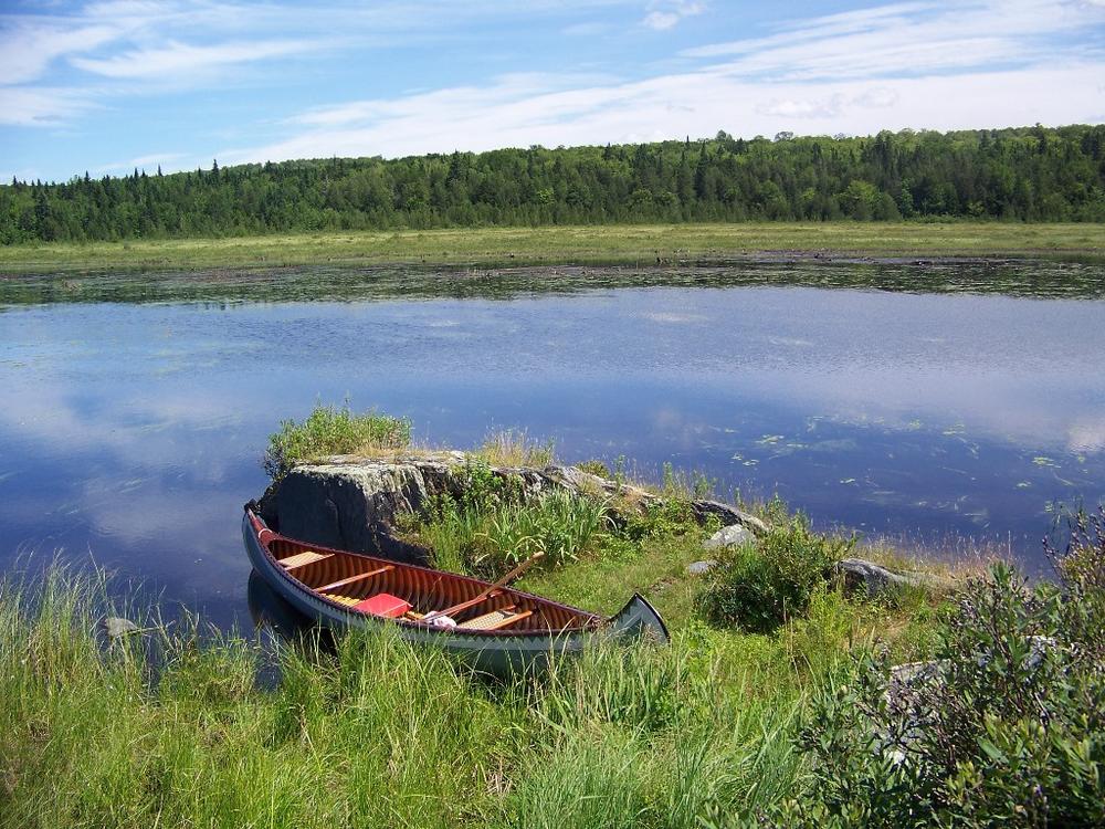

For several years my wife and I have used a 15' Old Town 50 pounder for day tripping on local rivers, beaver streams, bogs, and lakes. It has more than adequate capacity for two, is quite agile even with a keel, has been a serviceable solo canoe, and would handily serve for a short camping trip.
Lunch stop on a day trip through the West Shirley Bog, Maine, with the 15' canoe.
