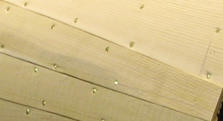

Construction of a wood & canvas canoe is very different than that of a strip canoe, as shown in your Avatar. The strip canoe is indeed glued.
These wood and canvas canoes are not glued. We use brass or copper tacks to hold the planking in place.
The builder makes an effort to butt the planking, but since water tightness is not a requirement, gaps are not a problem. Adhesive is never used. Once the hull is finished, it is covered with a canvas that is then stretched, filled and painted. That is the waterproof element in this style of build.
I have (as do others) numerous old canoes that with large gaps between the old dried out planks. Aside from an aesthetic consideration or the likelihood of sand and detritus finding their way under the canvas, there is no harm in this. As long as your lunch won't get lost in the cracks, it's fine.

So, that out of the way, if you do decide that is your passion, there is no magic to this. To reduce the gaps, you simply need to build the hull more carefully. As you plank it, the fits of the planking are 100% controllable. It's as simple as that.
Zoom in on Dave's image of the boat he is building. The fit of the planking looks very good to my eye. I doubt he would give a moment of consideration to putting glass on that, but if he did, it would look pretty good.
