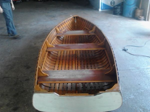

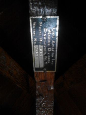

Does anyone know anything about these boats? A google search only turns up info on the Linkanoe collapsable boat. For a guy as accomplished and well known as Mr. Link is I expected to find more!
I assume they were (are) canvas covered?

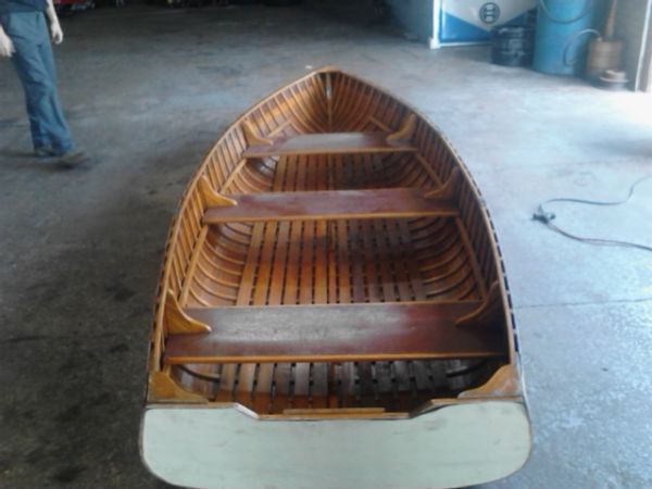

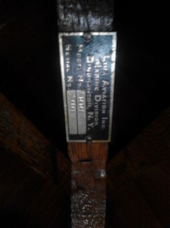

I was just given the identical boat. It had been stored in an attic for about 40 years. I was told that it was a Penn-Yan "Cartopper" which it certainly is not. It has the same Id tag as yours with a model # and serial # I too can find no information about this boat. It is 11' 6'' long with a 46" beam with two sets of oarlock sockets.
It apparently was origonally canvas covered as there is some form of adhesive or filler residue all over the hull. The interior is in excellent condition.
I am trying to find out it's year of manufacture and approximate worth. I intend to re-canvas it and am currently searcching for a source for # 6 Duck canvas 72" wide.

You have a Link CARCARRY. It was listed as 12', beam 48", with monel fastenings, 2 pair of bronze locks, 80 pounds and ideal for car topping. Construction consisted of oak ribs and marine grade plywood. No mention of a canvas covering.
This was part of a line of Link "rigid boats" that consisted of the 15' HERON and the 12' CARCARRY. Link advertised them as the "same workmanship which Link puts into sectional craft and famous Link trainer". I believe the rigid boat line was added late in an attempt to increase business. In any case it all ceased in 1949.
Not sure how many were made but I doubt you will meet another one out on the lake!

I can't add much of significance to what is already in this thread, as Bob Snyder has answered better than I could. As far as I know all Link canoes and boats were built at Gananoque, Ontario. You might find this name on a decal. Link also built a canvas-covered sectional rowboat, which is not what you have, but I believe I saw one at the Antique Boat Museum in Clayton, NY, if that is of interest. The factory at Gananoque was sold to employees in the early 1950's, and wooden boats, mostly powerboats, continued to be built there, but not under the Link name. Tom McCloud

My boat is constructed with what appears to be oak ribs and 7/8" strip planking. I dont know what type of wood was used for the planking but it is certainly not plywood, maybe cedar?
The exterior of the hull was not faired to any extent and that fact plus the residue of adhesive or maybe filler on the hull leads me to believe it was canvas covered. The transom still had the canvas attached. There was also a 3/8" oak plate attached to the transom probably to accomodate an outboard motor.
I have recovered the hull with Dacron primarily to reduce the weight versus canvas and am curently in the process of filling and painting.

Nice restoration on you boat.
