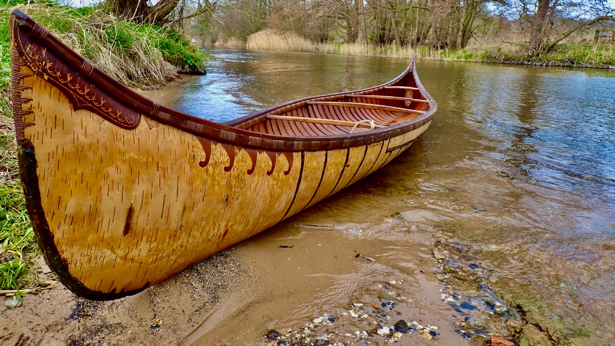

If anyone saw you paddling this ancient canoe at the crack of dawn, they must have thought they somehow slipped back in time...

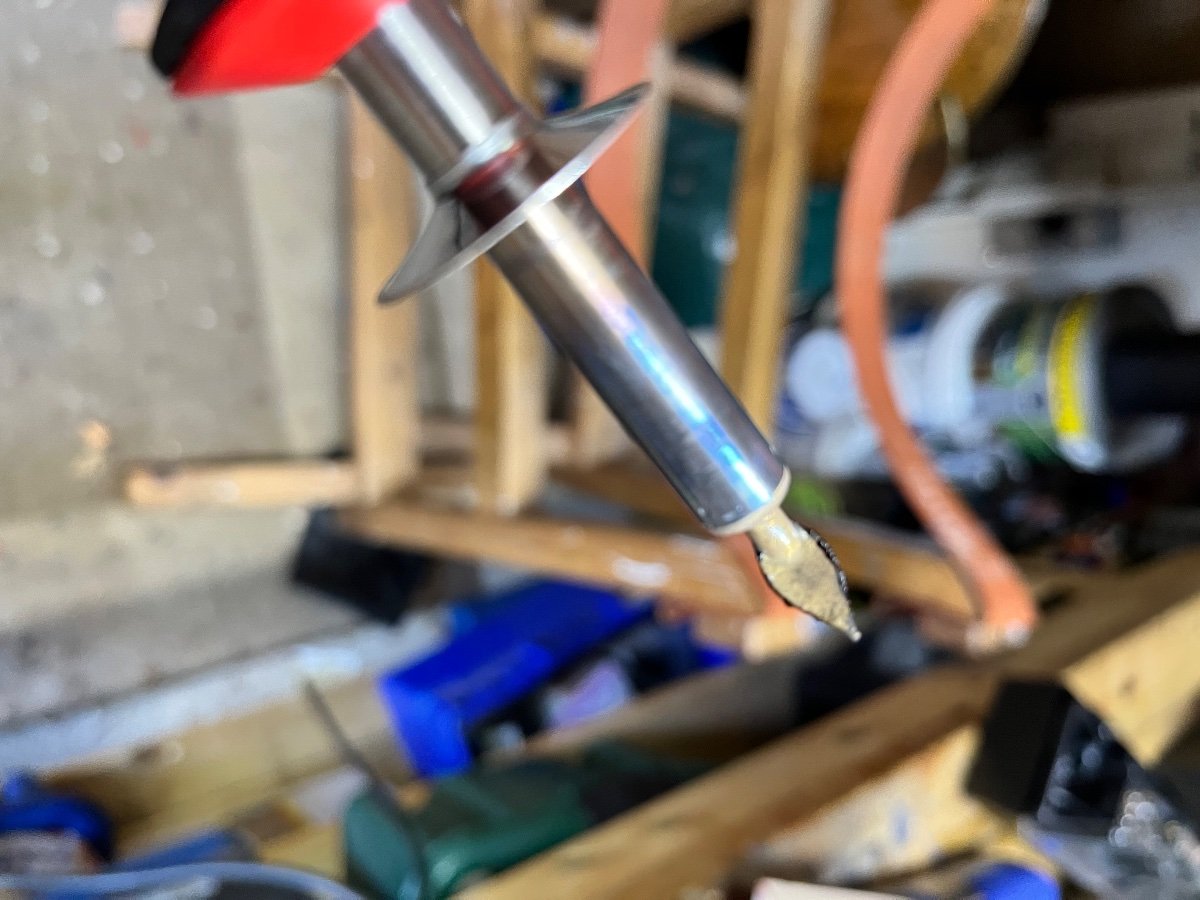

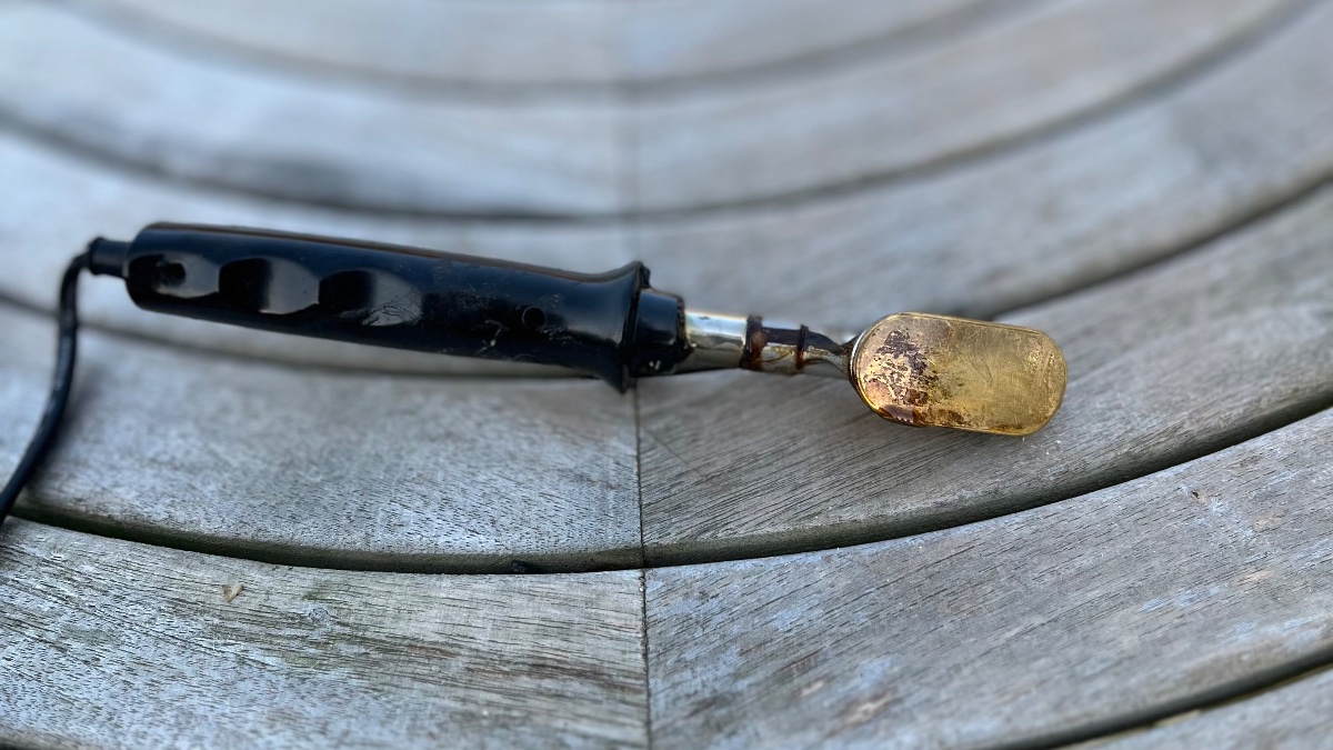

So I thought I would go down both routes. Firstly, using a syringe usually used to administer childs medicine, I applied a fine 2mm bead of highly flexible and waterproof roofing shingle adhesive along the gore cuts which were visible. this was pushed into the gap to fill and bridge it. It is a material which both stretches but also compresses. Using a flat blade fitted to my solering iron I found that I could soften the original gum, manipulate it and smooth it back into place. I tidied up the stems and then eased the traditional gum back into place over a gores and the bead which was now dry. I have only done one so far as wished to experiment with the process.
This is the flat blade on the soldering iron

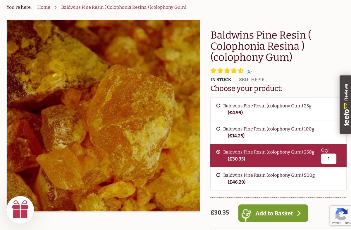

Below is the pine resin which I have ordered.

The resin arrived.

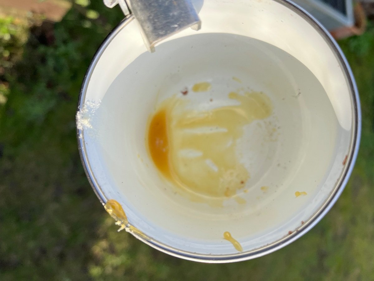

I ordered 250g (9oz) which cost me £30. Henri asked me to het a sample up so that he could see what colour it would turn out, I heated it in a white tin mug so that the colour would be accurate. It went a nice mellow toffee colour and when it cooled I chiselled it out of the mug.

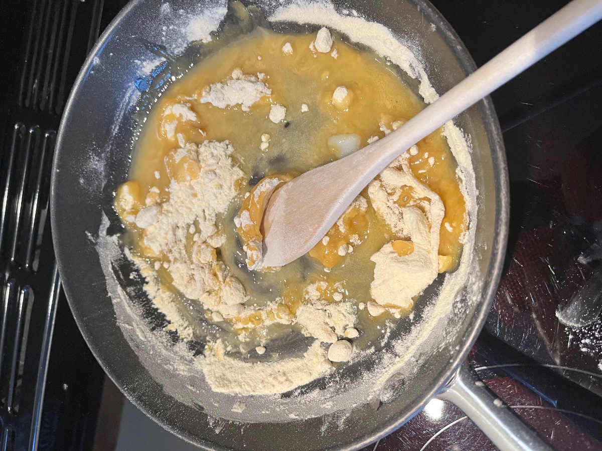

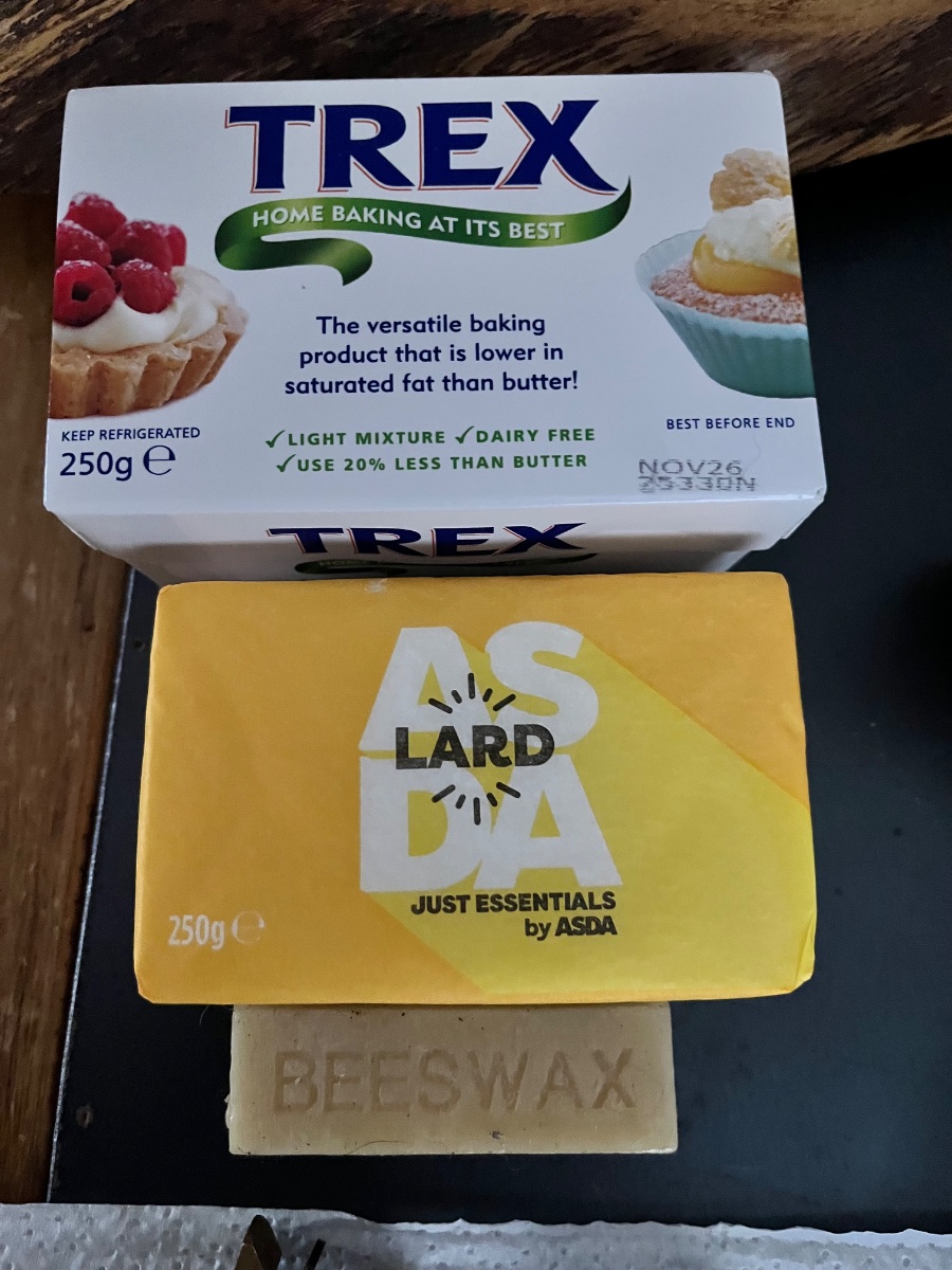

IT"S NOT ROCKET SCIENCE! : Now that the resin had arrived I had an hour long chat with Henri about how to mix the gum and what ingredients were needed along with the method. Mixed with the resin could be either vegetable shortening (Trex) or rendered pork fat (lard) Some I know have used bees wax. So I had all three but went for the lard.

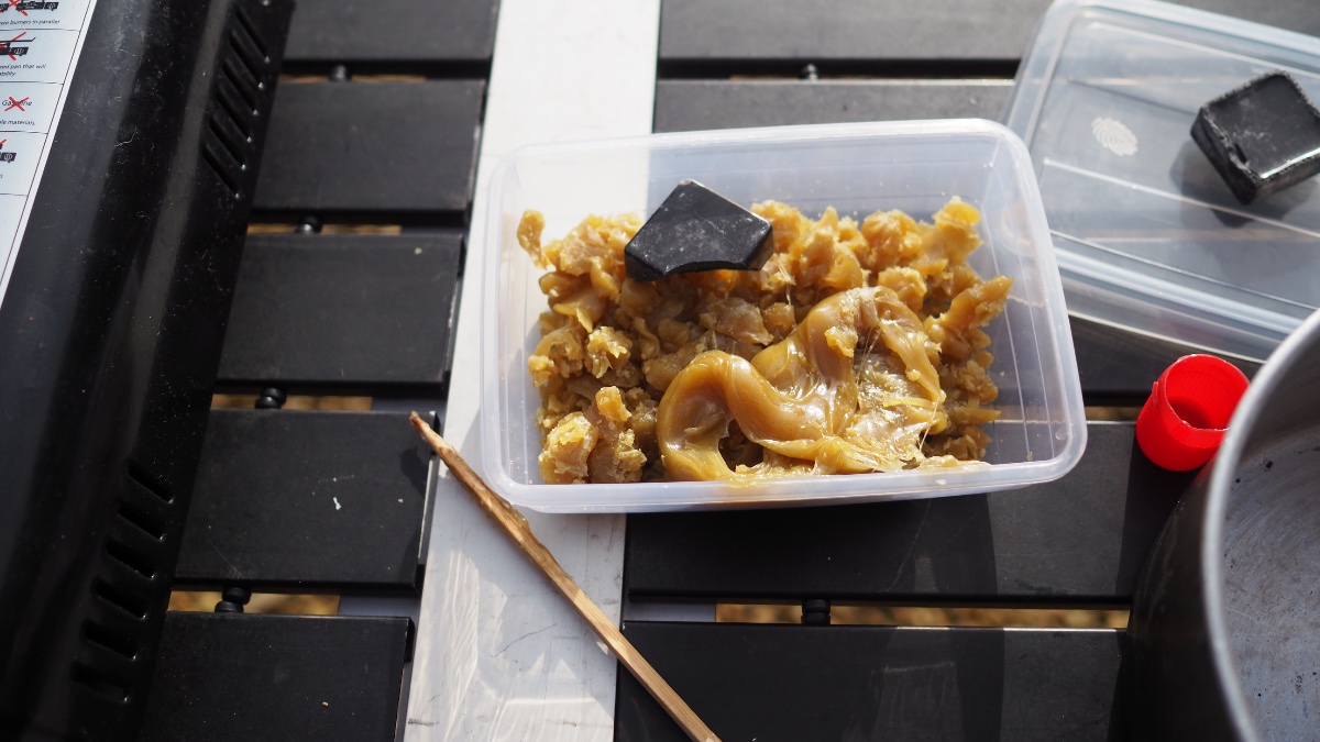

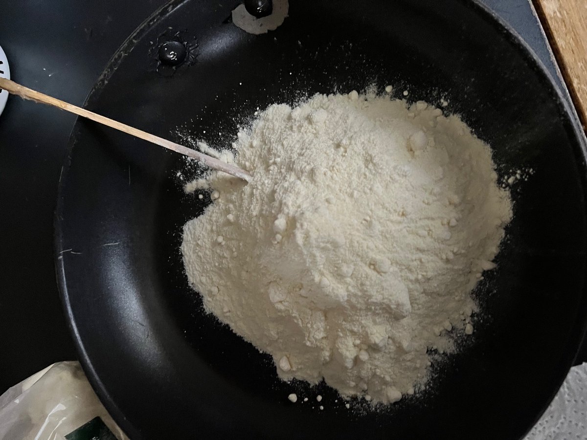

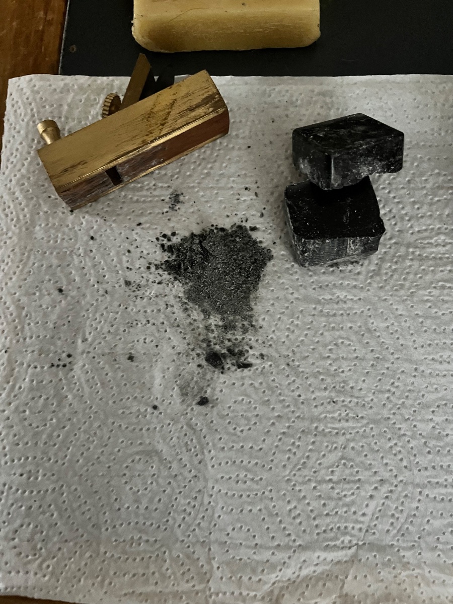

I measured out half of the resin and put in in an old pan (this is important if you wish to save your marriage). Then I slowly heated it on a warm stove constantly stirring. I had already shaved down some pitch pine resin from some blocks as I would add this to give me a darker brown colour.
Here's the powder in the pan

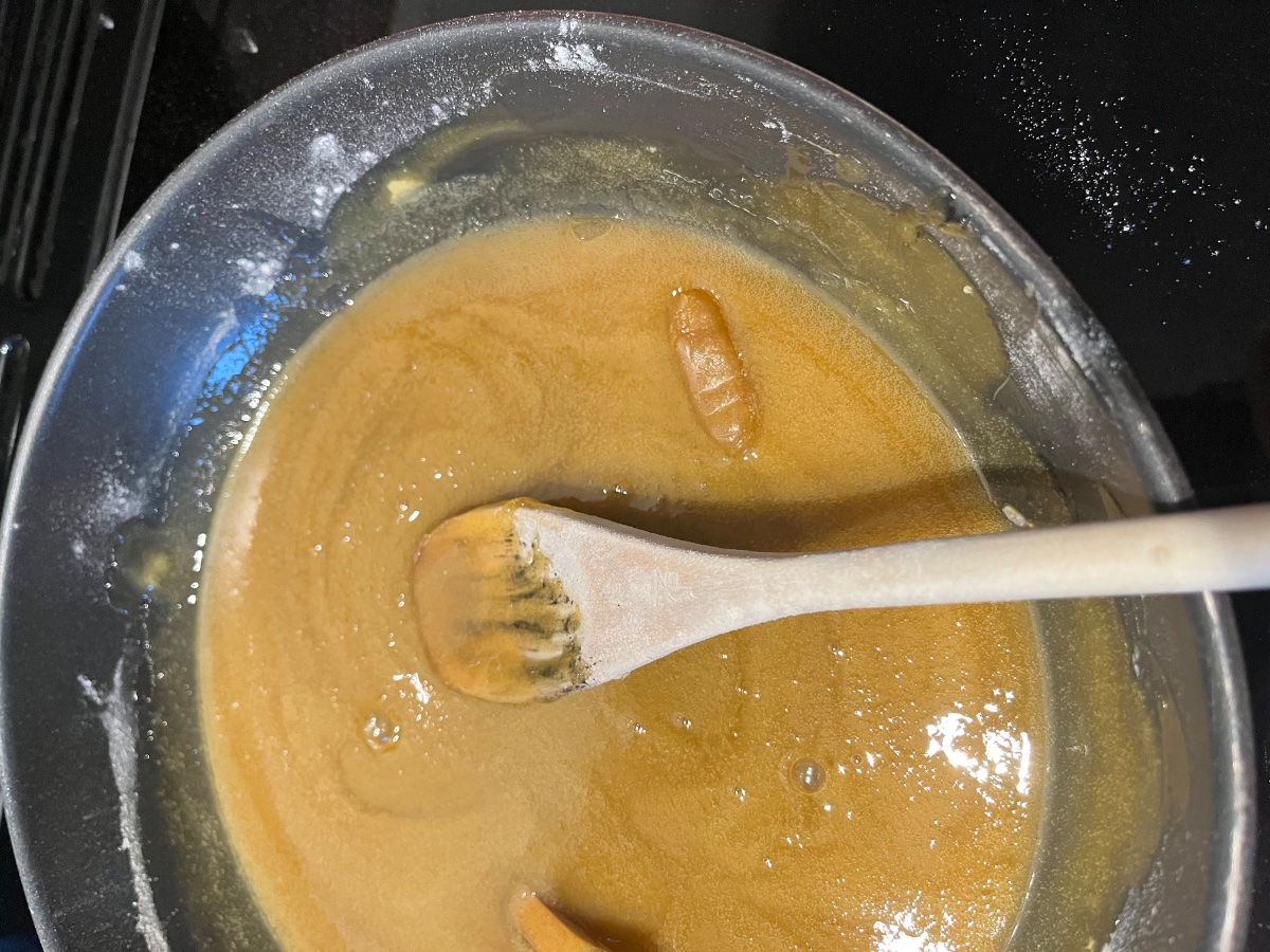

Slowly it starts to melt like caramel
Until you get this..

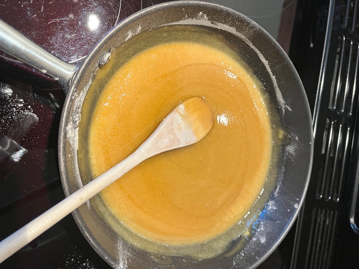

I cut the lard up into small blocks first adding 12.5g to 125g of resin. I stirred it through and then took a bit of the mixture on a spoon and dropped it into cold water. It set but was still quite brittle. So I put the sample piece back in the pan, remelted it and added another 12.5 g of fat. Mixed through and repeated the exercise. This time the gum when tempered satyed quite pliable. I then added 5g more resin powder and tried again. This time the gum set to the state that it would just take a fingernail. Working on the basis that the kitchen is 21 degrees C I was happy with that. It will harden better on the canoe outside. If its still too soft or too hard I will simply add more resin or more lard.
I gave it a blast of heat and poured it into a tin mug ready for use. 250g of resin will give me about a mug full of gum but Henri and I don't think that my canoe will need that much.
The tempering bowl

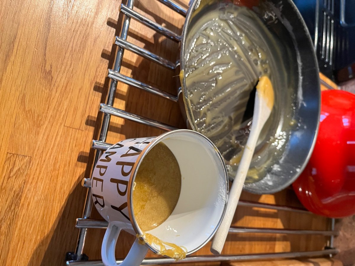

The finished gum all coloured and the reason why you don't use the best pan! Angelika is out so I will hide the evidence in the garage but there's no quick way of getting rid of the smell in the kitchen!
So I ended up using 130g of resin, 25g of pork fat lard and a bit of ground pitch pine gum to colour. I will make another batch of a lighter shade as Henri used some on the bark to fill minor imperfections and these areas are far lighter in colour than the gores and stem areas. When the weather warms up I can go and remelt what I have made, apply and smoothe it. If it's too cold Henri says that it will set too quickly and you end up doing only an inch or so at a time. Cold and temperatures are all relative; what's cold in the UK may be a barmy temperature in Greenville New Hampshire!

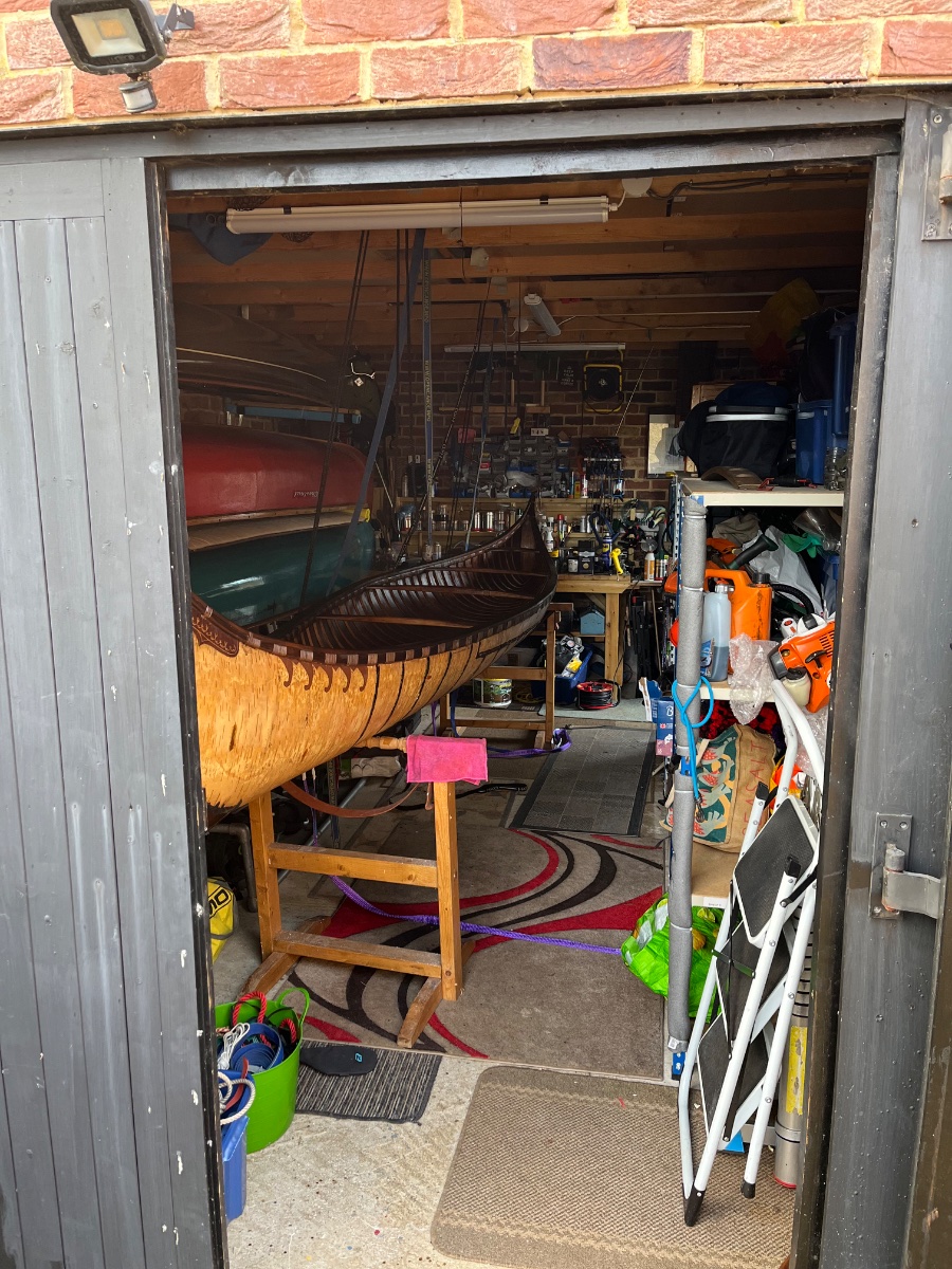

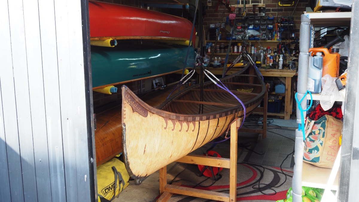

The big golden thing in the sky arrived in the UK today so that gave an opportunity to get on with the birchbark as the temperature reached a barmy 17 C ( 62F in old money) which would make it easier to apply the gum which I had made up previously. I was going to hit the gores and the stems today.
Firstly I dropped the canoe down from the rafters and got all the gear ready on a table outside just in case of a flare up! I used Angelikas best non stick pan , a wooden spoon and heated it up on a camping stove.

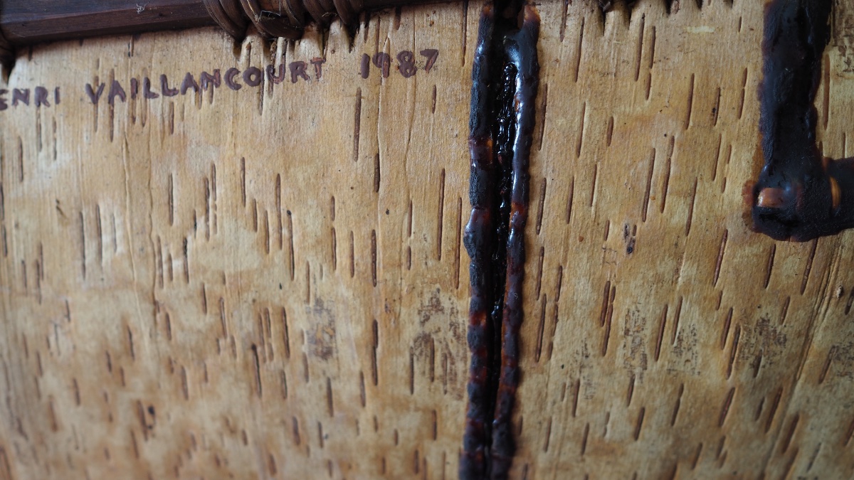

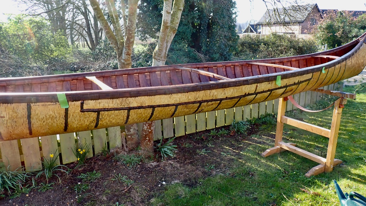

This is what the gores looked like before I started.
This is an area on the bark where the reserved, light gum will be added.

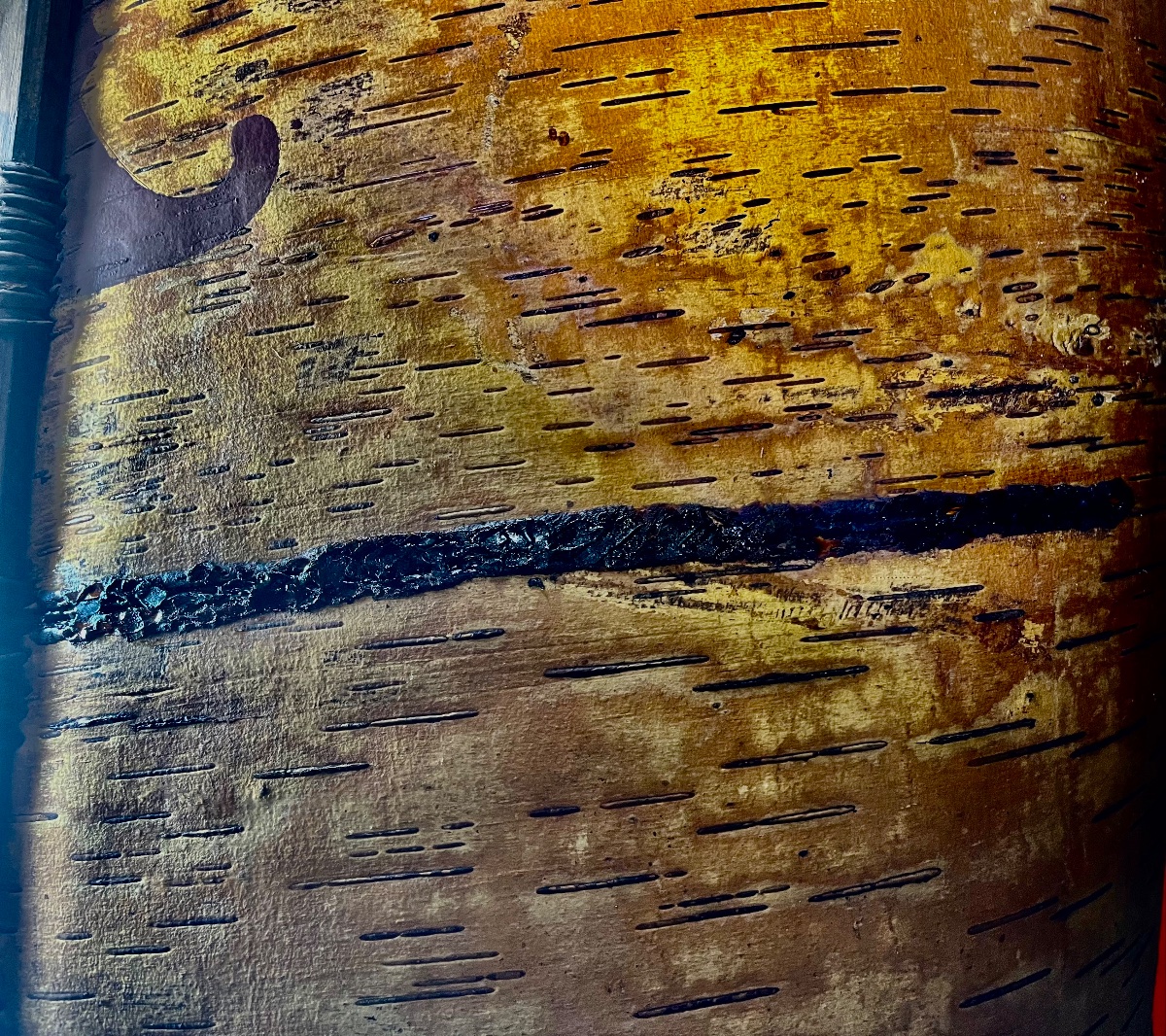

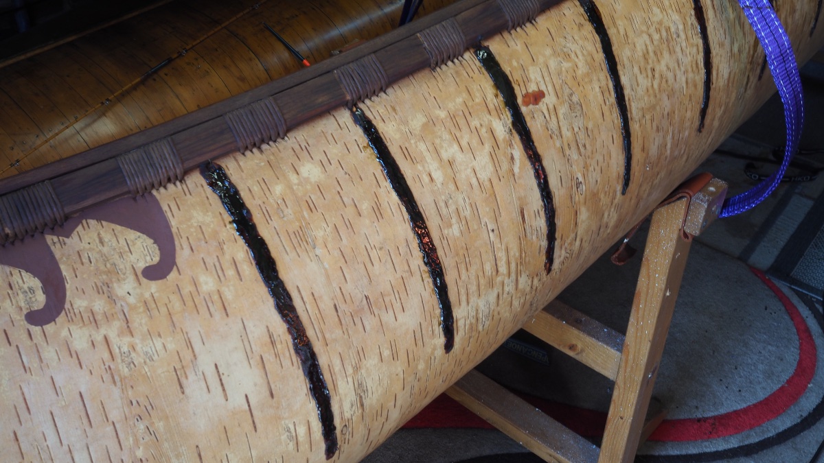

I heated the gum up and got it nice and runny before taking it off the heat and letting it cool until it would run off the spoon like treacle and starting at the top of each gore I ran it into the joint. Of course at one point I splashed myself and it's remarkable how quickly hot gum can remove skin and flesh! There is also a delayed reaction between eye and brain when you are watching your flesh sizzle and do nothing about it...ho hum.
Henri had suggested spitting on my thumb and rubbing the gum into the gores; I opted not to burn myself further so used a leather iron. I heated this up and then took the power off and let it cool slightly before applying it to the new and old gum which melted nicely into each other and with some pressure, a smooth finish was achieved.
Uing the iron has at least enabled me to maintain my thumb and finger prints which I suspect many birchbark canoe builders now lack.
Here are the smoothed and finished gores

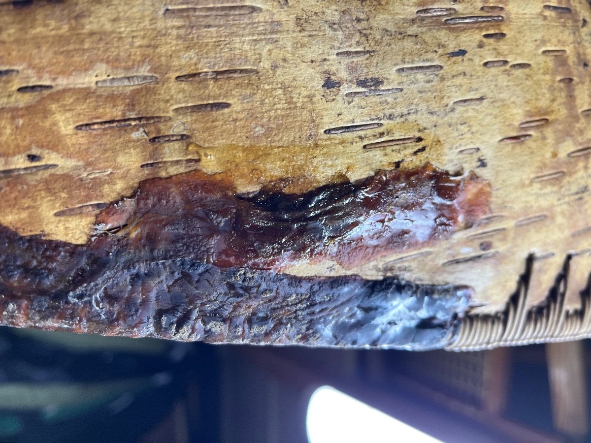

I then moved onto the stems. The front was generally good so I just smoothed that with some heat whilst at the stern I dribbled some gum down, mixed it with the original and got a good coverage over the cloth which Henri had used.
So after a couple of hours the gores and stems were done. I then went over and melted and spread some of the lighter bark patches; I will add some more light coloured gum to those and the areas over the next day or so as the temperature is predicted to stay at similar levels.

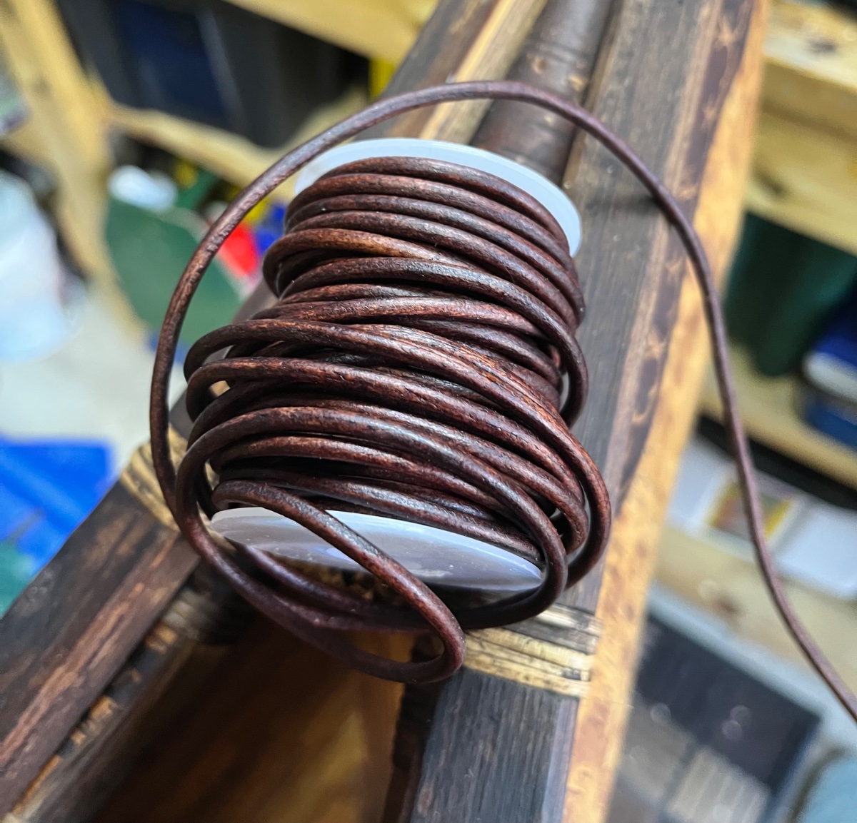

Once I have finished the gum I will replace the missing root bindings at the prows. I am not happy with the cane I tried so am going down the road of using some leather cord which I found and which should look good and do the job.
This is the leather cord which I found.

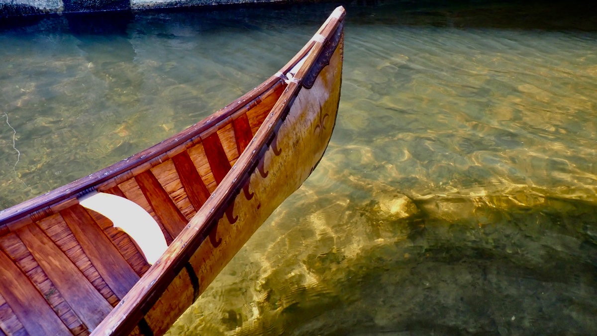

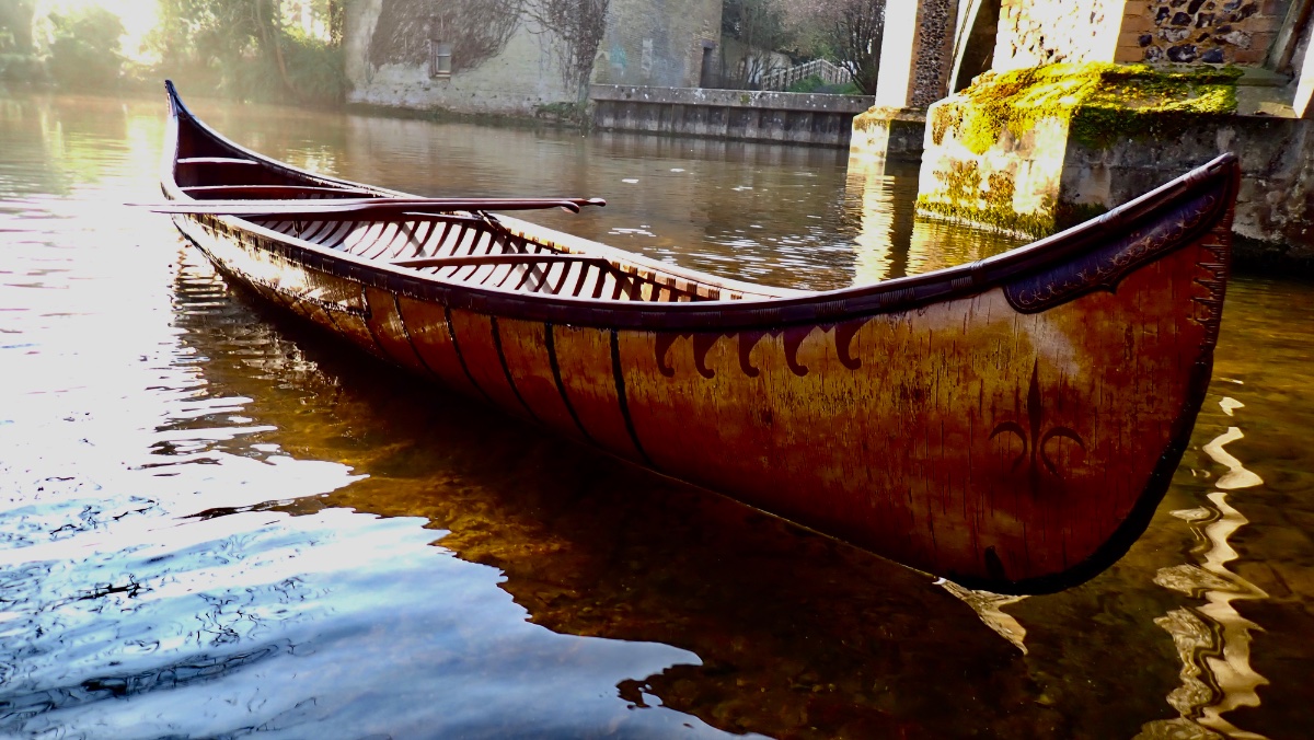

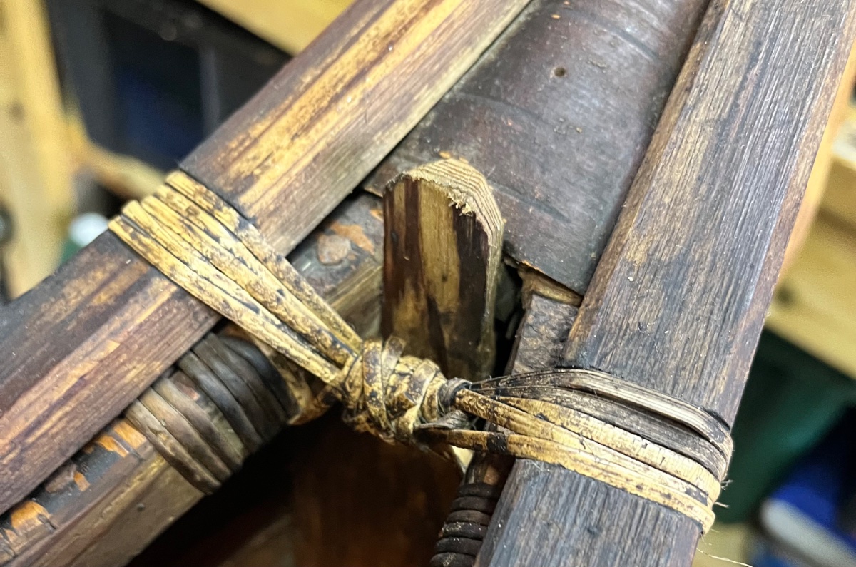

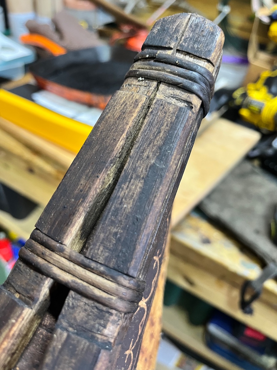

I finally got around to finishing the lashings at the bow wherethe gunwales meet. I umm’d and ahh’d, ahh’d and umm’d, put the cord away and used some split weaving material which I had. I am pleased with the result after I stained it to match the original.
Just a couple more bits of gum to apply on the bark skin and then a final wipe over with some Danish oil and I think we are ready to go paddling just as the rivers are dropping and the temperature rises.
WOW, Nick........the weaving imperfect as it should be and the color of it just right......beautiful .

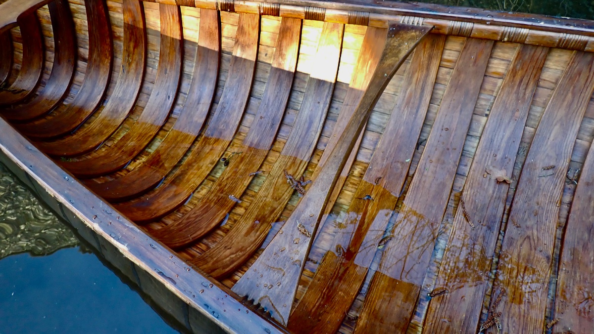

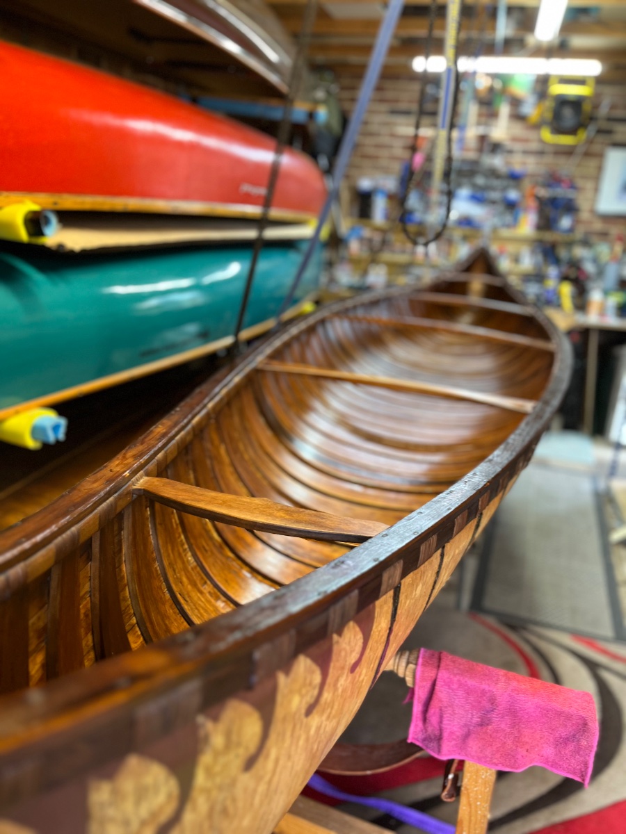

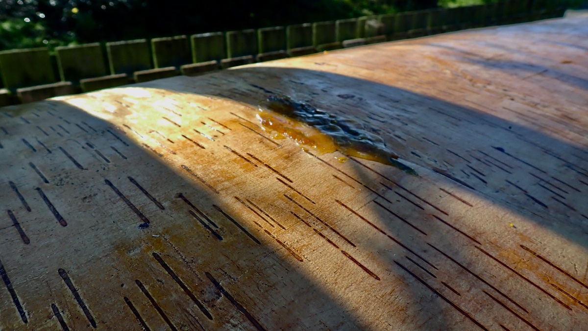

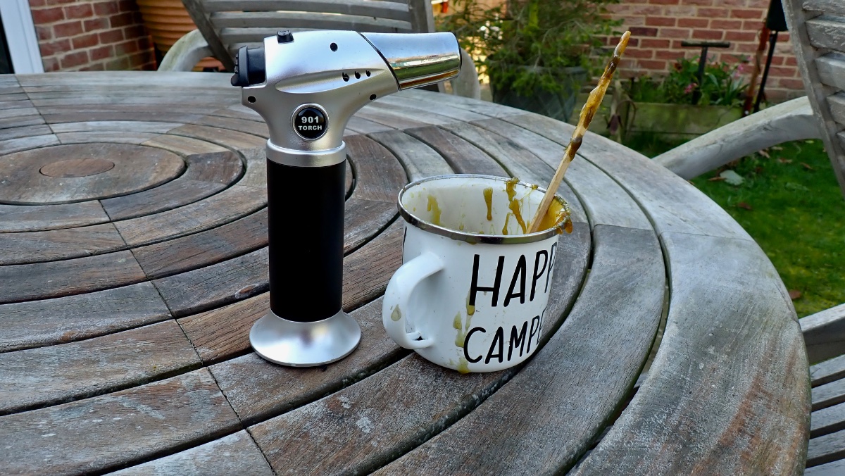

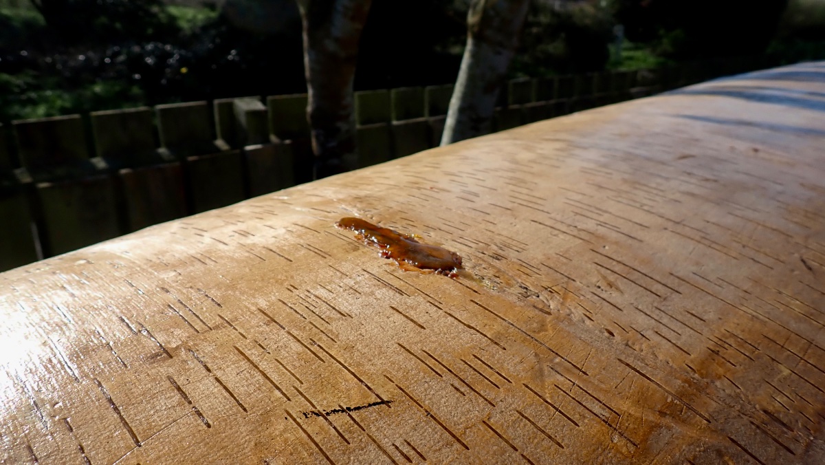

I completed the final small areas of bark gum; I simply heated up a small amount of resin in a tin mug using a chefs blow torch, risked burning my thumb by rubbing it in but spit helped. I stuck down a couple of bindings tag ends and then rubbed some oil into the bark, gunwales, ribs and visible planking. It has added life back to the wood which had dried, dulled and gone quite lifeless after 15 years in a dark, dusty barn.
I have now left it in the garage with the front and rear doors open so that there is a through draught of relatively warm but dry air which will help the excess oil evaporate and the rest dry nicely. The weather is looking good for the end of the week so I may get paddling. In the meantime I shall sit in the garden and watch the fighter jets and tankers from USAF Lakenheath & Mildenhall leave their vapour trails through the sky. NoI wonder where they are going ?

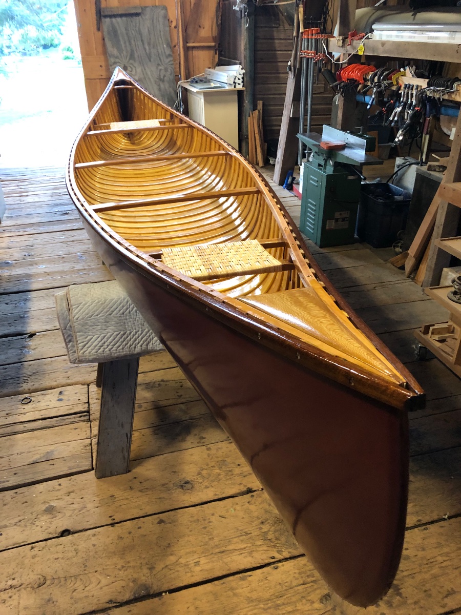

That canoe looks great! I'll bet you get lots of comments when she's on the water.

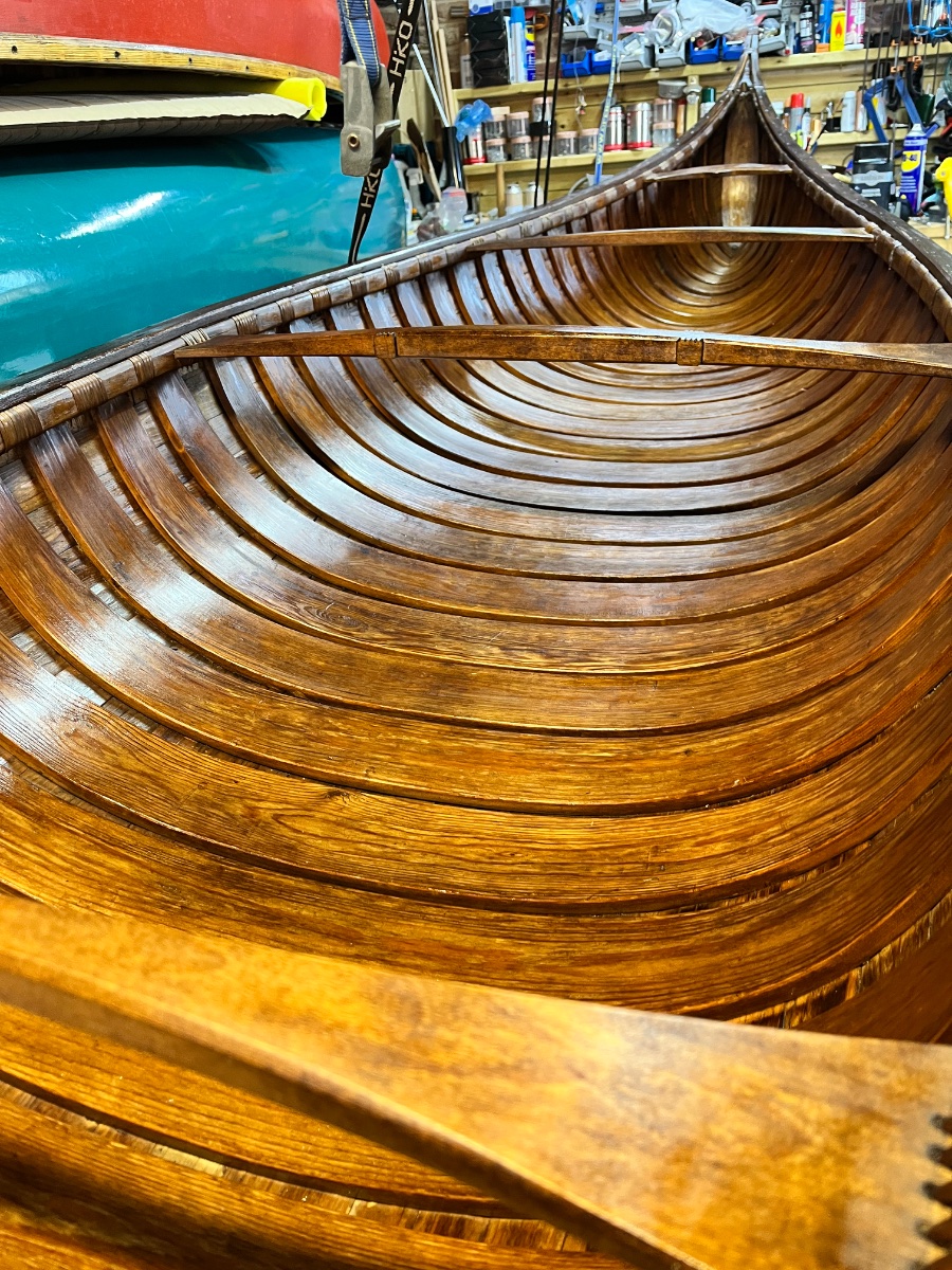

I love the shape of those thwarts with the reduced thickness at the gunwales achieving a 'crowned' effect. My 15' Island Falls Willow has similarly shaped quarter thwarts, though still not as delicate and shapely.
Pat , the wales appear to have been stained . I am not critical rather, I think , looking for some company of those who favor the early furniture look.
I have used the P&L Tonetic Classic Rich Mahogany . I think the Willow is just a beautiful boat.
Its just around the corner for open water.
Dave
Dave, you're referring to the outwales on my canoe, right? All I have ever done with these is varnish. If they were stained it was prior to my ownership.

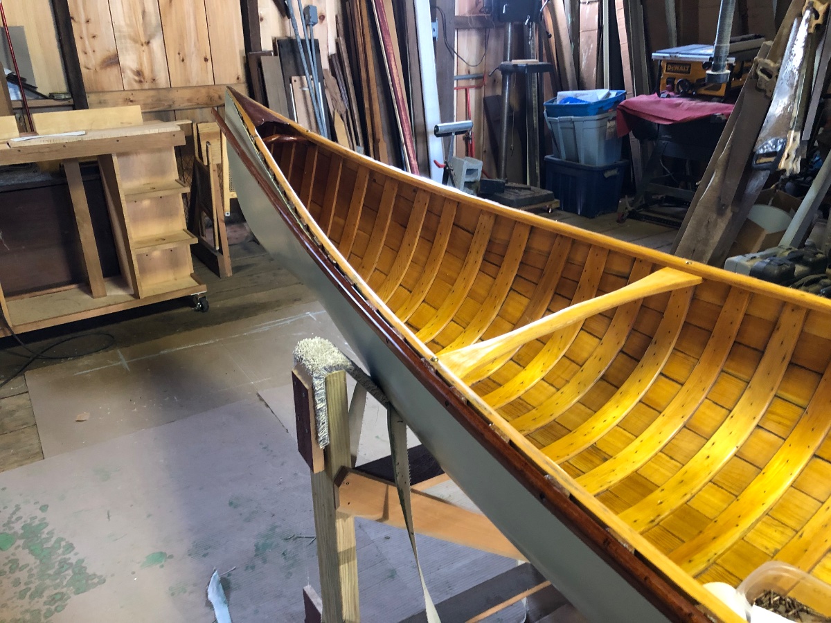

On my Atkinson Traveler build I used potassium dichromate and then aniline dye in red mahogany to color the outwales which turned out well, seen below.
