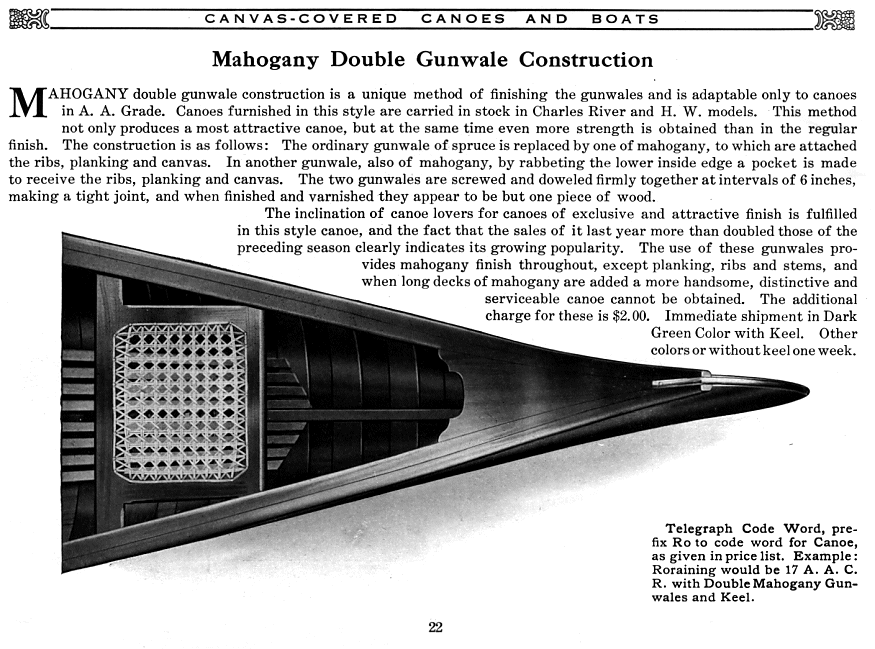

The three Old Town canoes in my garage from 1907, 1931, and 1936 all have hand caned bow seats that are nearly identical so your fifty pound model may have been similar. Each was made from one and three quarter by seven eighths inch stock and the bow seat has an outside dimension of fifteen by ten inches. The inside dimensions are eleven and a half by six and a half inches. There are fifteen by eight holes spaced three quarters of an inch on center and three eights of an inch back from the inside edge with no holes on the corners as shown below.
You may also find the thread at http://forums.wcha.org/showthread.php?t=61 and the image at http://forums.wcha.org/attachment.php?attachmentid=36&d=1100548356 helpful.
