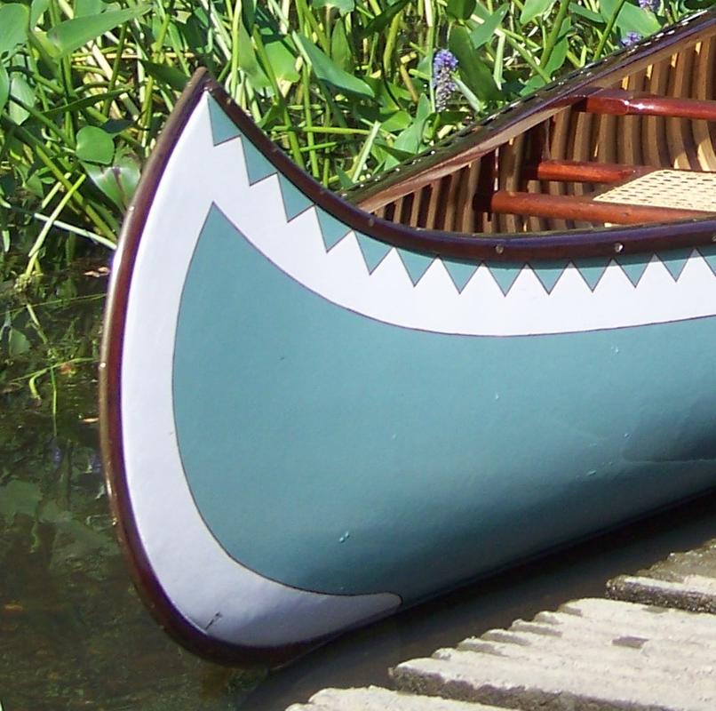

Outside stems are wooden stems outside the canvas, but inside the brass bang strip, usually varnished, as on my fully restored 1922 OT Ideal (click on the photos):

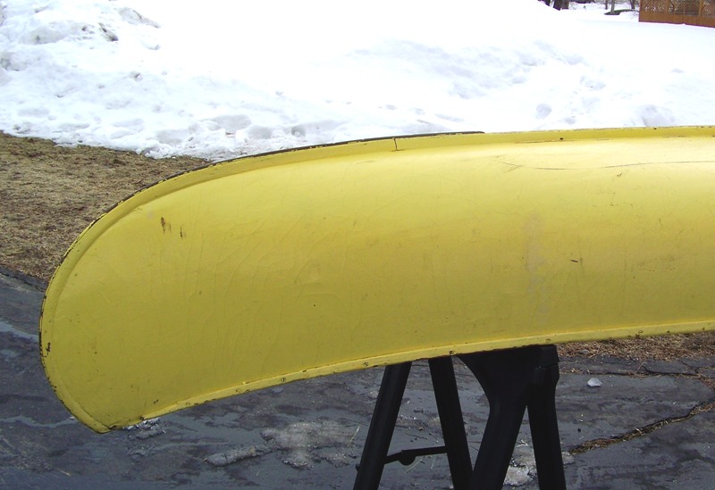

but sometimes painted, as on my 1931 OT 50 pounder when I bought it:
