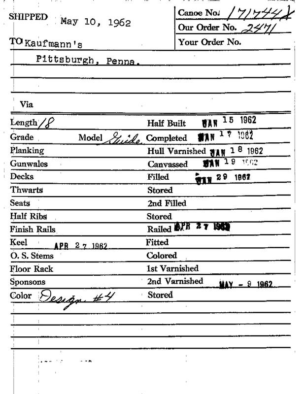

The Old Town canoe with serial number 171744 is an 18 foot long, Guide model. Neither the grade nor the woods are specified. This canoe was equipped with a keel. It was built in 1962, getting its second coat of varnish on May 9. 1962. The original exterior was painted with OT design number 4. It was shipped to Pittsburg, Pennsylvania on May 10, 1962. A scan of this build record can be found by following the link behind the thumbnail image attached below.

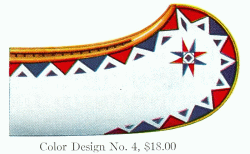

Design number 4:
Design number 4:

By the way, does you canoe still have the design number 4?
