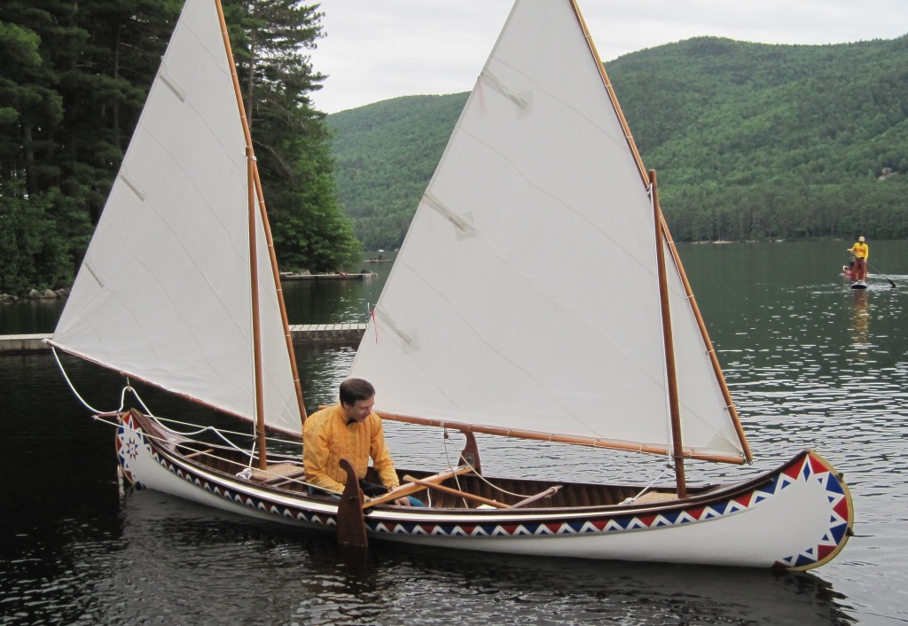

Yes, Old Town offered them in the 1920s. More information about these is available at http://forums.wcha.org/showthread.php?3994 and the picture at http://forums.wcha.org/attachment.php?attachmentid=22923&d=1347065452 shows one in the wind at the Assembly last year. A fiberglass variation as shown at http://wcha.org/pp-classifieds/showproduct.php?product=222&cat=16 was called the Wahoo. These are very successful on the water but very few were made so they were not overly successful in the market.

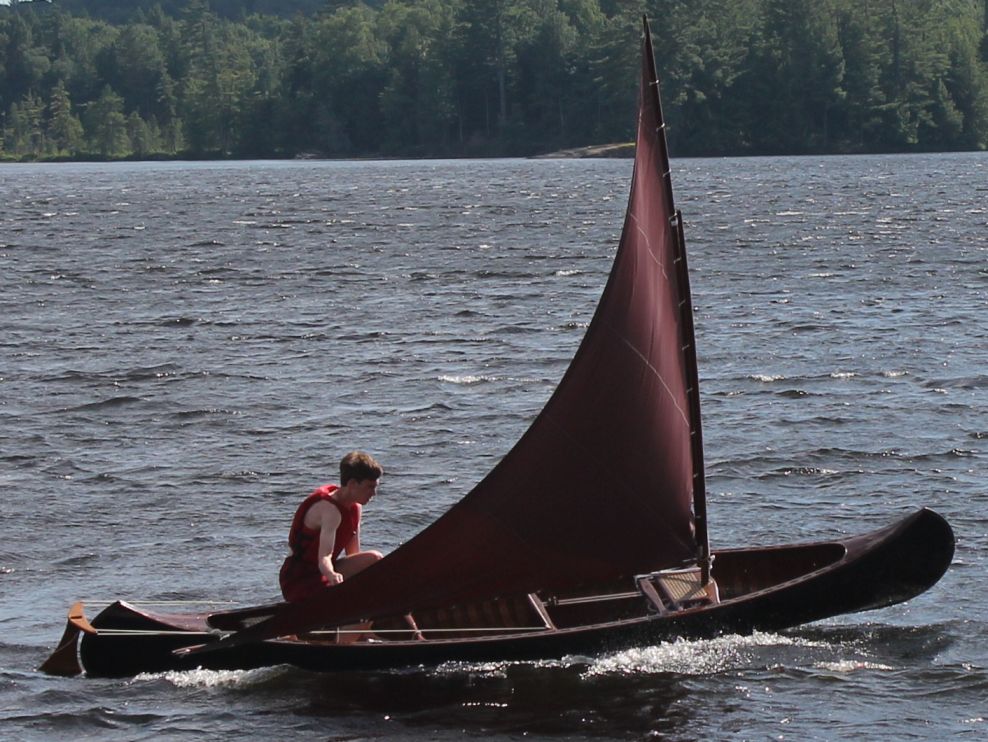

I have found that a large rubber gasket between the leeboard and the bracket helps to reduce this problem. The pictures at http://1.bp.blogspot.com/-FEu81SK3u...AAFlM/KbA8AqkFAqM/s1600/IMG_0729CmprsCrop.jpg and below show them if you look closely. Adding a centerboard to a canoe is not a simple change so let us know how it goes. Thanks,
