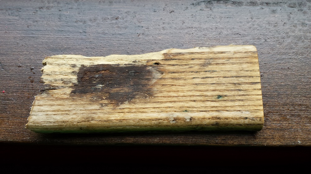

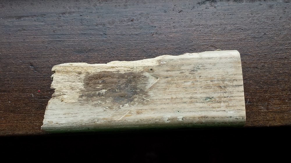

Hi,
need to replace some Ribs and cut this piece out.
Anyone idea what kind of wood that is ?
Its bleached, one is dry one is wet.
thanks

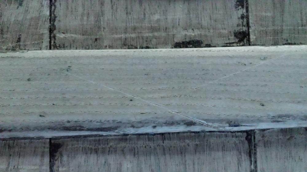

Hey Guys,
I still cannot really tell. Is it Ash or white oak ?
Here are more pictures maybe that helps.
I need to replace 5 ribs.. they are 1 3/4 x 1/4 x 50. Any clue who has ribs ?
thanks

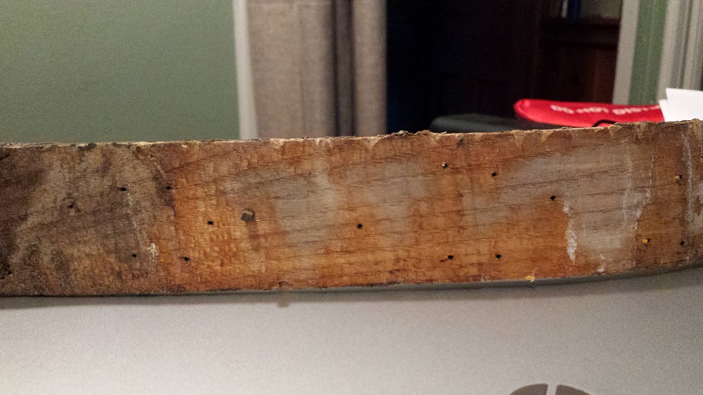

Here is a maybe even better picture ....back side of a rib.
thanks

How about a smell test. I know, sounds odd, but I was cutting new ash gunwales years ago and a customer was wondering what I was smoking in the shop. Ash has a distinctive odor if you get my drift. Find a new piece of oak and ash and then cut or sand and smell them. Maybe that might help determine what you have.

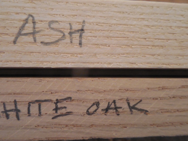

Many thanks. I could not smell anything, probably its too old... 100 Years :-)
However, I got some sample pieces of Ash and White oak and compared them.
It is really Ash, fits way better with the grain of the wood and the color as well.
