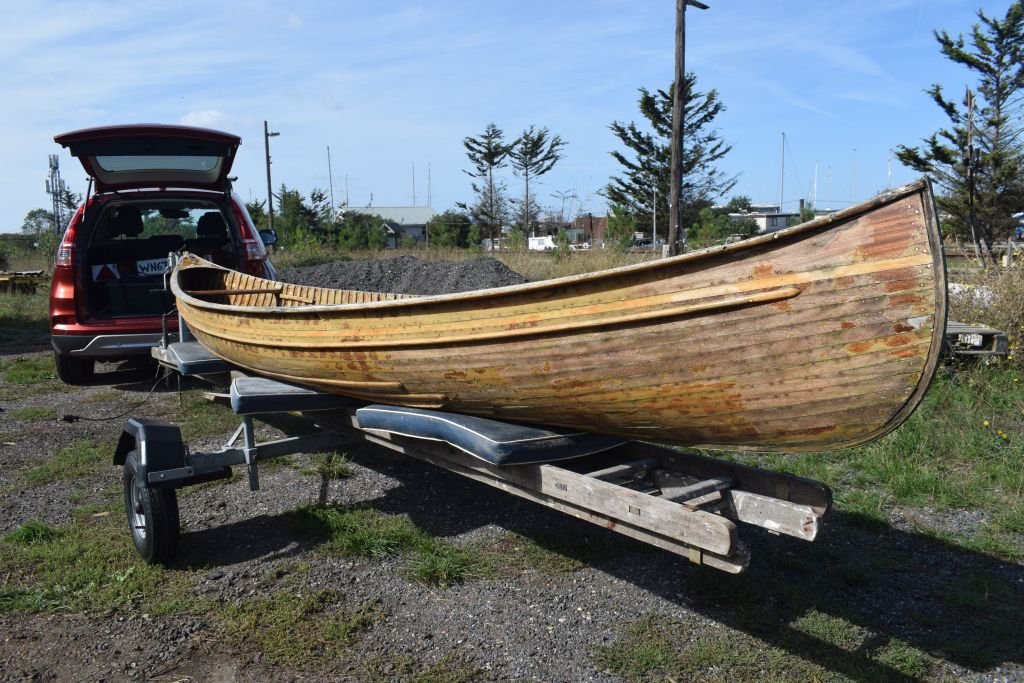

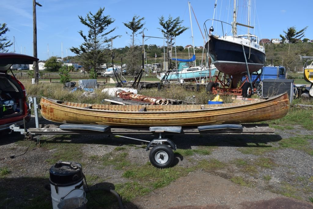

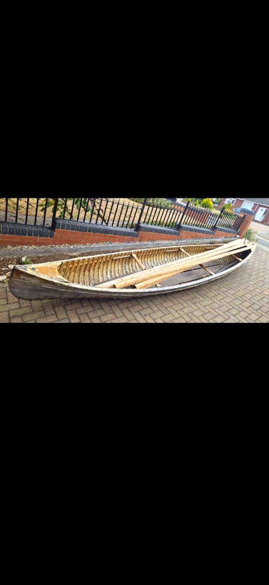

Thanks for having me aboard. First post from Essex UK, I saw this canoe on fb marketplace last week, then it popped up on ebay.... And so shortly after i find i have won it for not a lot. Picked her up today & pleasantly surprised as its better than it looked in the photos.
She is approx 16' 6" overall & 16' 2" at top of stems. Beam 35" with tapered outwales exttending 1 3/8" beyond the hull planking. Depth inside midships 12".
The seller has had her two years just sitting outside uncovered, He did not know where she camr from save that the previous owner had bought her in excellent condition & owned her for some years. Planking is Mahogany with a narrow white timber plank below the sheerstrake.

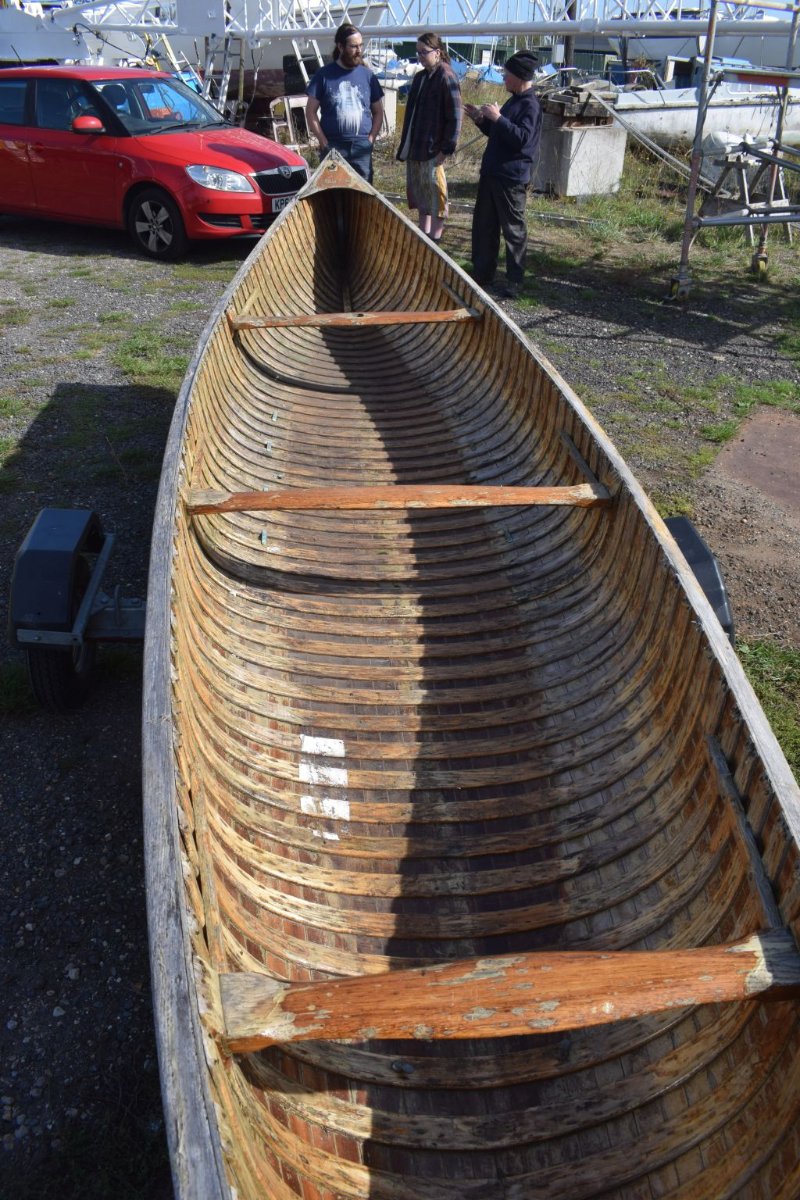

Ribs are either White Oak or could be Ash, not sure. No id marks or signs of Decals that i can see, Hull is fastened with copper tacks As are the outwales.

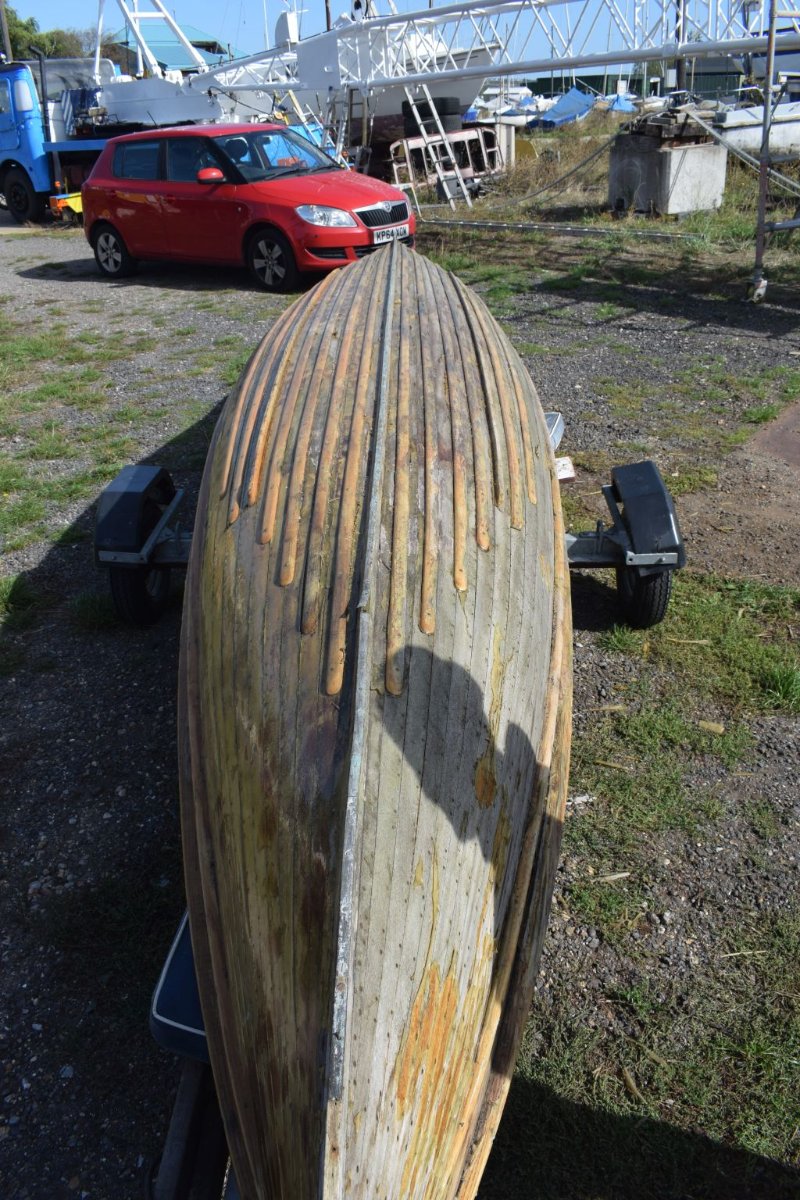

She has a vestigal full length keel with 4 rubbing strips each side then a slightly deeper bilge runner then two more rubbing strips above that. Hull has another rubbing strip just below the contrasting plank.
To my eye she doesnt look to be that old, Im guessing 70's or 80's? but i could be wrong. Stems are rotten at the top & will have to be replaced as will several other bits. Only 4 broken ribs so far though i expect more will be suspect. My son & his girlfriend arrived & vacuumed her out after a scrub out & she looked a whole lot better.
Any ideas as to what she is & who built her? I will not be covering her in epoxy!

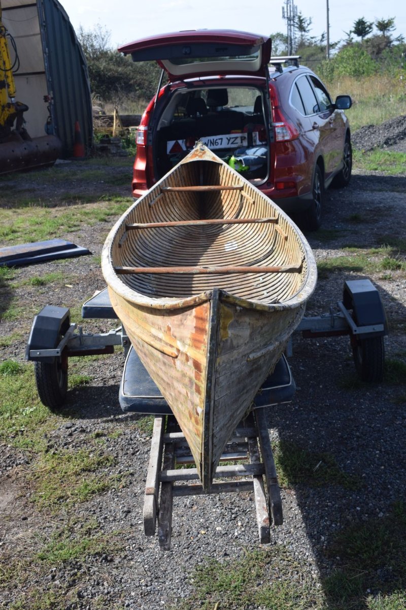

Yes you are right it is twisted. This is what happens when someone fills a boat with fence posts, last photo shows this.
She is now indoors & the first job for me is to pull her straight before she really dries out.

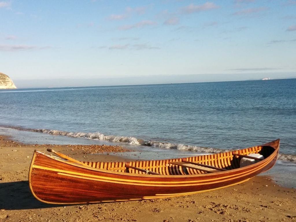

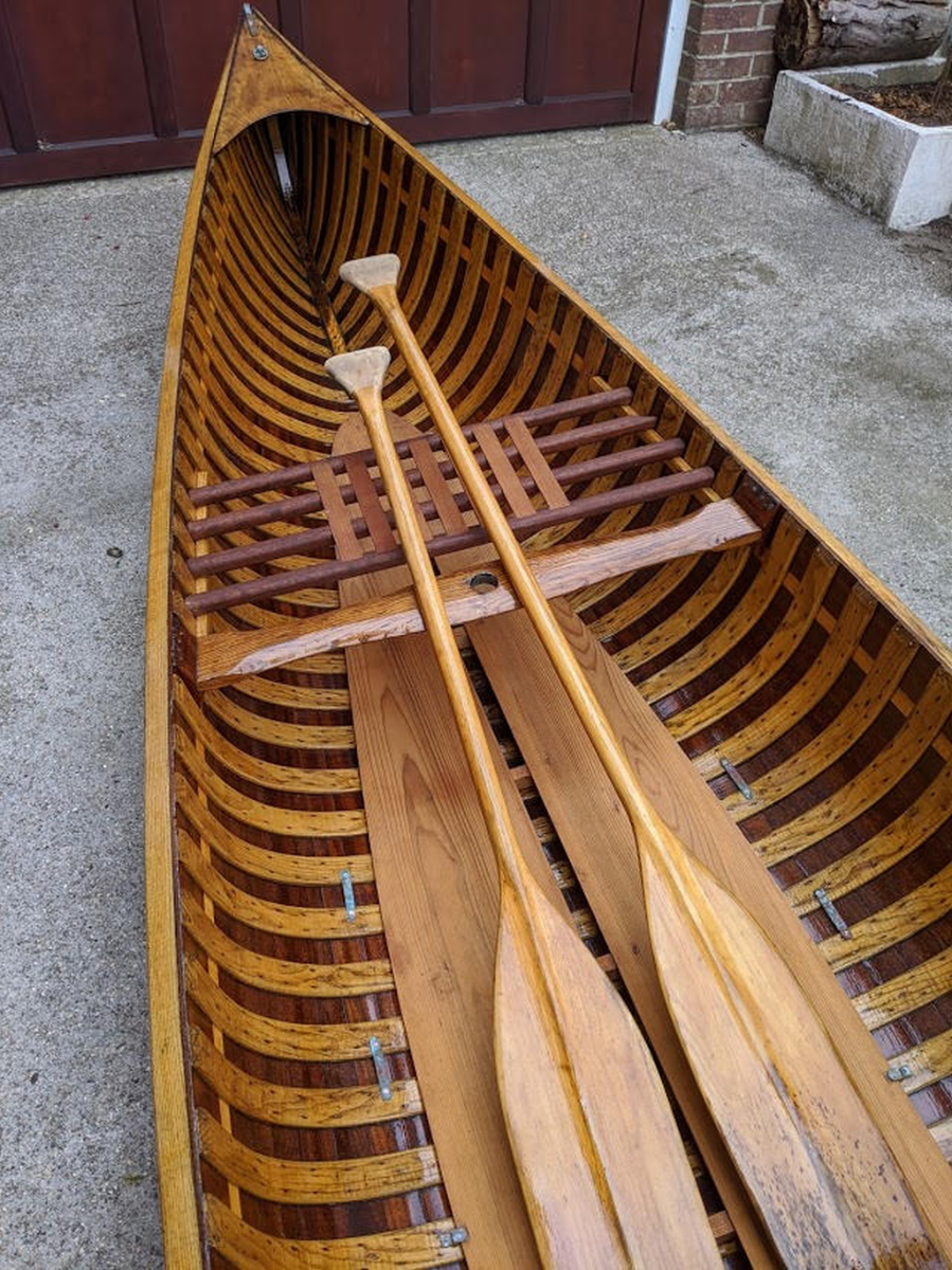

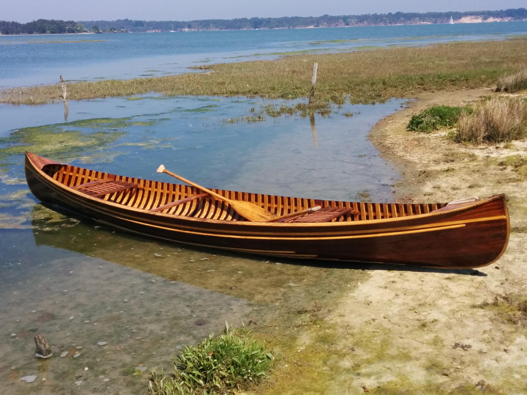

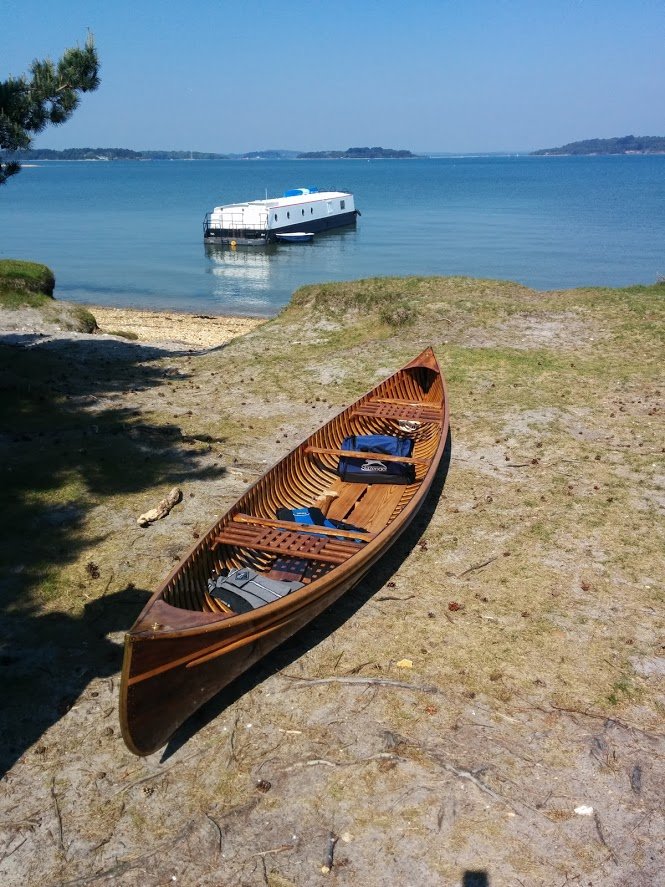

The suggestion to her being French looks pretty certain, I have just found an old listing online from wooden ships a yacht broker in the UK who specialises in wooden boats. There is this very canoe, if it isnt i will eat my hat.
Listing states "Built in 1930 in France for an owner on the river Loire, refinished by present owner & sold by Wooden ships". This ties in with what the seller told me today he reckoned the guy who he got it from had paid a lot of money for her but she had fallen on hard times. Guy i got it from has owned her two years but had nowhere to do it. I can contact the broker tomorrow & see if he has any more records of the canoe & when he sold her. I am surprised she is that old to be honest.
Anyway now i know what she once looked like & what i have to do. Something to inspire me! Here are a few photos from the old listing.

Interesting boat, the builder hasnt used half round hardwood ribs, but wider flatter stock like cedar canvas construction. Rilco industries did that in Ontario, but while the boat was ship lapped red cedar, they were still covered with a canvas.

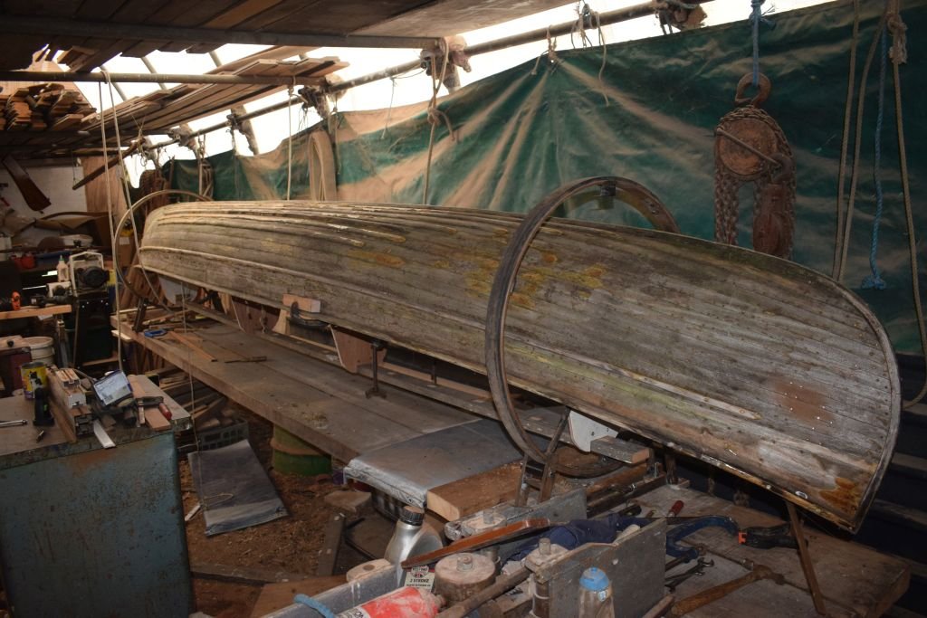

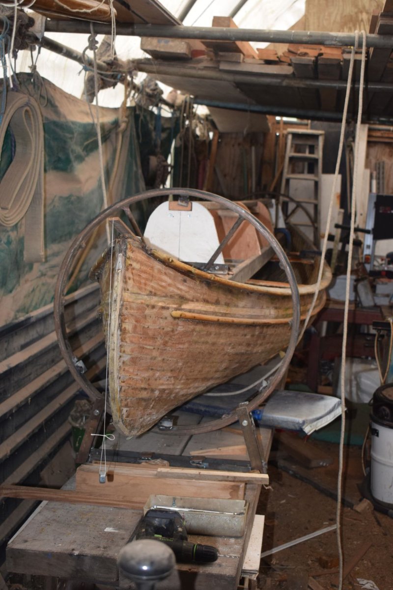

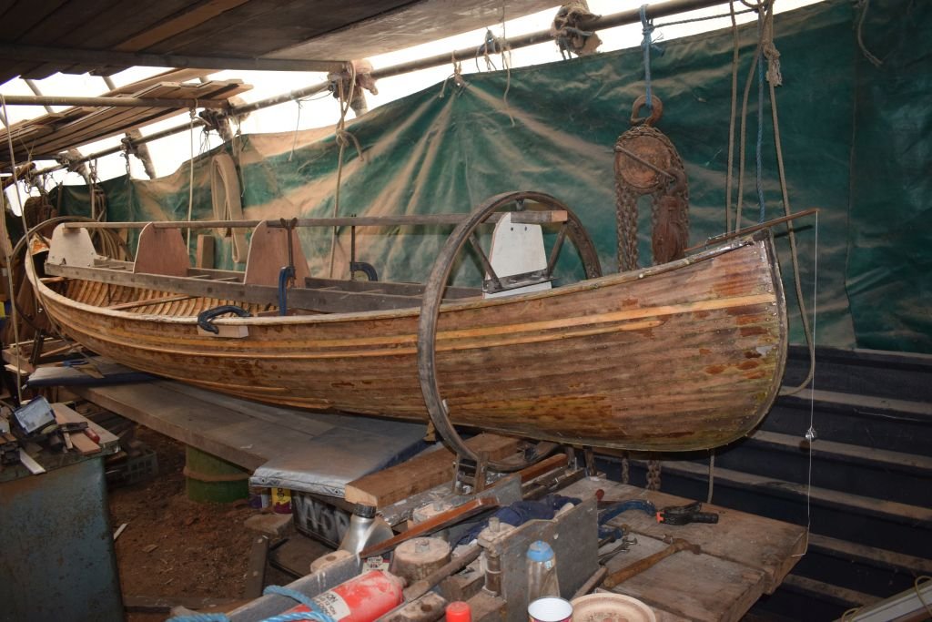

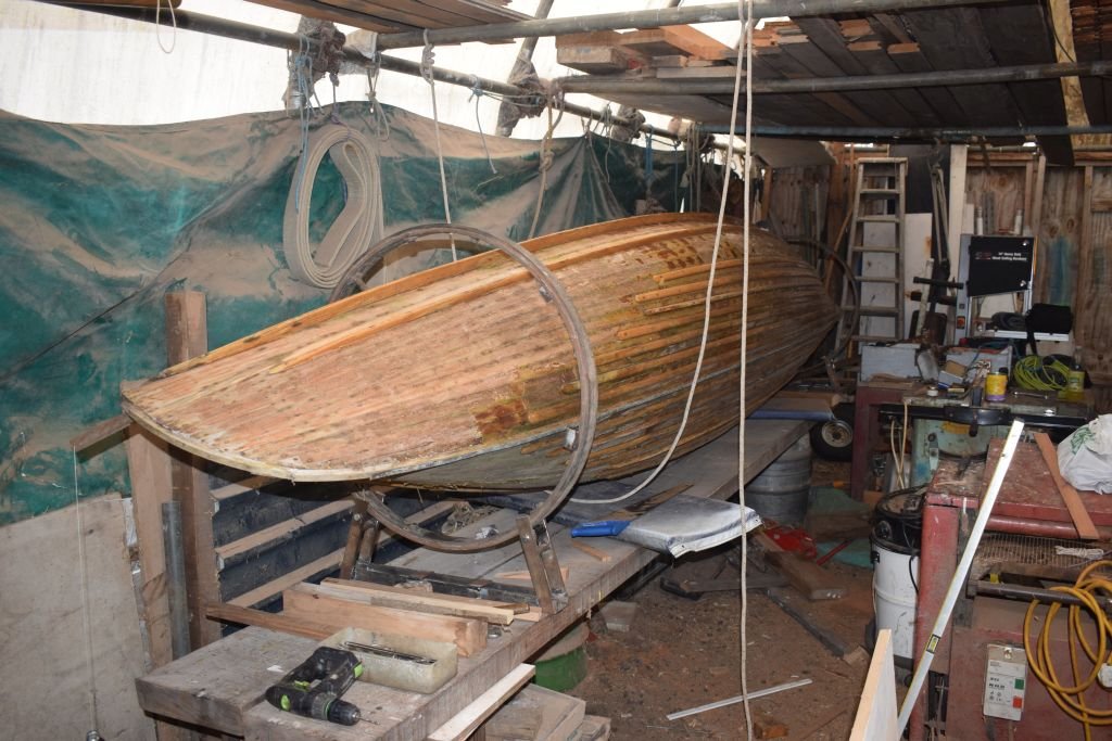

These Canoes are a deep rabbit hole to fall into! I spent this afternoon making a building frame / Jig to hold the canoe so it can be straightened out & worked on. The twist in her hull has reduced considerably just by sitting her carefully on my long bench.

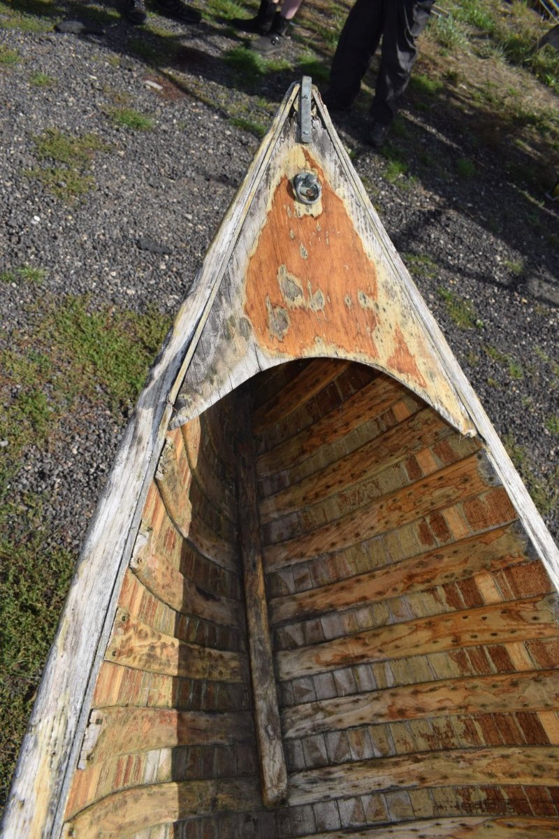

Another visitor today who is into paddling canoes, we were looking round the canoe looking at construction details. Both stems have rot in the top & the stern one is also broken at the waterline. She was built with an inner stem or apron as i would call it in normal boatbuilding, this is sawn from solid joined by a tenon in the middle.
The outer stem is steamed over the top of the aprom & planks & simply nailed on with steel nails, Breasthooks are fastened with steel screws right through the outwale & planking. The outwales will have to be replaced as they have rot in multiple places.
Most interesting from a boatbuilders point of view we noticed that the narrow white timber stripe just below the sheerstrake has no fastenings in it.
So we found that this is tongue & grooved to the adjacent planks, the builder relying on the fastenings above & below for this plank.
The hull rest of the hull planking is finely joined the same way & set tight with fine copper tacks clenched over on the inside.
Sheerstrake is 6mm thick but this reduces down to about 5mm further down. Im using metric cos she is French!
Planking is fine mahogany, the ribs & outwales are Ash, breasthooks & yokes Oak.
I will be searching for some good Ash, usually i wouldnt use it in boats due to its perceived lack of durability but if she has lasted this long it cant be that bad!
