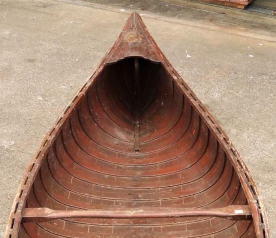

Happened to search the same auction website for canoe items and noted that another green canoe was sold in the summer of 2022 from the same estate. Seems like Eleanor Barnes was like many of us and had more than one canoe in her fleet. This one shares the exact dimensions as your canoe but is a darker green and made with open gunnels. Might be reasonable to assume it was made on the same form. Perhaps you could try and locate the new owner and see if there are any other markings to ID the maker.
Deck shape is slightly different on this one, as seen in the photo HERE, so perhaps that might offer a clue? To my eyes, there looks to be a circular spot on the deck where there might have been a decal or metal name plate as well.

The deck shape of the canoe sold earlier is reminiscent of a Peterborough deck as on my 16S as here
but my Old Town CR had a deck shaped similar
is that the ghost of a Chestnut decal on the deck?

My one is a Chestnut, the deck of the other appears to me to be Peterborough as Nick suggests.

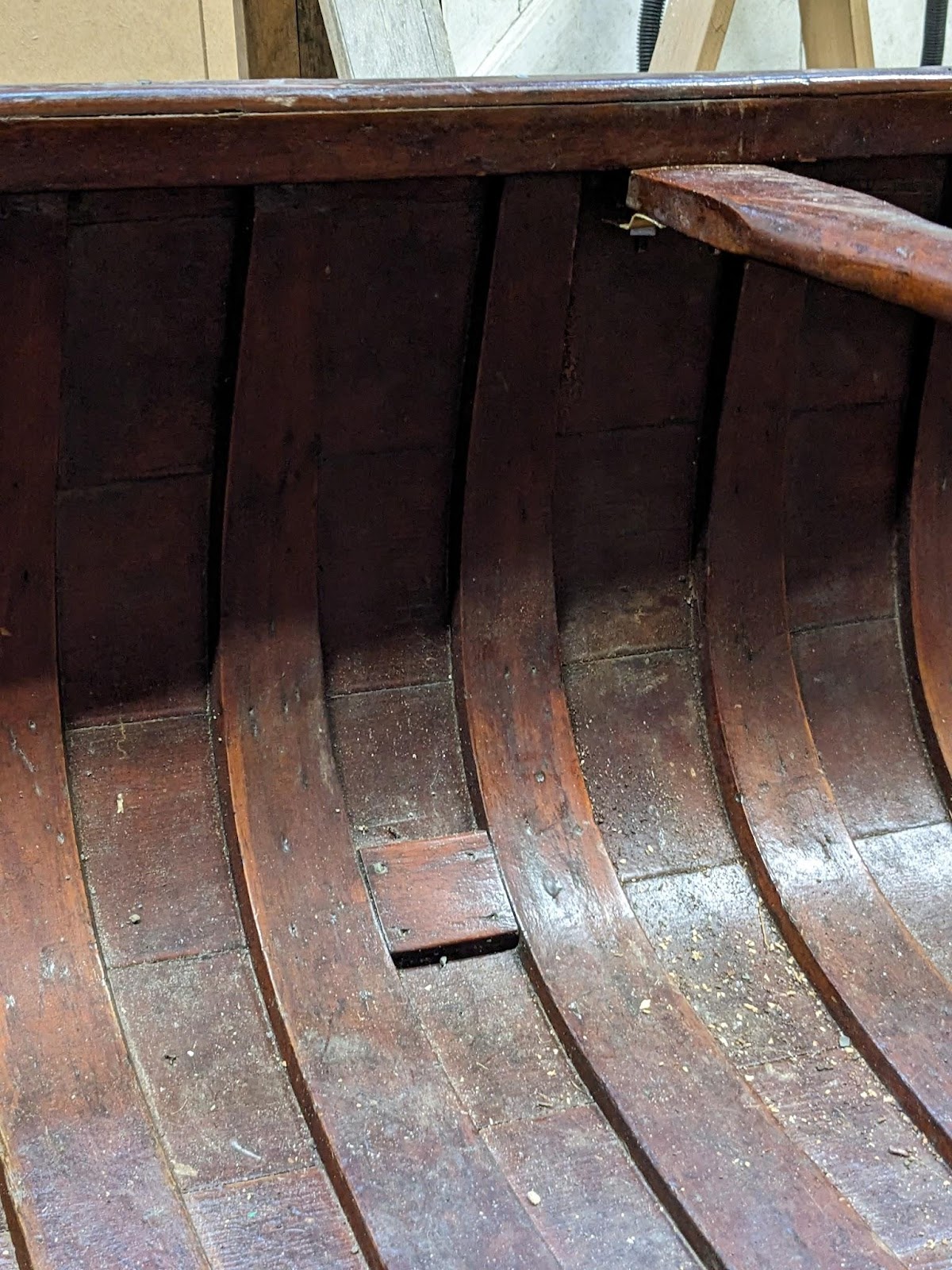

There are a number of historic repairs on the canvas; done probably by someone without the knowledge of cedar canvas boats I think. There is no sign of damage there inside so I imagine they are at places where the canvas was cut or gashed. It looks like the repairs consist of a patch of canvas with probably some sort of glue and then tacked around the edges. There is one internal repair which looks to be over damaged planking.
wPZNLomei4HLNXPF7CDCRuUG3ghZ0rQWZCcMWM93kyTyHGFhMZNDsSv6s5SxVozs2cARjncd9oN8DTXG1qzWCBVKaCxLoYhY6DK9k5WY4bZH0rc4xuaKe6vVhV3CbGUe9kMVMOKaEY0RMhaYNB4tDXw
JMO-gDR_2iQlII0Yun0xEc-brKqbKgeFRGzoSqpGqJ2OueC-DipQD23Up2Hs_iXVukU0I_7giwR5XzwTtmy-8MdmfmZfgGm6kcnjTLDaGpTEozb174yp7itkLqB1_KZWOiURHu6lgn3Z_liIYU3cRhE
I’ll know more about these when I start to disassemble, but I might have to test it first, if I can do a temporary fix on the thwart. Probably worth taking duck tape with me!
