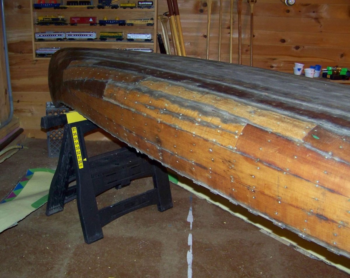

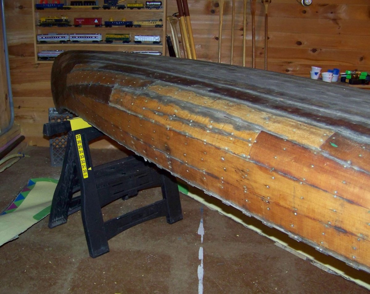

The stains shown on the exterior of the canoe in the photo below were not evident from the interior, which needed new varnish but was otherwise good looking.
