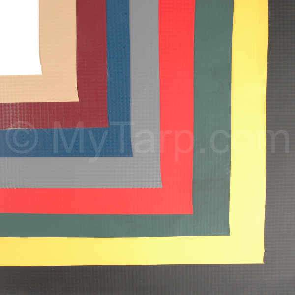

I'm curious how you fellas made out with Verolite or other vinyl coated fabrics.
The above comments were made in 2008 and I'm writing in 2023. Do you think the items sold on this site would work far a canoe?
