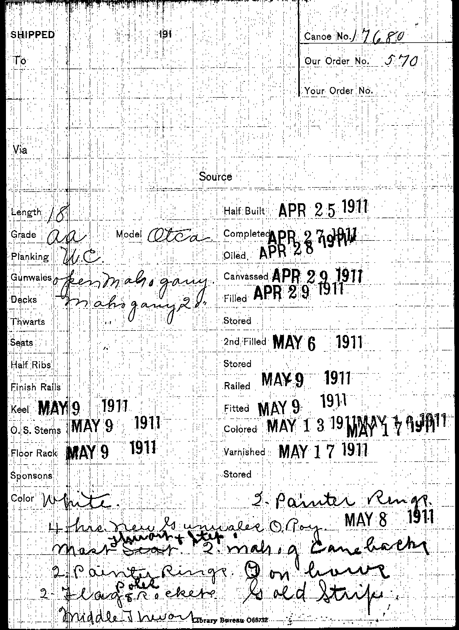

I would be inclined to ignore the twist if the wood is good and solid. The build record for this canoe at http://forums.wcha.org/attachment.php?attachmentid=5203&d=1214692946 indicates that it came off the form on April 25th, 1911 (a.k.a the half built date) and the ends were closed up by April 27th, 1911 (a.k.a. the completed date). The day of week calculator at http://www.searchforancestors.com/utility/dayofweek.html shows that these were a Tuesday and Thursday respectively so you can't even blame it on being a Monday or Friday problem. It is also possible that it was originally straight and developed this twist due to other reasons during the past ninety eight years.
