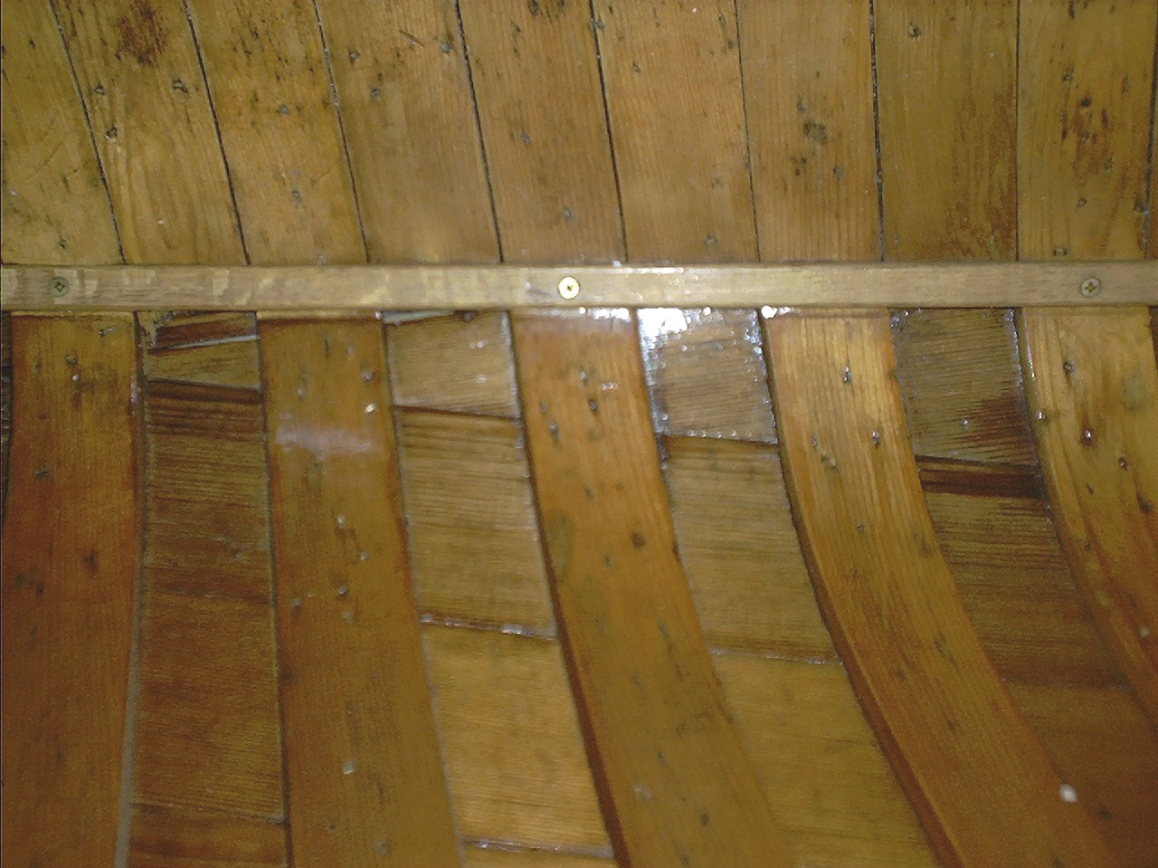

Dave, looks like the stem to me in you response, the trim I have is football shaped and runs on inside of the canoe on top of the ribs extending out to the ends of the half ribs from bow to stern. I guess screws would work?
Rich,
That is the linear trim strip that covers the ends of the full width half ribs that you see on an early Thompson Hiawatha. On mine, the original strip was similar to what is photographed......Maybe 5/8" wide, flat with rounded edges and about 3/16" thick. The replacements that I made were of white oak. Then I countersunk holes sacreligiously(sp?) fastened them with 3/8" phillips head screws. Not original, but it worked.
after looking at the image I now see what you did, I am slow these days. Looks good and I will consider this method. Thanks:)
