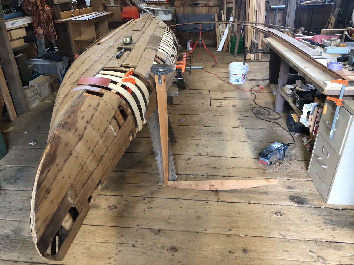

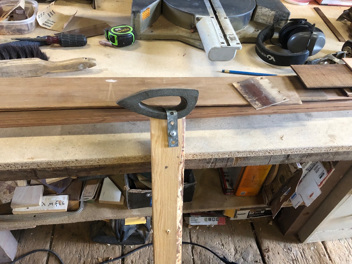

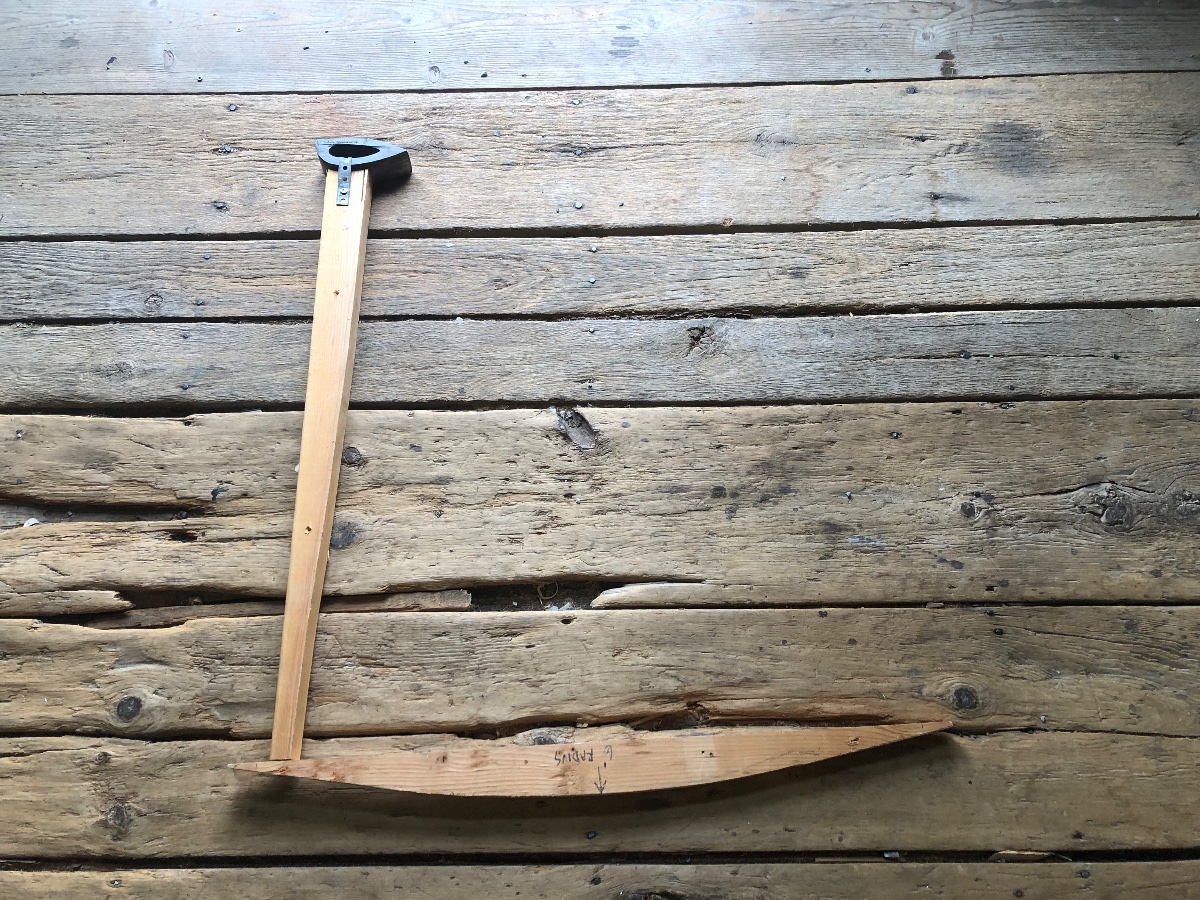

This evening I tried out my new jig. Just finished it the other night. Attached are some pictures. The shape of the curve comes from a portion of removed rib. It worked really well and repositioning it for each rib took less than a minute. For the half ribs it often didn’t need any adjustment. Didn’t take long at all to get a center plank in. Only draw back is that you need to stoop under the canoe and reposition each time but once you get going, things went quickly. If I were to build a second one of modify this one, I would make it a couple inches shorter in length to fit closer to the bow and stern. The curve allows for it to clinch where ever I can’t reach.
