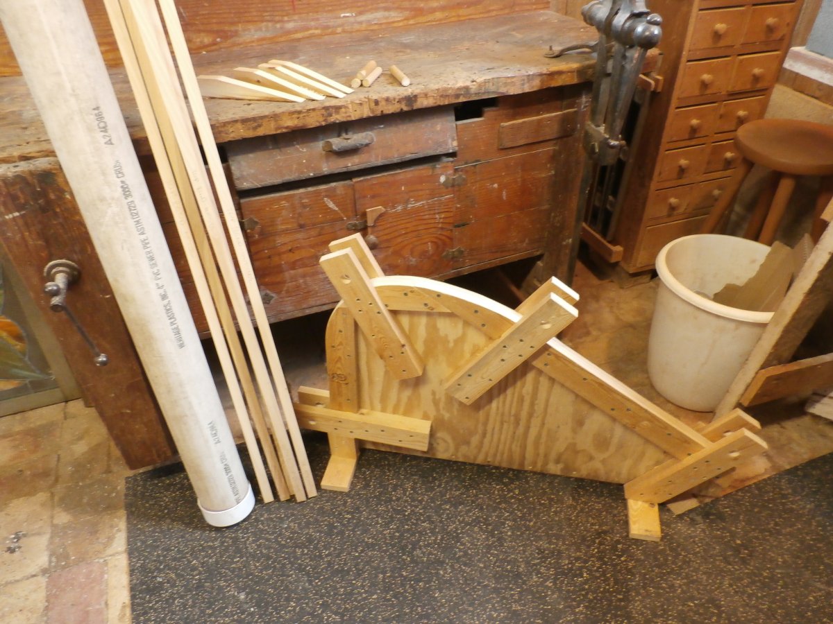

Stripping is all done! Now to making new stems. Built a form and cut four new stems and two are soaking in water. I'm hopping I don't have any breakage during the bending process. Have enough wood for eight stems so I should get two usable ones.
Most stems are narrow across the bend. If you cut the wood to these dimensions then bend the wood will twist on you - at least it always does for me. Always size the wood to a square shape then trim after the bend. Let's say the stem measures 3/4" x 1". Size the wood to 1" x 1", cross fingers, bend, then trim to size after the bend. FYI, on my first try it seems like I went through a cord of wood before I got two that worked.
I have my doubts I'll get the first one to bend right. Used to make shaker boxes but the wood is much thinner. I'll let you know how I make out

Tried bending my first stem this afternoon. I waited until the last minute thinking I would have a failure and didn't want to get depressed if it broke. But was pleasantly surprised it bent without a hitch! Guess the old carpet transition strip worked and a little bit of luck. Now if I can just get one more....
I want to thank everyone for their help with this process. Attached a before and after picture.
