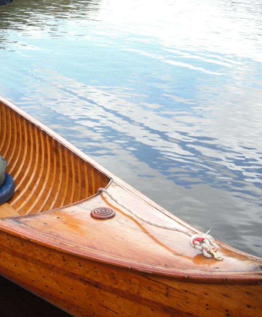

I want it to be as authentic as possible Sam.It currently has a decorative wooden piece attached covering the flag hole.

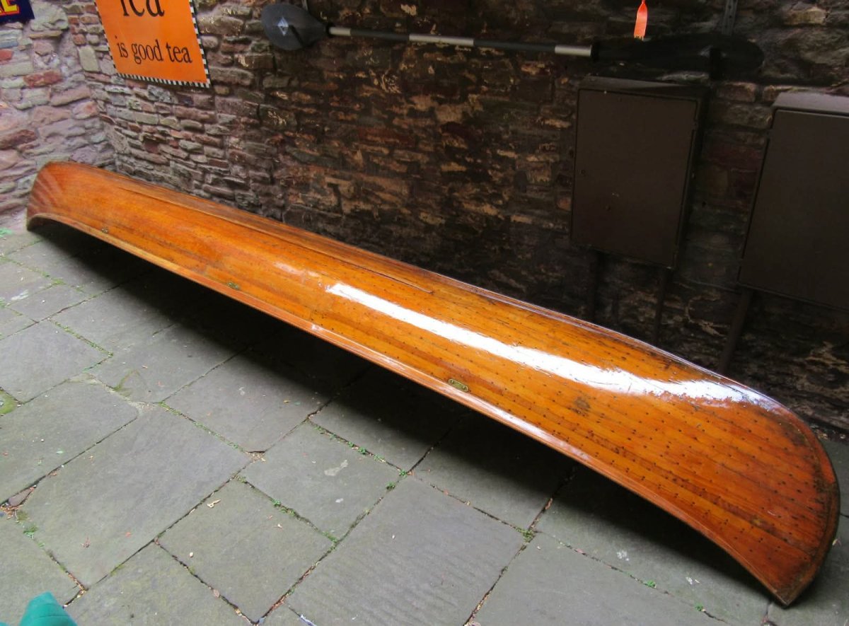

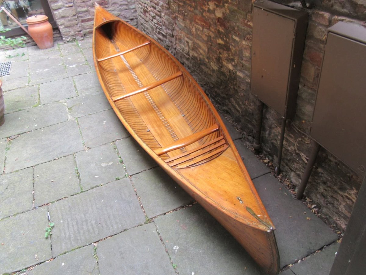

It has the name plates on the side.If I cannot source an original plate any images and size would be helpful to be able to get one made.

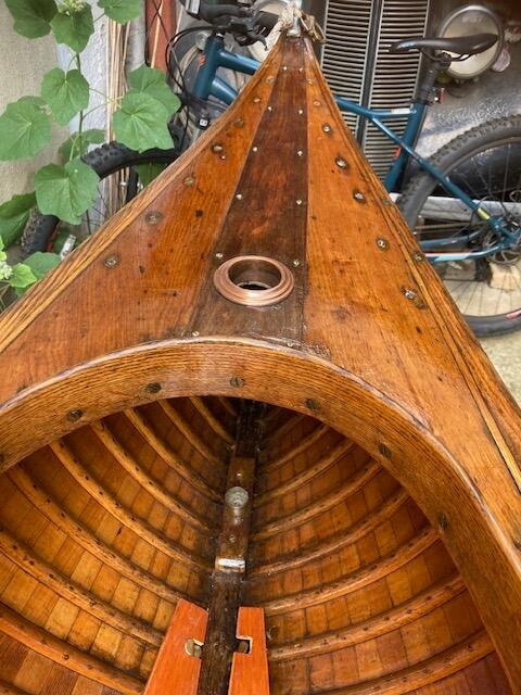

Best I can do tonight. I can take some measurements tomorrow. Does your canoe have a number, under the thwarts, for instance?

I've always thought these mast rings were plumbing fittings from way back when, likely used where pipes passed through walls. I've looked and looked but haven't found a source today, so long ago I had a few turned from solid brass for my needs.
That might be the easiest. I think they were spun brass and quite fragile. Mine has been 'improved' by being filled with lead solder.
Dimensions : ID 1 5/8", OD 2 1/2", height 1/4" (41, 64, 6.5mm).

Which I think means metalspinning on a former is possible. Is the mast ring on mine standard on others?

Cannot see any numbers just the 6 brass name plates.

They are for sure plumbing fittings as Michael has noted, had a laugh at the gym where there are multiple shower heads and each one had the same fitting, albeit a larger diameter and chromed rather than nickled like back when they were made originally. I have a few brass that have been turned, to match the older ones. Would be easy enough to make a larger diameter mast if one could locate a few, and dont forget the cup on the stem for the mast base.
