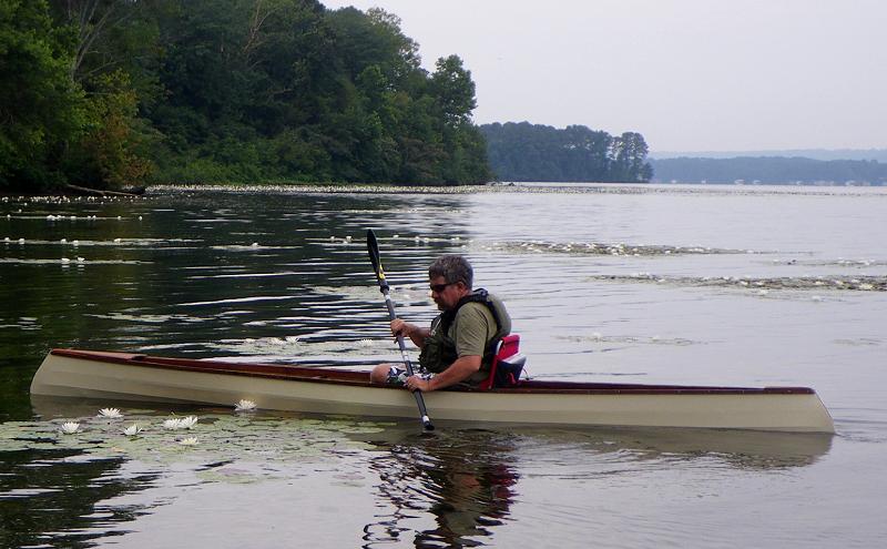

Yesterday I spent a few hours putting on the rub rails on the boat. Pretty simple matter of just drilling holes and screwing them to the Gunwales. I finally decided on a seat, I built a slat wooden bench and just let it rest on the stringers for now. I am going to mount it differently latter but I wanted to get this out of the shop and on the water.
This morning I put a coat of Tung Oil on the rub rails and seat and loaded it on the trailer and headed to little used ramp and as I hoped I was the only one there. So I unloaded Stonefly and slide her into the water for her maiden voyage.
The first thing I noticed about paddling it is it is no kayak! First impressions were it was a barge. Of course compared to the kayaks it is noticeably slower. But the Greenland paddle I was using wasn't a good match to a canoe either. Checking my GPS I found I cruised around 3.5 mph which isn't as slow as it felt. And while I don't have anything to compare it to, I suspect it is actually is far from slow for a canoe.
I found a stadium seat in the garage so I just put there in there to have a back rest. It slides around a little but overall it worked pretty well. It's simpler than building a back rest so for now it will work.
The one area I was disappointed in was it tracks a little on the hard side. This is nice out on the open lake when paddling down to my fish hole, but I really wanted a boat that would turn easy for use on the creeks and this one doesn't. But I made a conscious choice when designing it to be conservative in this area.
So over all I am pretty happy with it. I see a couple of things I will change in the plans but they are pretty minor. If I were to build another one for myself I would flatten the bottom a little bit and make the bow less 'V' shape to loosen up the tracking. If you were to use it on larger water you probably wouldn't want to change it.
