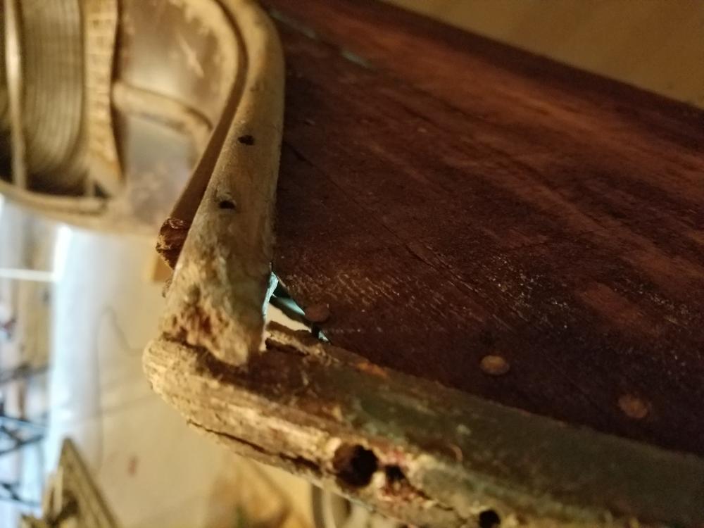

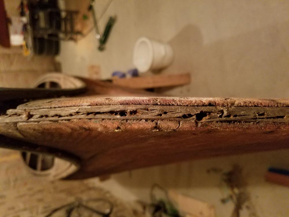

Okay so I have a question about repairing the stems on my canoe with the exception of the last 1/4 inch on top the stems are free of rot. The front edge is quite beat up from all the tacks that have held the canvas in place. 20160801_205534.jpg is it better to just use longer tacks or is there a filler that can be used and still give the tacks something to bite into
There are a variety of solutions. You could fill the cracks and holes with epoxy, but with so much open space as yours has, this could lead to a stem too hard for new tacks to be driven into. You could also glue in tiny slivers and other bits of wood - tedious but at least you'll have mostly wood. You can also attach a false face of wood to the stem face, then shape it down to be fair with the stem and planking. That also gives you good wood to tack into. Best to fill all those cracks and holes, though, before attaching a false face, because water that gets trapped in remaining voids can lead quickly to full-blown stem rot. Worst case, replace the whole stem - this can seem challenging if you haven't done it before, but it's certainly doable.

A recent fix to both stem faces on a rare JR Williams: cut a hardwood dowel the width of your stem face in half lengthwise ( hee-hee ) and about 3' Use a dremel with the wide cutting bit to rout the face to receive the half dowel. Use a rat tail course file to true up the depth of the concavity and go right out to the very edge of the stem. soak the 1/2 dowel in boiling water to form to the curve and clamp. Next day remove, dry and epoxy and clamp. ( Remove some plank fasteners one side to get just a few small c- clamps on. ) Clean up where necessary and true up the face and there she be....a new face, true and hard with all the holes filled and only a few planks removed. Where the stem blends into the bottom hull surface just taper the concavity to receive a tapered end of the dowel and that is a clean end. At the top of the stem just blend in the dowel to a new BEAK and you will have essentially all new wood for the tacks. Hope this helps. Most importantly, have fun.

I would be inclined to do as Michael suggested and glue in splices and plugs. The stem is really not that bad looking. It certainly does not look bad enough to replace and unless there are other issues that you need to sort, there does not seem to be anything that should compel you to pull the planking apart...
I would use Titebond III to do the plugging and then follow with a bit of West Systems G Flex to fill any remaining small cavities. If you happen to end up trying to put a tack into the G Flex you may find that it will turn your tacks...no worries, just poke a small starter hole with a small awl and drive the tack.
Taking this repair approach I would use a 5/16th or possibly longer tack.
You should be able to put at least a couple more canvases on that boat before you need to do anything else to that stem.

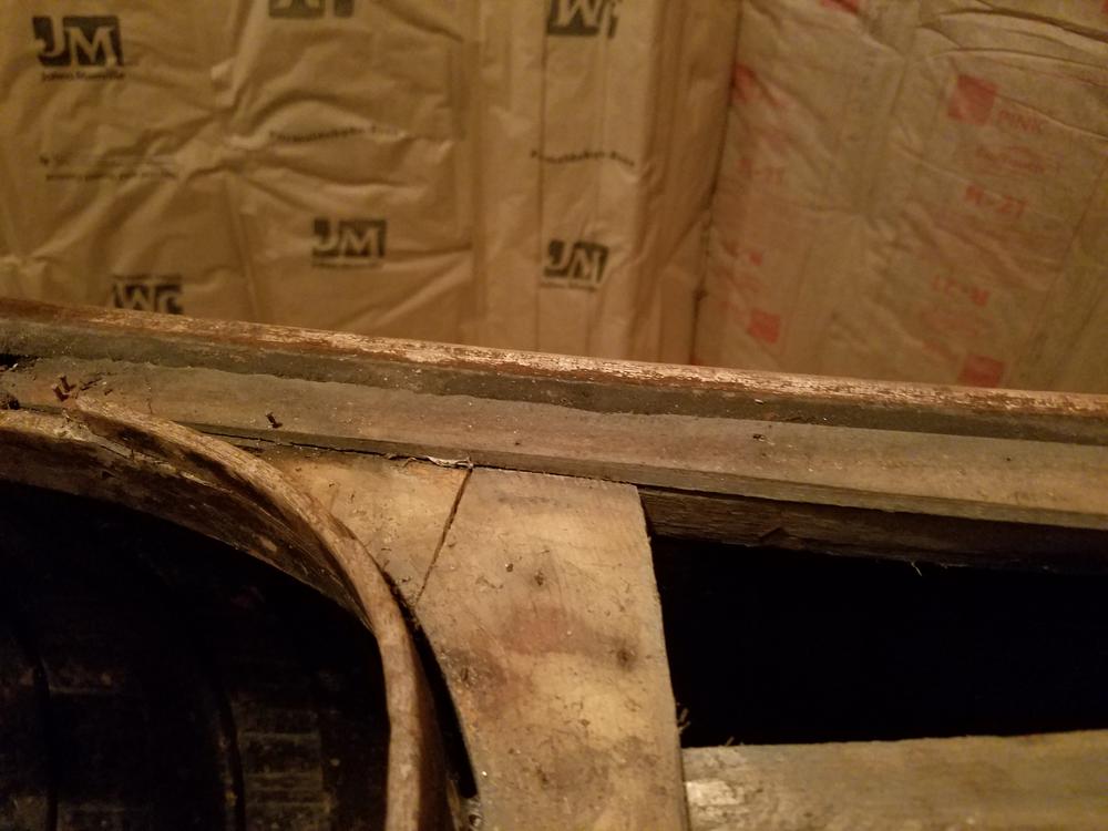

So today I removed the mahogany stern deck to get a better look at the inwals and the inner stem. It is a very interesting design. In all the photos I have looked at I 20160811_180134.jpghaven't found one that looks like this.
Notice the shim added on top of the inner in wall 20160811_173328.jpg20160811_173314.jpg20160811_173405.jpg
None of the previous posts in this thread indicated what kind of canoe you were asking about, but these photos suggest that this is the Kennebec from your previous posts - is that correct? The junction of the gunwales and stems that you asked about earlier should be plainly apparent from this end of your canoe - everything looks intact and original. The other end was most likely done exactly the same. The construction of your decks is not unusual for a canoe with this style of decking, and likely perfectly normal for this model.

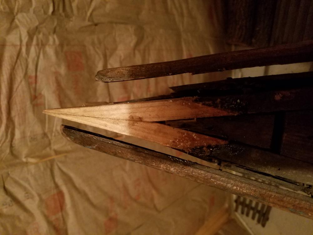

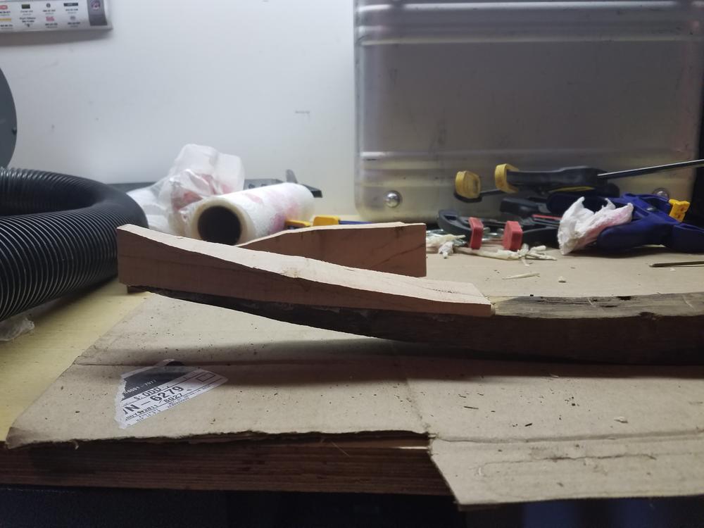

So today I started the repair to the stern inner gunwale, and inner stem since they where the most intact. Please note these have not been shaped or sanded to their final shape and are still a bit ruff looking 20160813_223515.jpg20160813_223525.jpg20160813_224050.jpg20160813_224105.jpg
Hope they hold up, that's a pretty short joint, it's been a while but isn't a 4-1 the minimum? That's about a 1.25 -1.
Dan

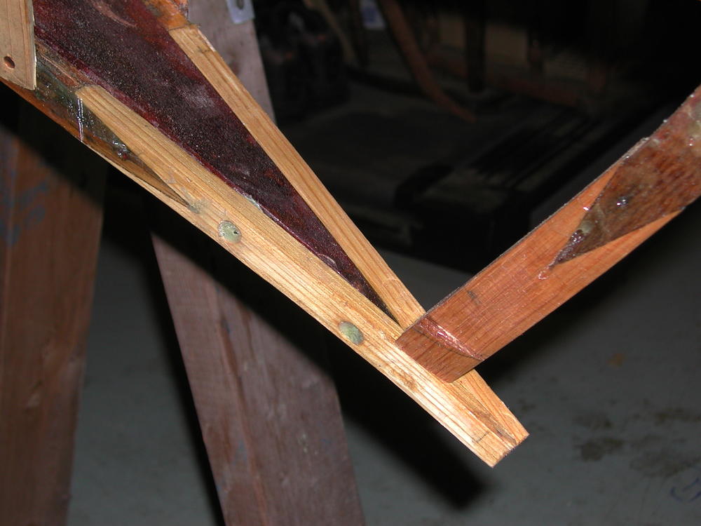

OH MY ! I would redo these joints, for sure. ...and use the bird beak approach....and use more material on the stem piece to get the curve to the deck point correct. If I can find a pic, I will post here. Keep up the fight....I have had to do more than one REDO over again, and so it goes.DSCN2005.jpg
With apologies for disregarding historical Morris construction, here is my inner-stem-tip bird's mouth scarf, incorporating a hanging knee and filler material for the deteriorated inwale ends and inner deck (breasthook) tip. Carved from mahogany. Fortunately the outer 36" decks and center battens were in better shape than the inner construction.
Paul I saw your photo somewhere it may have even been on here when I was researching how to go about repairing mine it looks like you reinforced the the area quite well

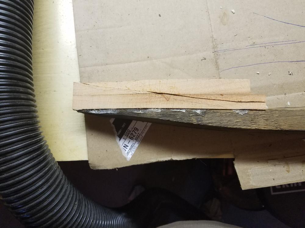

Okay finally had a little time to do some repair work to the stern this weekend. This peace of the inner deck had split where the screws had rusted.20160904_130724.jpg20160904_145641.jpg20160904_145655.jpg
Will have to get it back into place to finish shopping it.
