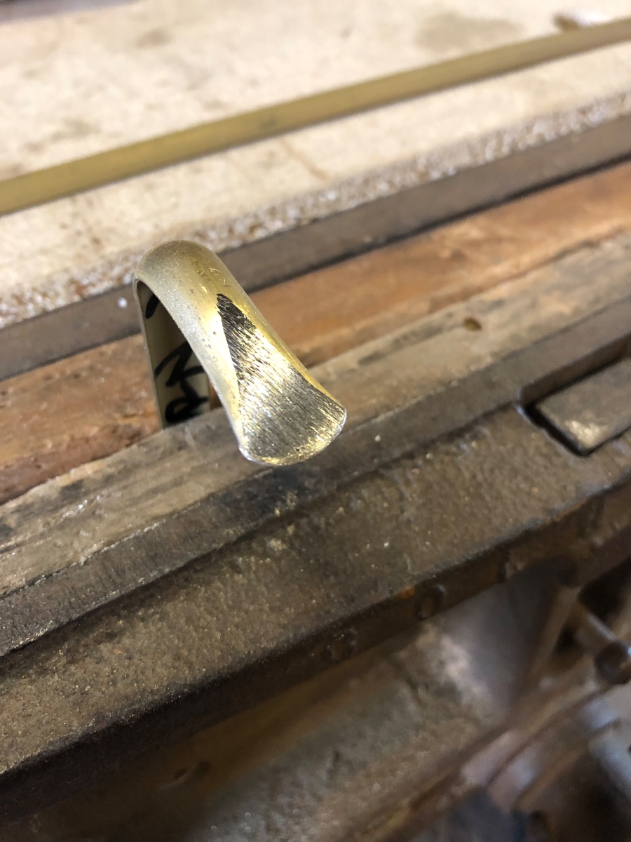

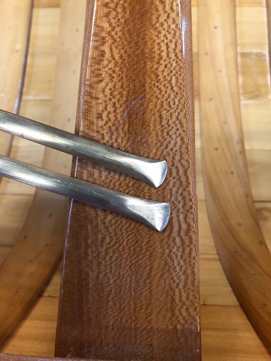

Zack, might you have a photo or two of this flared stem band end to share? Today I did a little pounding on a scrap of stem band, making a flare similar to, but slightly more enlarged than the one in Benson's shared image. And rather than a convex radius at the end I might experiment with a concave arc at the end to mimic the deck shape. Trivial detail, yes I know... but fun to think about.

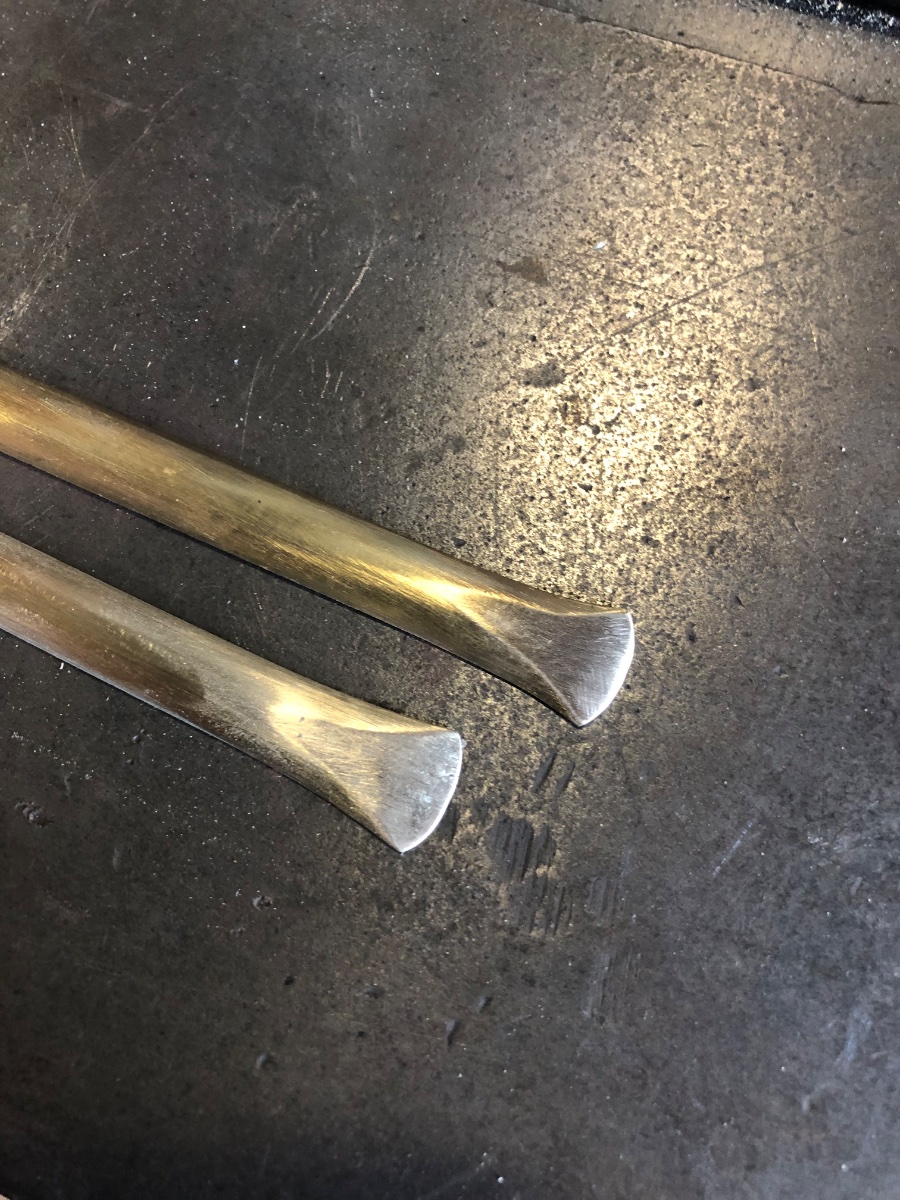

Here's a brief attempt on a scrap of stem band. I think it's a pretty hard alloy- cold pounding on a small anvil produced the taper and flare, but also the stress cracks (hard to see in this photo) at the end radius. This experiment was filed and then sanded with 80 grit so far. It deserves a little more experimentation. Maybe introducing heat first and during?

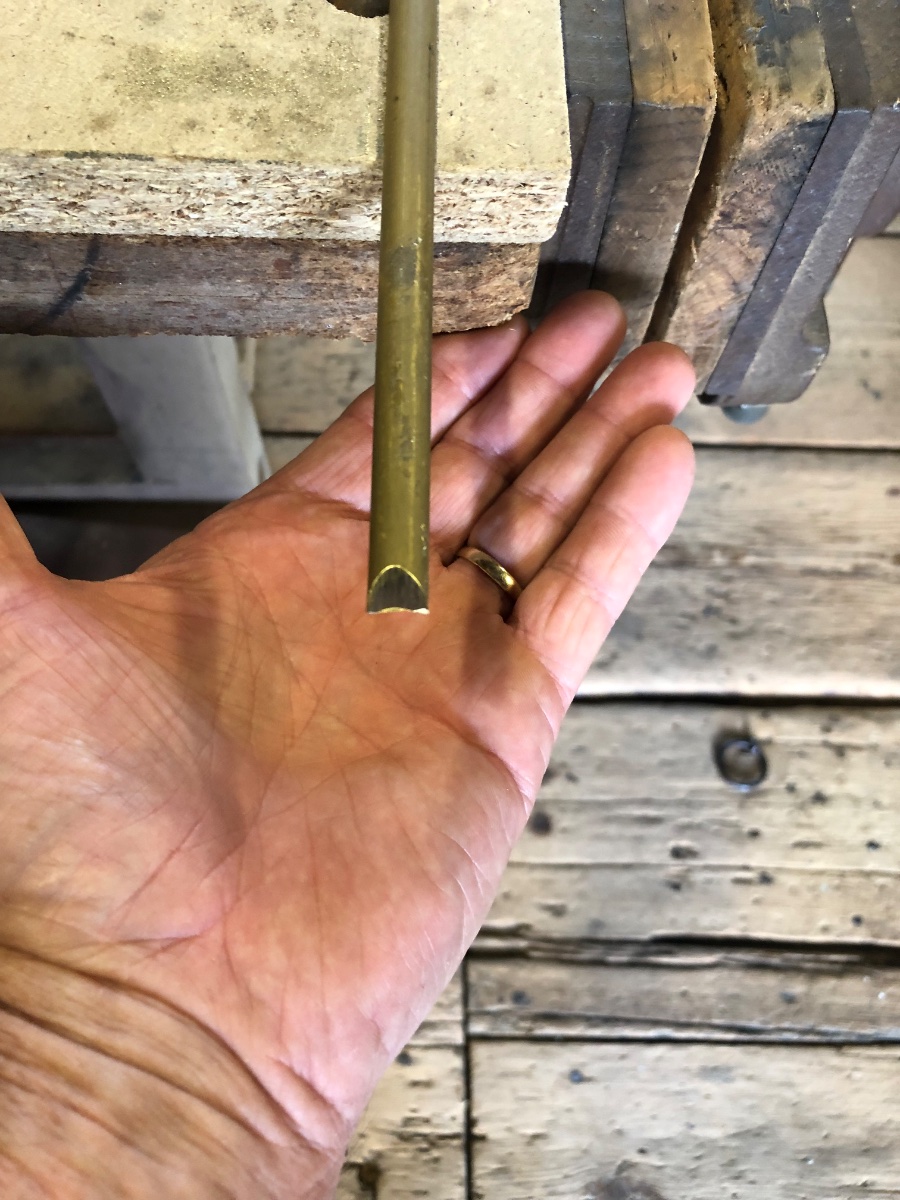

Standard bevel for comparison. I checked every canoe in my barn, Old Towns, Chestnuts, St. Lawrence Boat Co., they are all bevelled!

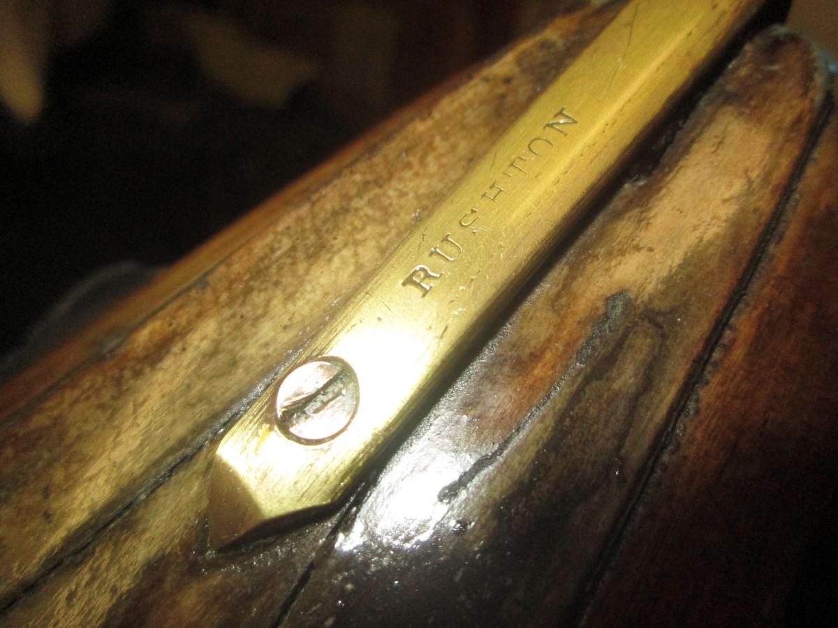

Attached is a picture of an original Rushton stem band from a canoe the Steve Lapey restored. The end has a rather "diamond" shape to it. On the Morris I just finished the end of the stem was simply filed off with a 45 degree angle. They did nothing fancy.
Jim
Thanks Jim for that Rushton detail. I have seen a Rushton stem band with an end shaped to a "pointed" bullet shape, but not the one you show.

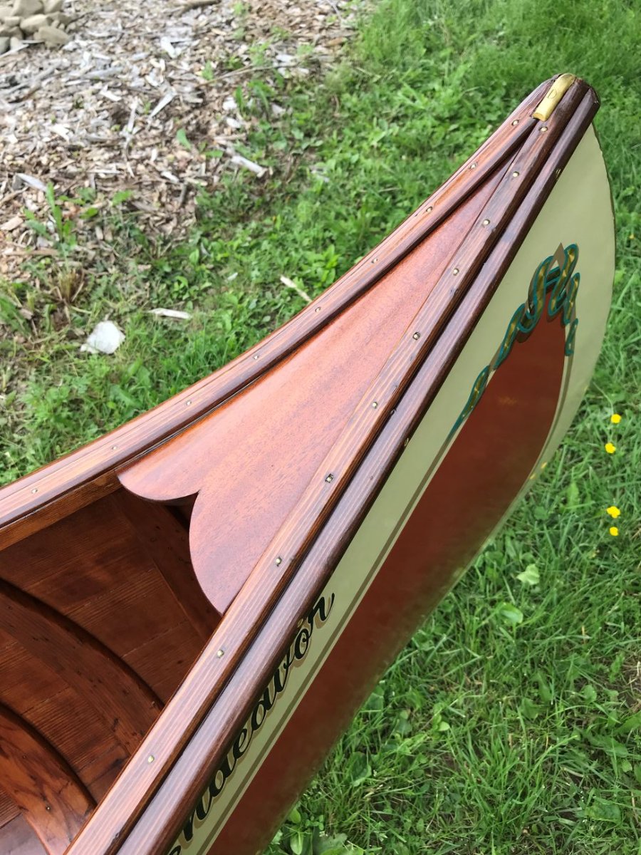

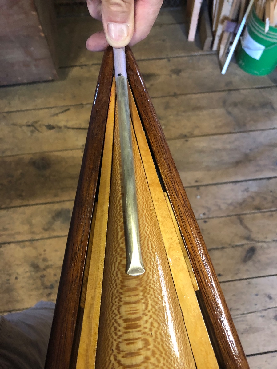

I have decided to go with the shape in the following pictures.
One can sometimes over think the embellishments/decorations of a project on which one has toiled for a long time! My Dad used to say, "don't gild the lily"; suggesting that the thing itself is the beauty and doesn't need additional decoration. This canoe (my first new build) has taken shape over time due to a well-made form (thanks to Keith Lake) for a well-designed canoe (thanks Rollin Thurlow) and has evolved into this beautiful creation in my barn. Yes, I did all the work, but it's almost as though the canoe morphed from this collection of flat materials and my minor design input, into a fully formed thing of beauty. I wish I could share it with all of you at Assembly, but I'm unable to attend this year. Next Assembly perhaps. In the meantime I'll post a gallery of pictures when truly complete.
Yes, quarter sawn American Sycamore. It’s a species that is very common where I live, typically found along watercourses and lowlands. I used it for decks, grab handles, seat frames, and thwarts. My little bit of Pennsylvania in an otherwise Maine canoe.

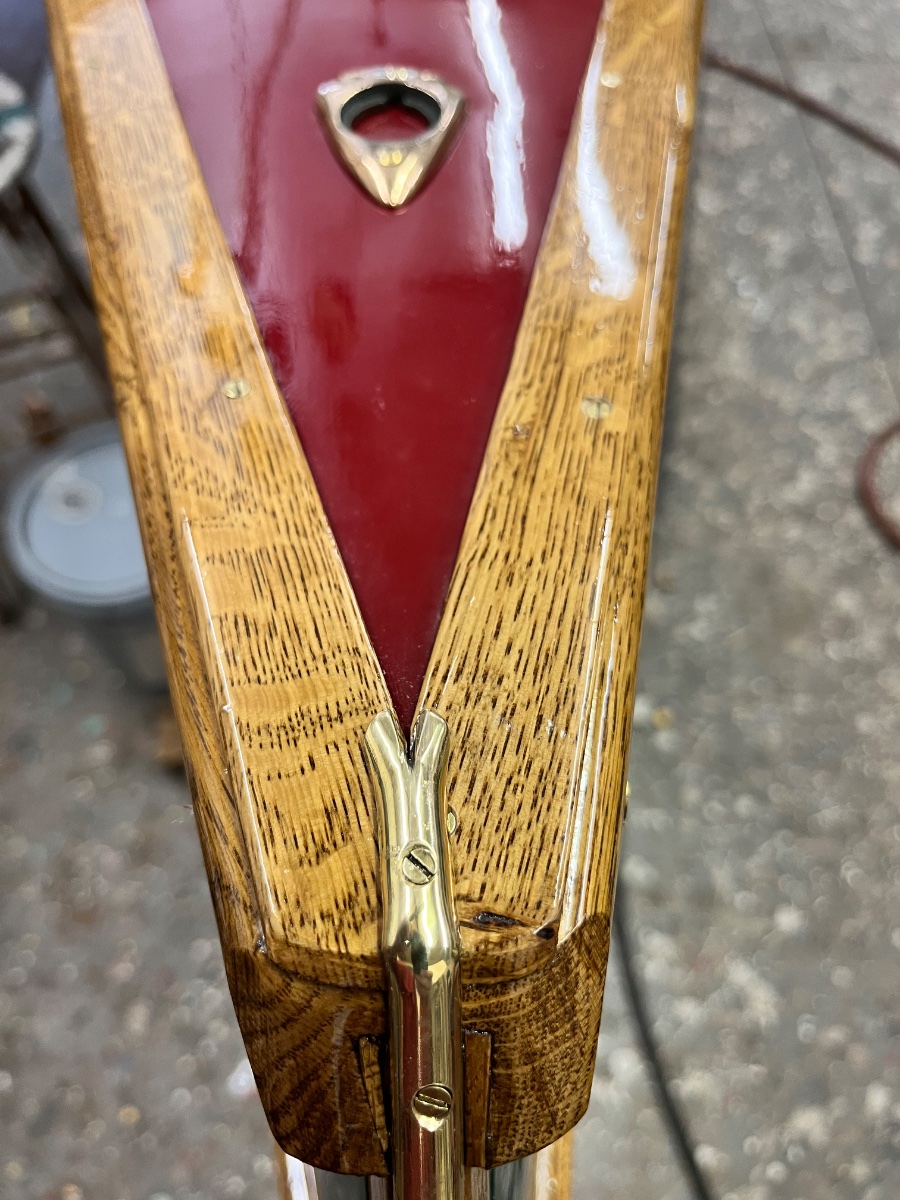

Pat, I know you are probably committed to the chosen end of the band. But I am compelled to say. I have used the bullet about an inch and a quarter long and highly polished to finish. I see it on your extraordinary fading deck shape showing those captivating figures in the grain . The fineness of the bullet image on these long and narrow decks is really quite something. In your case with the deck shape and grain image I would even consider a longer bullet and even make a sample(s) before committing. And / or sampling different lengths, tapering much earlier if you were to go LONG, and consider if there is a way to pin the last screw and rid the image of a common old slot. Believing here that overthinking in not the same as overuse. WOW what a fine thing you have wrought !
Dave D.
Dave, thanks for your thoughts. I can’t visualize what you’re suggesting. Do you have an image or drawing to help me understand? I’m not fully committed yet. I have not made the bend yet or drilled any screw holes.
