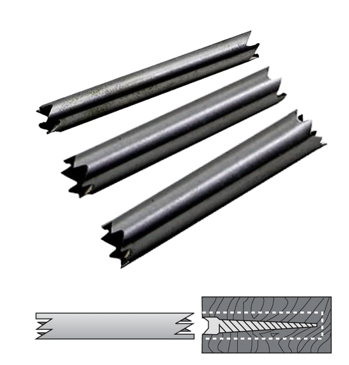

Unscrew-ums, available from several sources including tltools.com and Highland Woodworking:
For more info:

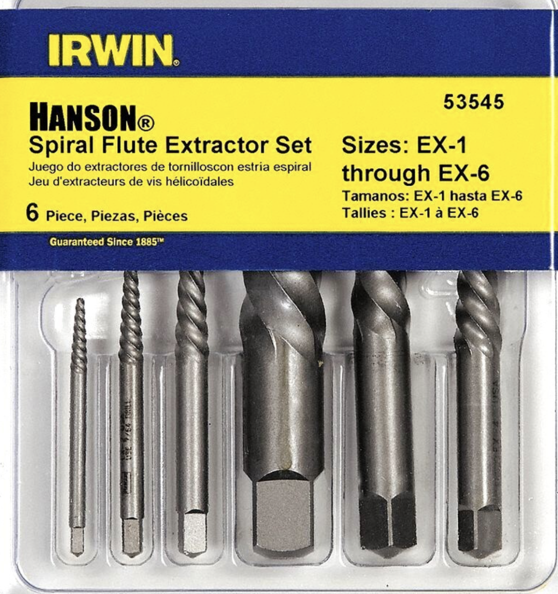

Reverse-twist bit set:

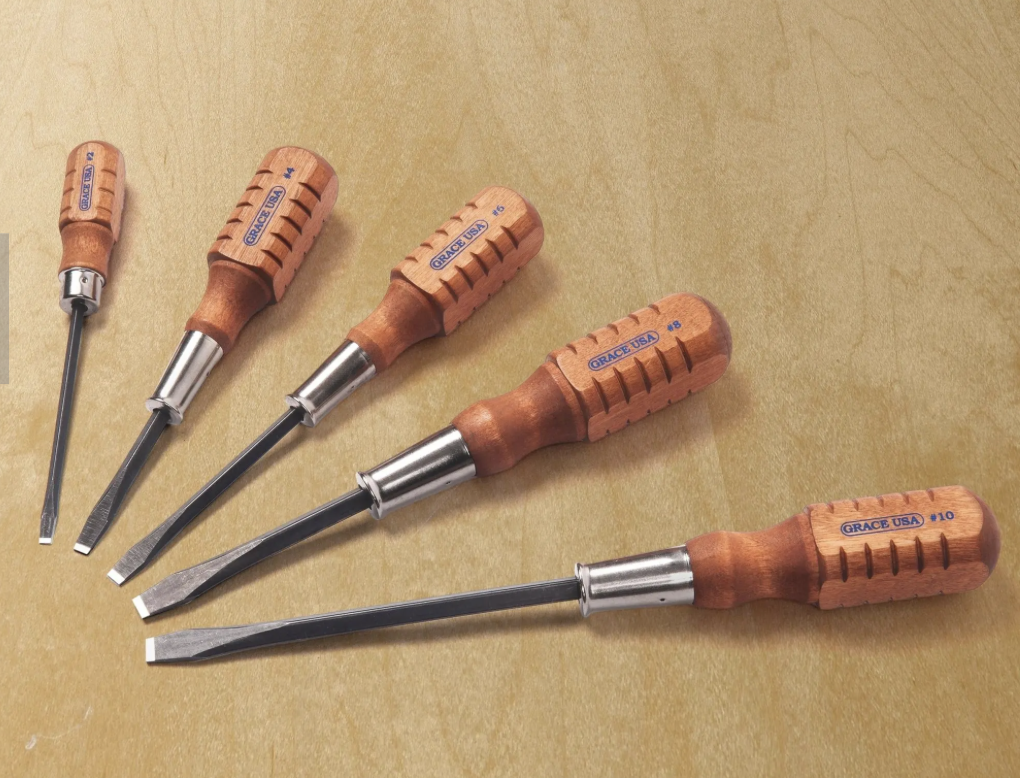

Parallel-tip screwdrivers (game changer), available from Lee Valley:

I have a special, fairly early EM White that is full of steel screws. I had the same experience as you, Gil, cleaning, rapping, forward and backward, and putting my weight behind the screwdriver with no luck. After that I took the tedious approach of getting them out using spiral fluted screw extractors. It takes time, but it's worth it to me.
I have had success using EZ outs. You pre-drill and then it's off to the races. You need to be somewhat careful using them. If you get too ambitious you might break them off inside the screw, and then you are screwed.
EZ outs are very hard. You will not be able to drill them out if they break.
