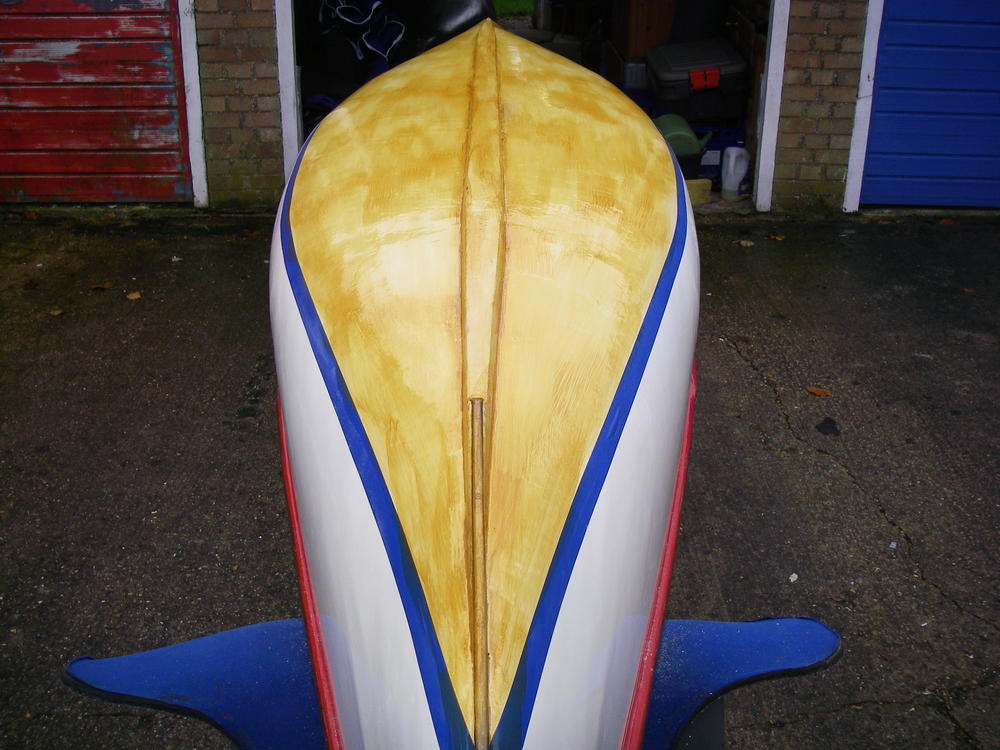

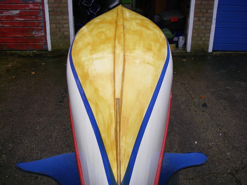

I tried this. I rubbed the Epifanes enamel down to give a key but it really did not like it
That blotchy sort of application is somewhat typical of what shellac looks like after it's been applied to a boat several times. It is very hard to get a consistent and brush-stroke less result.
However, on the bottom of a working canoe, one that is used for go, no show, that shellac really serves purpose by smoothly slipping and sliding over rocks and wood. I find it an awefull lot easier to lay on another coat of shellac to heal things up than to try and elegantly repair damage to paint. Unlike paint, the shellac can be layed back on with minimal fuss without adding the extra weight off layers of paint.
Clearly this is not a finish for everyone and honestly, the first time I saw it I was pretty sure it was not for me either.
One quick trip down the Allagash and Penobscott sold me on it though. I'll never take a painted hull down those rivers again.
