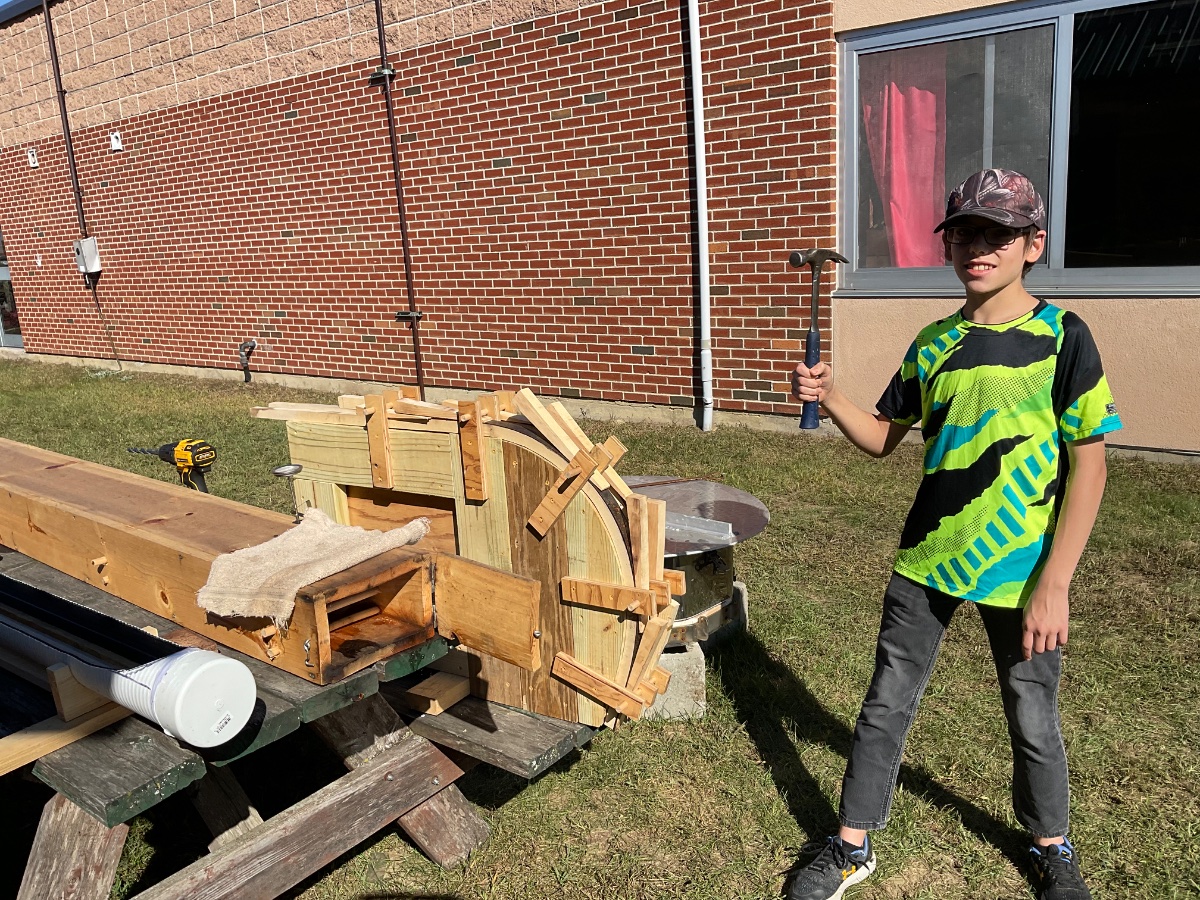

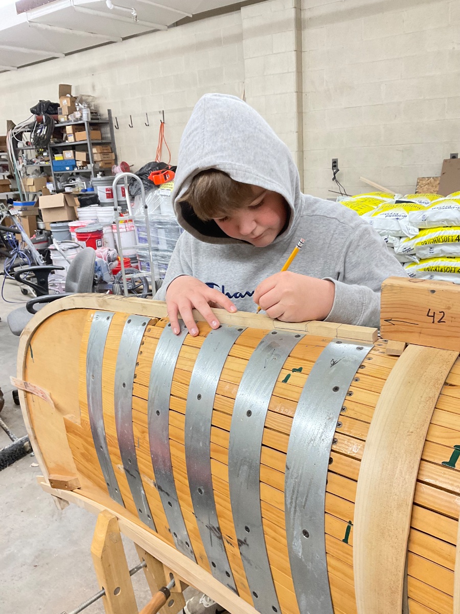

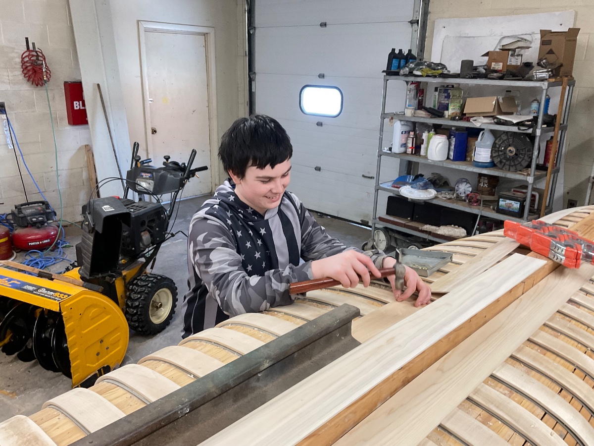

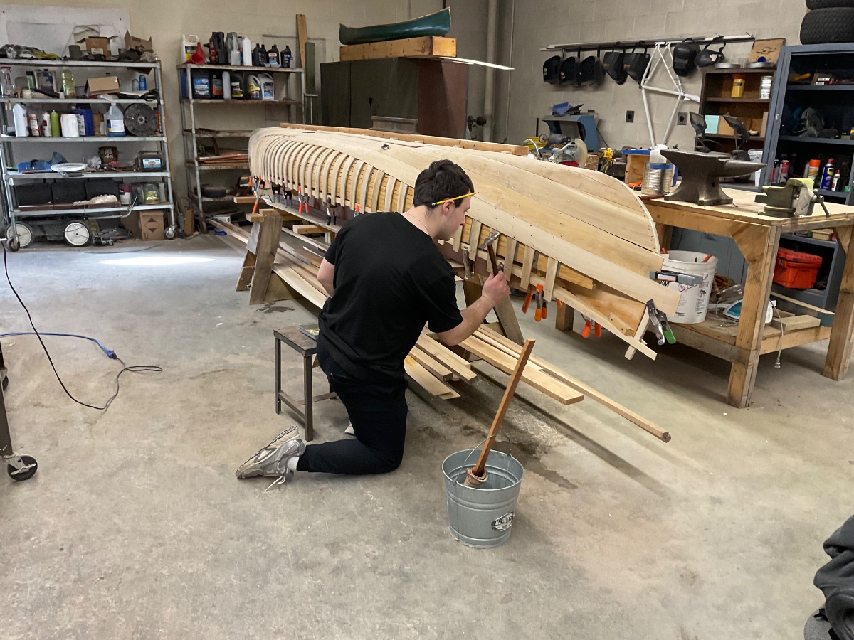

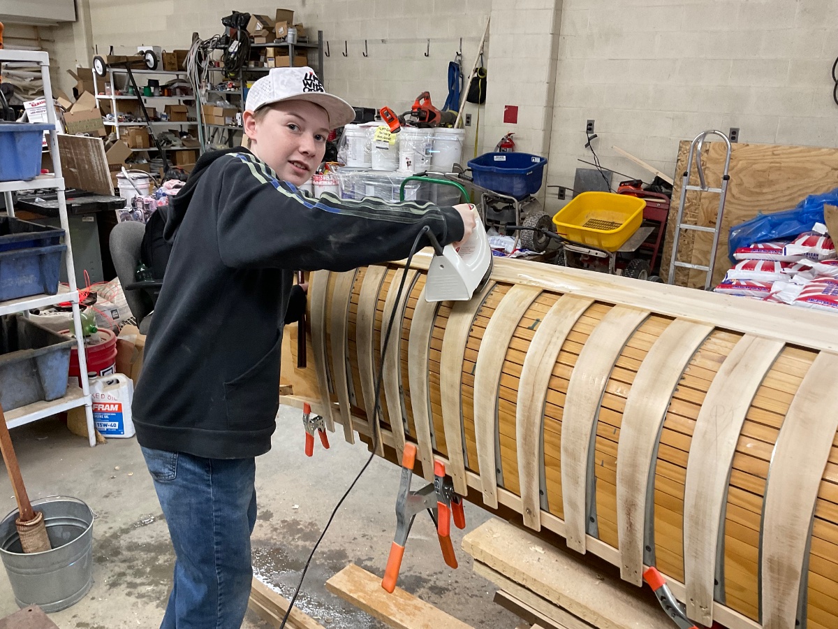

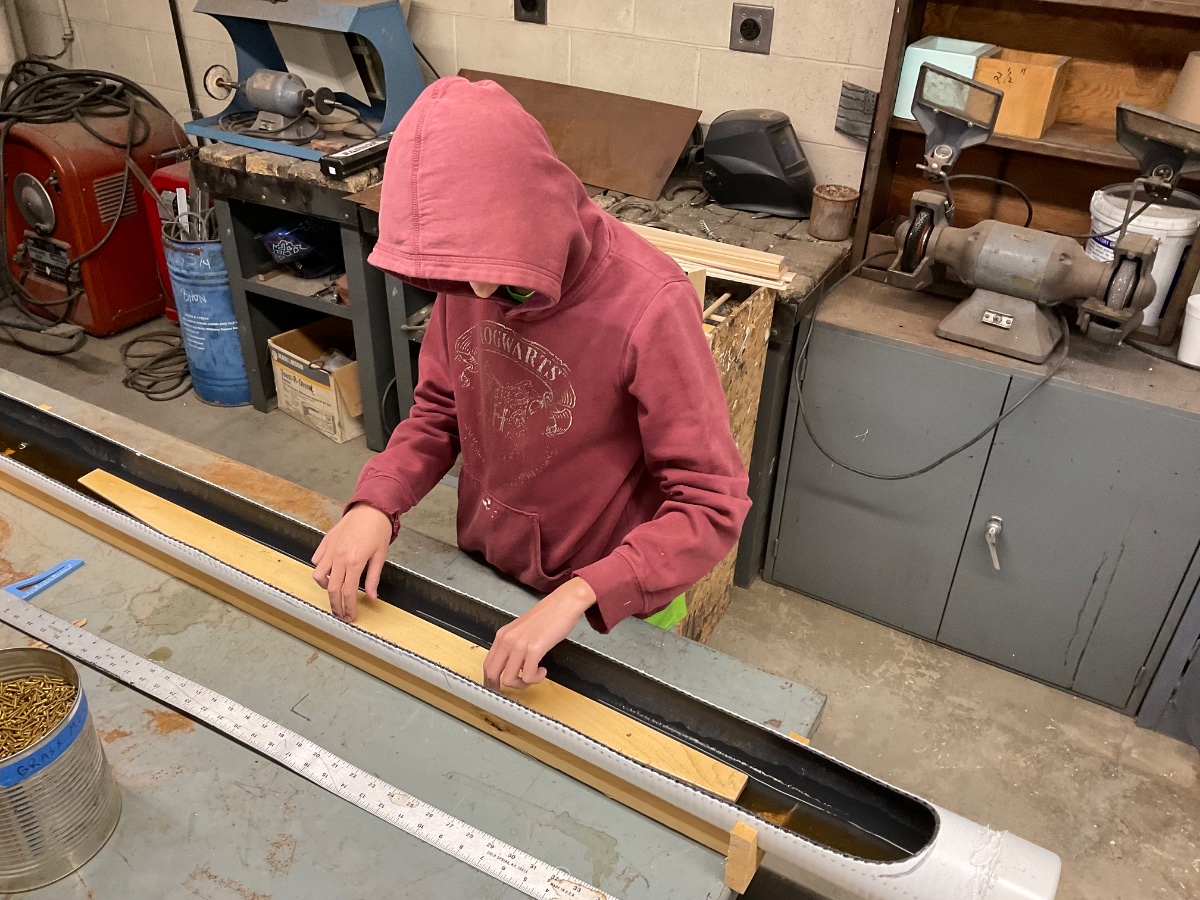

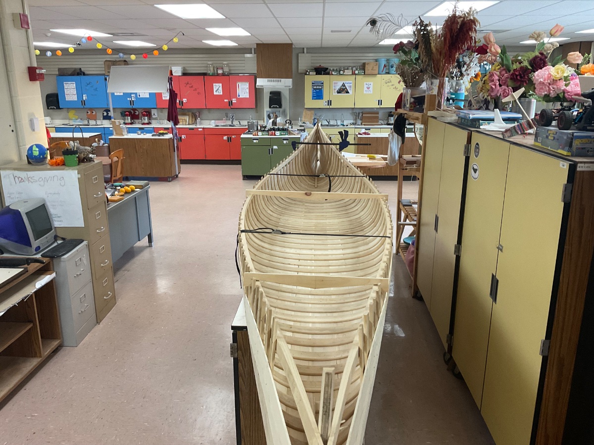

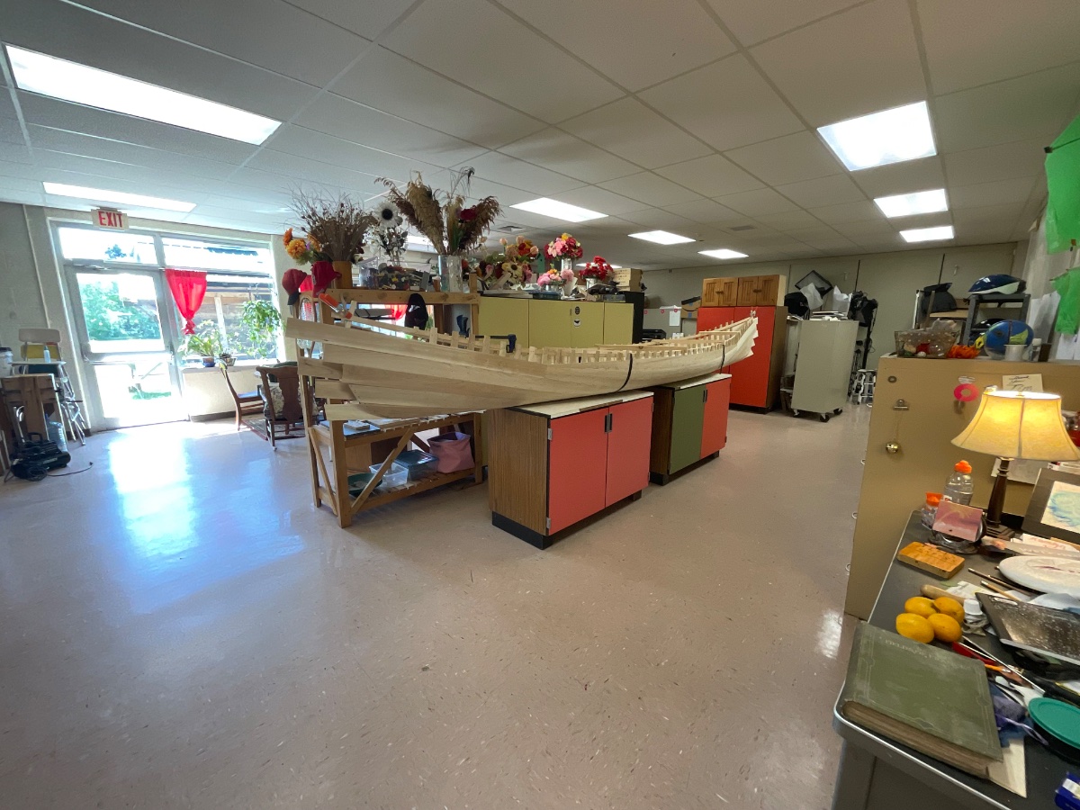

Some of my students were into the canoe build, others not, but the ones who got into it will remember the project for a long time. Here are some photos of our work:
