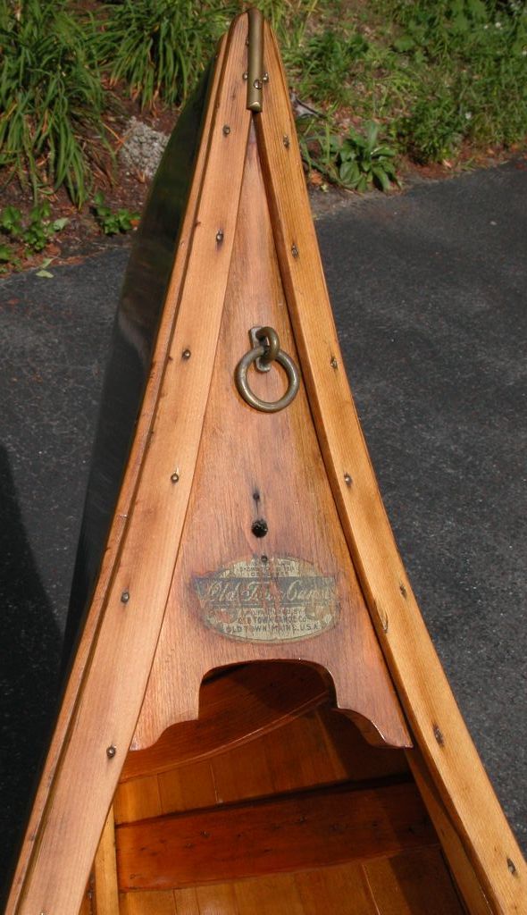

Some people can do an amazing job of removing varnish while preserving a decal. The first image below shows the faint shadow of an early Old Town decal under many coats of grime etc. Rollin Thurlow was able to remove the junk and preserve most of the remaining decal as shown in the second image. It is still far short of the example shown in the third image but that decal was lost completely during the restoration process. Hopefully someone will find a better example of this decal some day and share a clear picture of it here.
