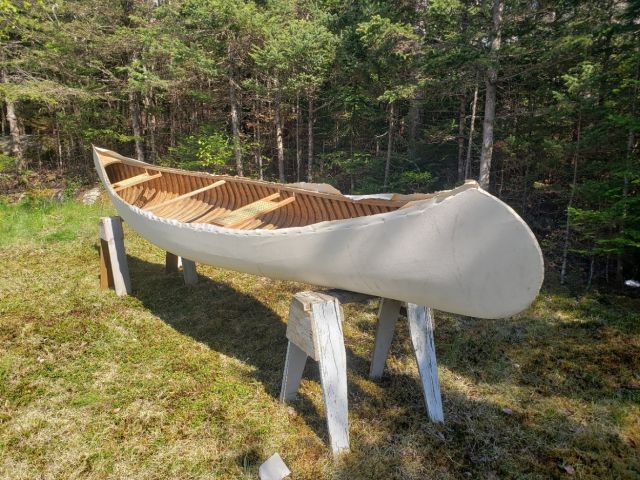

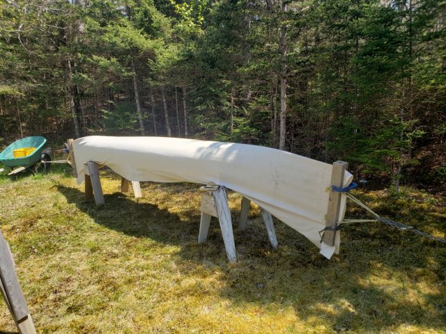

I have been distracted and neglected the old Pete for quite a while, but now it's back on the agenda. Put the canvas on yesterday. Today, I painted the gunwale area with a preservative and I'm going to mix up canvas filler from scratch. I plan to put it on tomorrow. Then I push it aside and wait a few weeks for a full cure of the filler. Meanwhile, I'm trying to locate a source for stem bands in Canada.

I applied the filler today. I used the formula published here that starts with 43 fl oz of boiled linseed oil, 6 1/4 pounds of silica, etc. When I had it mixed, I thought it was too thin and added another scoop or two of silica. It was still pretty thin, but it's not plaster and it's supposed to penetrate the cloth weave some. I applied it with a small but fuzzy paint roller, then went over it with a plastic drywall knife, then rubbed it to a shine with a canvas mitt. I think it might be the best-looking filler job I have ever done. 2 1/2 hours. 3 1/2 hours including setup, finding tools, mixing, cleanup, putting tools away.
I have done somewhere around 15-18 canoes using many different materials, taking advice wherever I could find it and only learning a year or two later what that advice was worth. Later, if anybody is interested, I could write a history of the various fillers I have experimented with and how they worked. My experience is broad, though thin.
