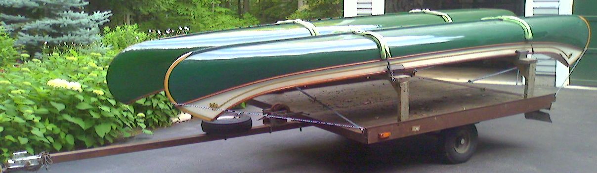

I've done a couple with 1Shot gold and some good pinstripe brushes. I masked it off to make sure everything went on straight. 1Shot is the go-to paint for hot rod pinstripers like Von Dutch.
https://www.eastwood.com/1-shot-paint-metallic-gold-1-2-pint.html
index.php
You might also try lettering brushes too. The width that you're laying down may work better with a good letter brush. I ended up pulling the masking tape off when the paint was still tacky. It allowed me to clean up any bleed through from the masking tape with mineral spirits.
