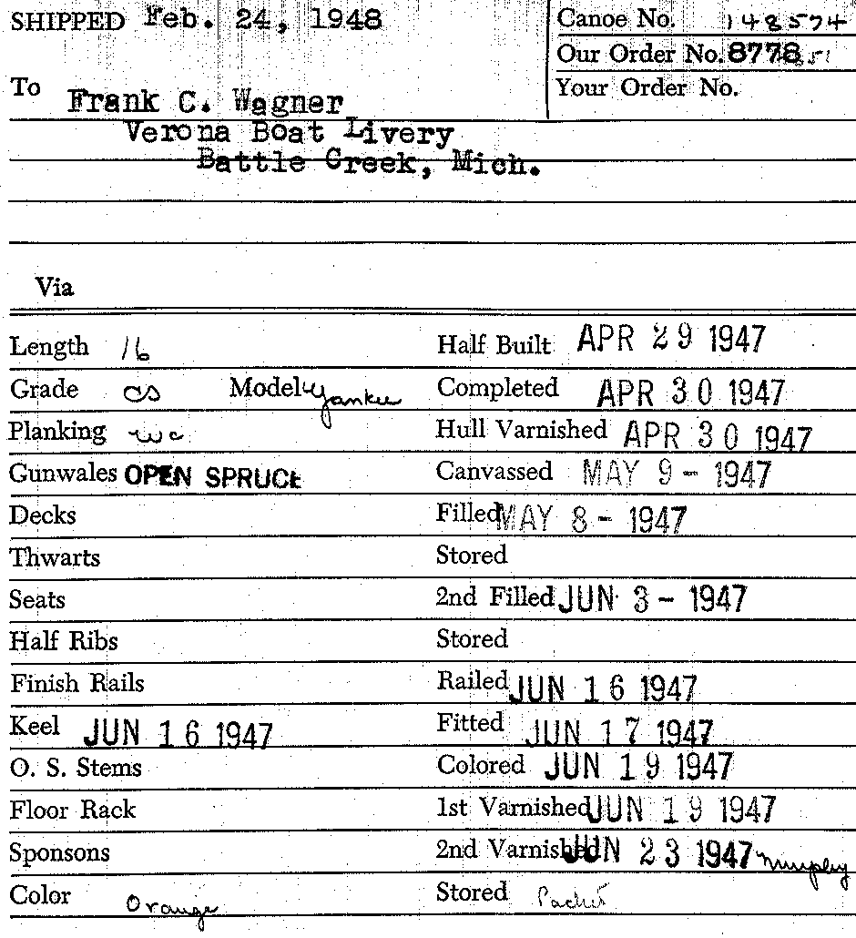

The Old Town canoe with serial number 148574 is a 16 foot long, CS (common sense or middle) grade, Yankee model with red Western cedar planking, open spruce gunwales, and a keel. It was built between April and June, 1947. The original exterior paint color was orange. It was shipped on February 24th, 1948 to Battle Creek, Michigan. A scan of this build record can be found by following the link behind the thumbnail image attached below.
It is also possible that you could have another number or manufacturer if this description doesn't match your canoe. Feel free to reply here if you have other questions.
