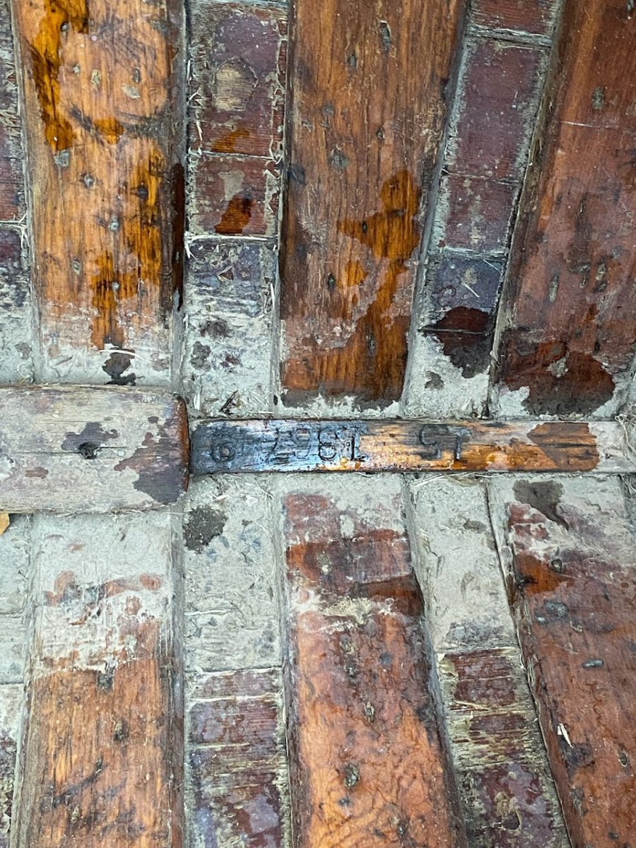

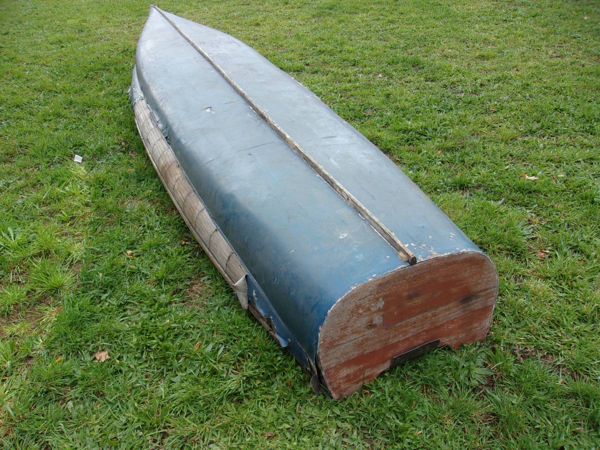

Found this post searching OT Sponson boats. This is a 15' footer. Maybe the model/length affects the serial number or this is an older boat? Would love to hear anyone's thoughts. This boat will be for sale.
Serial 15 136749.
View attachment 40657 View attachment 40658 View attachment 40659

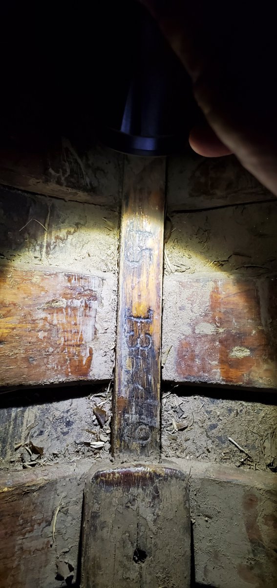

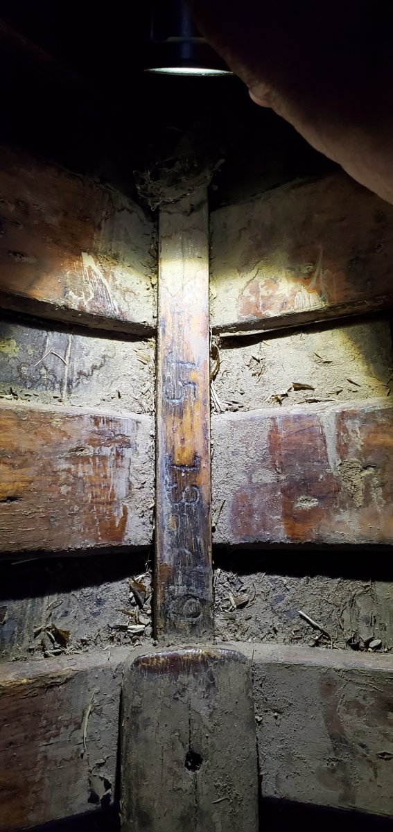

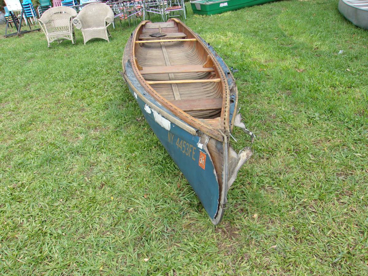

So I know it's an Old Town because it does have the name plate on the bow deck. I was trying to read the number from the inside front stem, but I see in the directions in the link that you provided that the serial number can also be found in the back. I will have to check there when I go back tomorrow and/or try a rubbing. Do these photos provide any clues?
