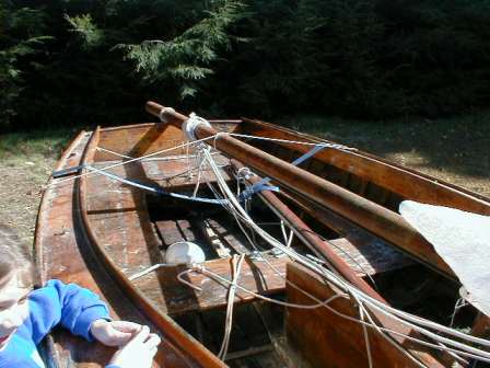

Floor boards for Old Town Whitecap
I'm in the midst of restoring a Whitecap that did have some serious rot, cracked planks and broken ribs. It did not have any floor boards when I got it, but have seen photos of others showing them. My plans are to use white oak and build "sections" that can be removed to allow access beneath them. Does anyone know if this was the original design, and what thickness might be appropriate? My thoughts are between 3/8 and 1/2 inch thick, but don't want to add extra weight if not needed that thick.
The pictures at http://forums.wcha.org/attachment.php?attachmentid=243&d=1110167997 and http://forums.wcha.org/attachment.php?attachmentid=2093&d=1159923510 show some of the floor racks in a Whitecap. I believe that they were originally made in sections so they could be removed. Several Whitecap owners have posted messages here over the years so you may want to search for their messages and contact them directly. Good luck and please reply hear if you don't get the answer you need. Thanks,
Benson,
Thanks for the reply. I've seen copies of the pictures which is the reason I want to add the floor boards. I'm still hoping that someone will have the information re. thickness. Already replaced the inner and outer stems, several of the ribs, the centerboard and rudder. Stems and ribs are epoxy laminated oak while the CB and rudder are mahogany.
Jim
I was able to look at a similar sailing dinghy that was designed and shipped to John Alden after being made by the Old Town Canoe company in 1931. The floor boards in this boat are about a half inch thick. I have attached some pictures of their construction which may help you with some ideas of how to make the ones for your Whitecap. More information is available at http://forums.wcha.org/showthread.php?3988 about the Alden.

Benson,
Great pictures. Thanks for them. I've got what I need to start this part of the process. I'm going with the design keeping the boards parallel to the waterline. Looks more like what earlier pics of the actual Whitecap boards.
Jim
Benson,
Thanks for link to craigslist boat. I've printed pics for comparison. We've started our floor boards using 3/4 inch white oak for the "joists" parallel to the ribs and 1/2 inch white oak for the boards. We're shaping the outboard-most board to the curvature of the hull, then using 3.25 inch widths over to the keel and trunk. Leaving about a 1/4 inch spacing. We'll run from the transom to the front of the centerboard trunk where the coaming and deck cover the rest of the ribs and planks. Planning on 4 sections. I'll send pictures as we get them assembled.
