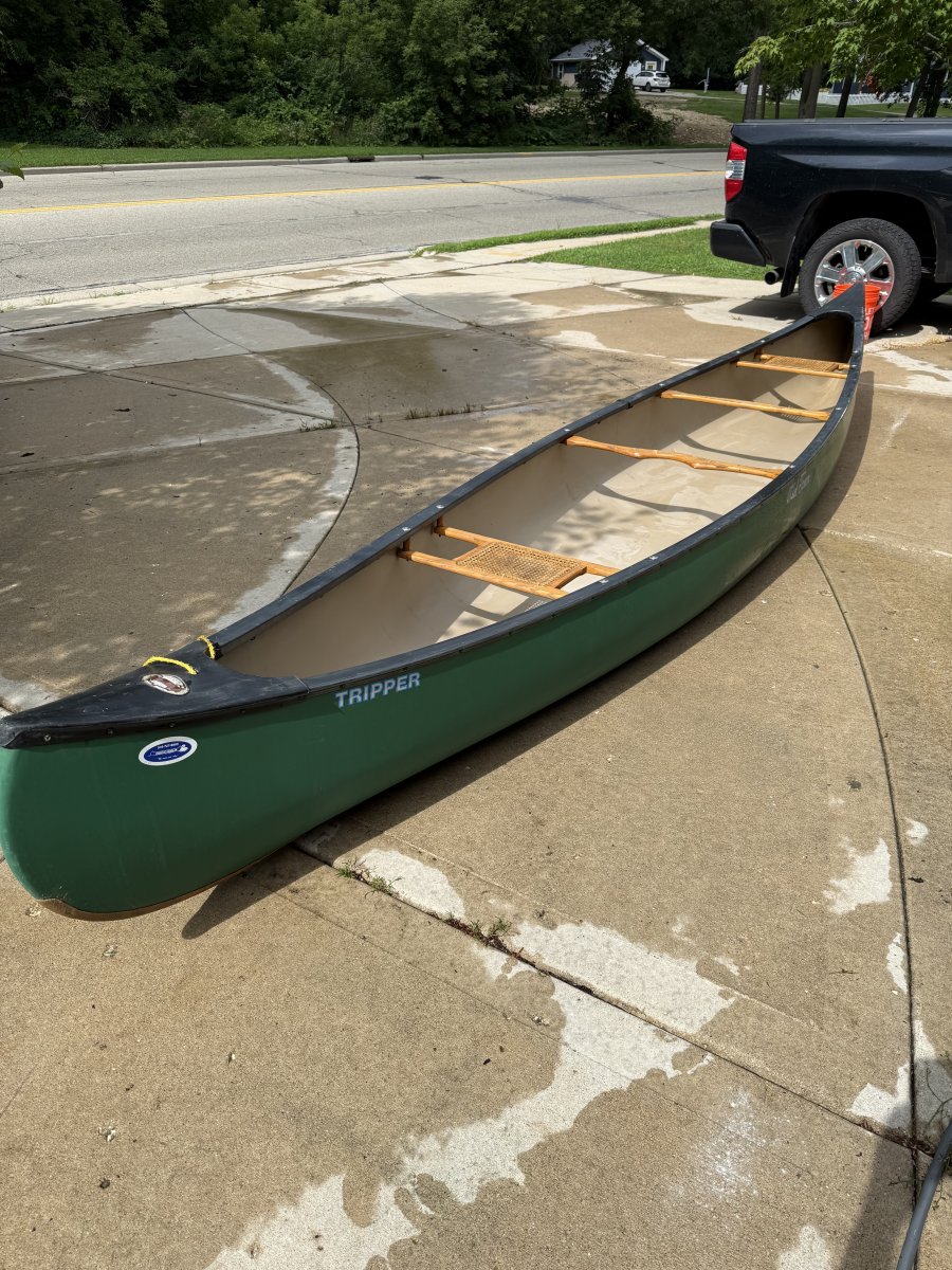

If you paddle it in fast moving or whitewater you might be wise to temporarily install a center float bag. When they opted for the cane seats, instead of the hollow rotomolded plastic ones the boats looked nicer, but much of the original flotation was gone. The only flotation it now has is the thin foam core inside of the laminate.
