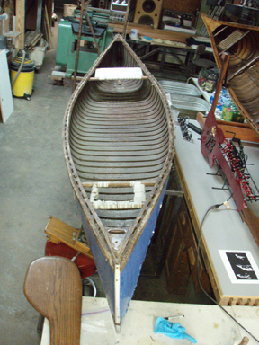

15 Ft. Old Town
Kathy---Thanks for your quick reply! This does seem to be our canoe. It has mahogany decks on both ends, and someone has cut small holes into them for carrying. It came with a home-built sailing rig. The next-to-last owner was a shop teacher in Overland Park, Kansas, and the rudder is simply the arm rest and writing surface from an old wooden desk. He sold it at a yard sale about five years ago to the man whom we bought it from. Ribs seems to be in pretty good shape. It has been fiberglassed.

The wooden Ojibway model was never advertised in the catalogs but appears to have been built on the same form as the fifty pound, lightweight, and trapper models. It frequently had a hand hold cut into the deck and they were often ordered by the Boy Scout organizations. I suspect that the use of mahogany for the decks was simply a matter of not having many other woods available in the middle of the Second World War. Good luck with the restoration,

I took some pictures and measurements of the Ojibwa. The decks are 10" long from the point to the inside of the curve. The cut-out hand holds are small; three of my fingers fit. The ribs looks to be full-sized, 2-3/8" wide and a full 3/8" thick at the keel. Spacing between the 14 ribs averaged out to 1.285". It seems to be a small over-built canoe---just what a Scout camp would need. The seats are not original and I can only find three places where threre is an imprint ghost of diamond head bolts. Could there only have been three thwarts and no seats? Does anyone remember this configuration being used at a Scout camp?

I have a 1941 HW 16' (see avatar). The build record showed "low ends, aluminum paint, and 3 thwarts/no seats". The original paddles are branded "FOCBSA" for Fort Orange Council Boy Scouts Of America. This topic was discussed 1-2 years ago on this forum. I believe the BSA liked to teach "proper" paddling techniques from a kneeling position. Your build record seems to indicate seats; mine had a definite reference to the seat omition.
