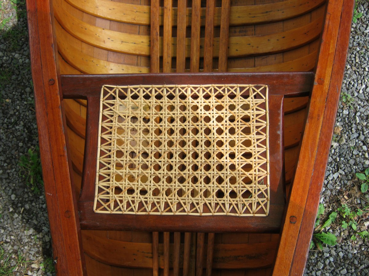

My 1906 Double Gunwale OT had bunged outside rails. Between the ends of the decks, very other screw was bunged.
The seat screws were also bunged. I was the second owner of that canoe.
Why not bung? They tend to be a PITA for repairs. More often than not you end up damaging them when they are later removed.
That said, they really do look sharp.
It's your canoe. Bung away. i have never seen an outwale bunged. Seat bolts were bunged until approx.(I refuse to use circa) 1921.
Why not bung? They tend to be a PITA for repairs. More often that not you end up damaging them when they are later removed.

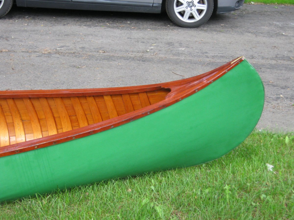

That now leads to another question: What's the OT protocol for stem bands that wrap around over the top of the deck a few inches like on yours? I've seen both. Curious if that varied from year to year or model to model (or both).
Paging Benson Gray! Arcane question of the moment on Aisle 2!
The stem bands on most Old Town canoes wrap around the top of the deck as shown on MGC's canoe. The first link below shows another similar example. The exceptions are early Old Town canoes with closed gunwales where the rails run past the stems. See the second link below for an example of this. Your canoe from 1936 with open gunwales would have had the stem band wrap over the top of the deck. However, 'it is your canoe' as Gil said so do what you like. Let me know if you want more examples.
Those were original stem bands on the DG. That wrap over the deck is how they were doing it in 06. It may have changed along the way. I am attaching another image of a different canoe that I once owned. It was restored by Chris Pearson. Chris is known for obsessive detail. My recollection is that this canoe had good original stem bands on it so I am presuming this image represents what OT was doing in the 20's. Benson will surely know. From my perspective, it should wrap over the deck in order to provide a bit of protection. Logically the shortest it can be is beyond the tip of the deck plus far enough to bury a couple screws.
