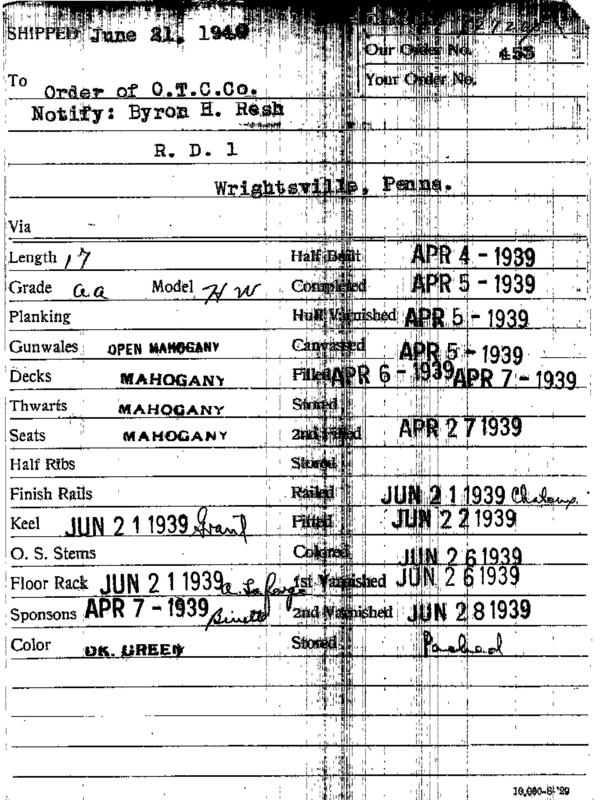

I'll post the build record of Old Town 127265 for all to see. It's an AA (top) grade HW model.This scan and several hundred thousand more were created with substantial grants from the Wooden Canoe Heritage Association (WCHA) and others. A description of the project to preserve these records is available at http://www.wcha.org/ot_records/ if you want more details. I hope that you will join or renew your membership to the WCHA so that services like this can continue. See http://www.wcha.org/about-the-wcha/ to learn more about the WCHA and http://store.wcha.org/WCHA-New-Membership.html to join.
