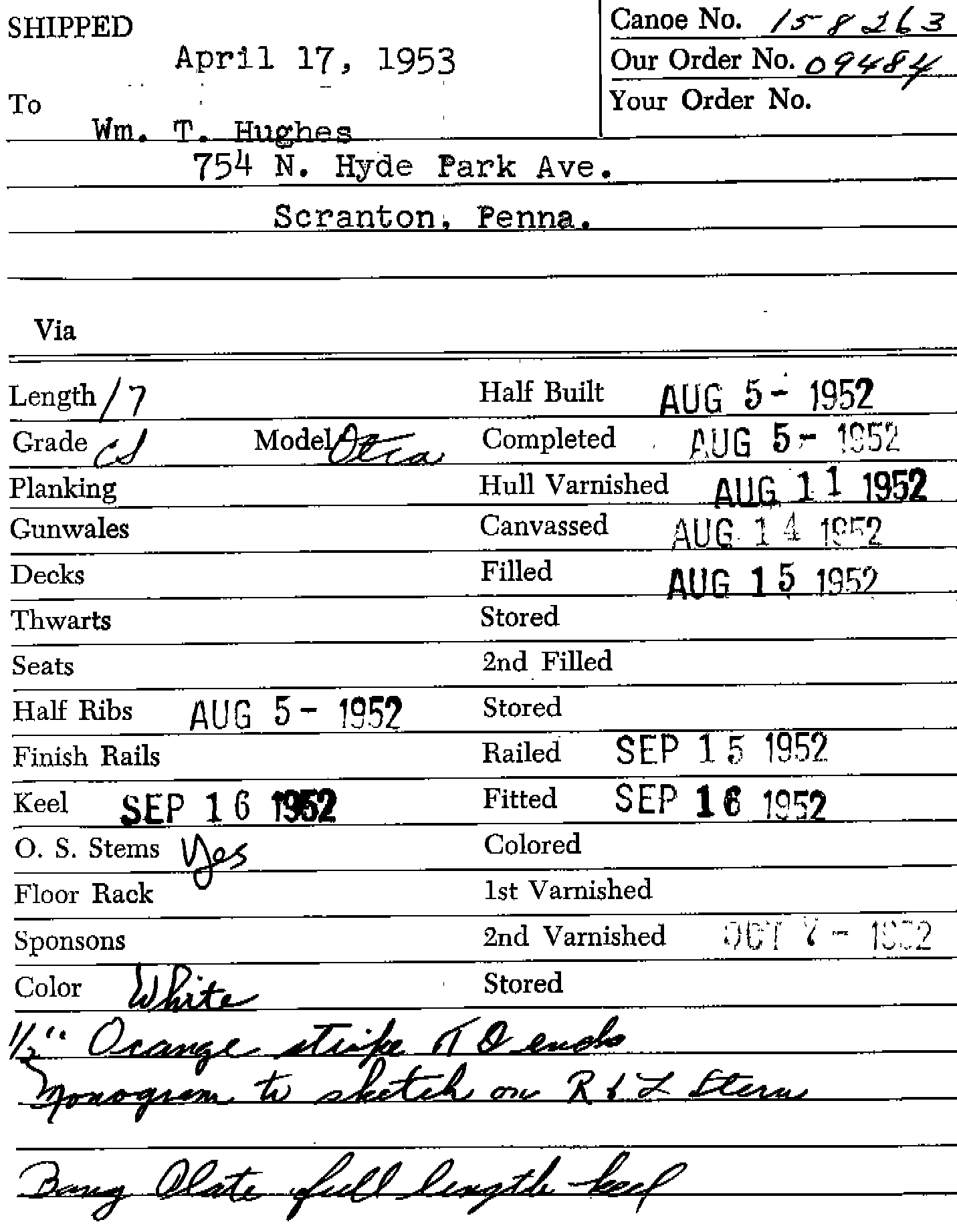

The Old Town canoe with serial number 158263 is a 17 foot long, CS (common sense or middle) grade, Otca model with half ribs, a keel, outside stems, and a bang plate along the full length of the keel. It was built between August and October, 1952. The original exterior paint color was white with a half inch orange stripe and turned down ends. This may have looked similar to the one shown at http://www.wcha.org/catalogs/old-town/designs/design27.gif which was known as design number 27. It shipped on April 17th, 1953 to Scranton, Penna. A scan of this build record can be found by following the link at the attached thumbnail image below.

It is possible that you could have another number or manufacturer if this description don't match your canoe. The messages at http://forums.wcha.org/showthread.php?57 have some good information about how to value and sell a canoe like this. The classifieds at http://classifieds.wcha.org/ are often one of the best ways to find a good new home for it. Has the original paint design been preserved and can you attach some pictures here? Feel free to reply here if you have any other questions. Good luck,
