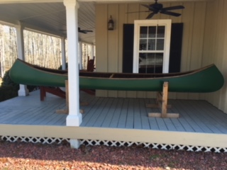

I recently took possession of a 194o-ish 16' Thompson Indian. It is in my opinion it is one great canoe....well except for what someone has done to it. I would like some input on what to do with it. Let me tell you first off what I see wrong with it. Here we go. First it was fiberglassed, even around the outside stems. The resin has oozed between the planking and has gotten between the ribs and the planking. It is not a good smooth finish. The decks, outside and inside gunnels are made of what looks like poplar. There is a cap on the gunnels that looks like a piece of pine trim. I peeled back some of the cap to reveal the rib ends and they are all gnawed up. It looks like someone took a very coarse rasp to them. The planking comes right up to the ends of the ribs and so does the fiberglass. The inside gunnel is rounded over on the deck side all the way to the stem. I counted 11 broken/cracked ribs and some less than ideal planking. 5 of the bad ribs are in a row. The interior vanish goes to looks OK to no finish at all.
I'm telling all of this to get you input into what can be done with it. NO MATCHES INVOLVED. I want to keep it. So here is what I think my options are:
1. Replace the gunnels and decks, sand down the interior and apply fresh varnish and use it for my river clean up rig.
2. Take the chance of destroying the canoe by removing the fiberglass and if it survives do a complete rebuild.
3. Just float it as it is
Option 2 concerns me because of the oozing/penetration of the resin.
Let me know what you think
#NO MATCHES INVOLVED

Norm, you have one of my favorite boats. They paddle great.
With all that broken wood and suspect repair work,
if it was mine, I'd remove the glass and resin, and then take on the bad wood.
Try a little heat on the glass and see what happens.
I'd sink it in the pond for a week and then remove all the fiberglass using a heat gun. Same for the resin residue (resindue?) Then just bring it back bit by bit. A big job but doable. I try to avoid glassed over canoes, but the last two I got were in that shape.

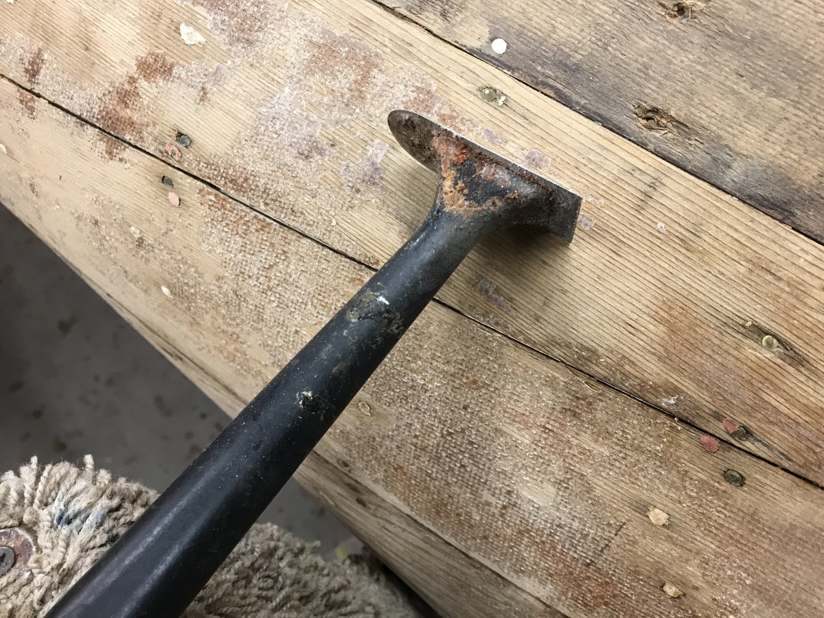

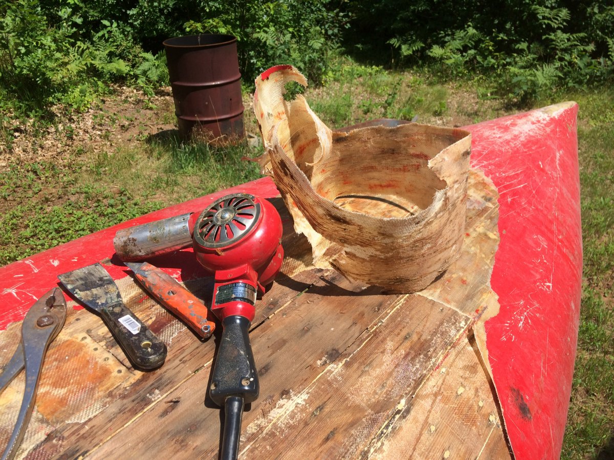

Removing fiberglass can be easy or hard. You won’t know until you start. A heat gun is the tool to use when removing stubborn glass. It is also needed to soften the resin stuck to the wood. Use a pull type scraper.
I try to remove all the resin in the seams. If it breaks away after you canvas it will cause lumps between the planks and canvas.
Wear gloves. The glass will cut you like a knife.
Here is a pic of a tough removal and an easy removal, and resin removal.
Well that's great you all think its worth rebuilding properly. It is usable right now so I think I'll take it for a float and see how she does.
I'll get some picture of the ends of the ribs and get some thoughts on what to do about them. I would hate to replace all of the ends if they are just roughed up but it will change the shear line if I cut them back to smooth.
