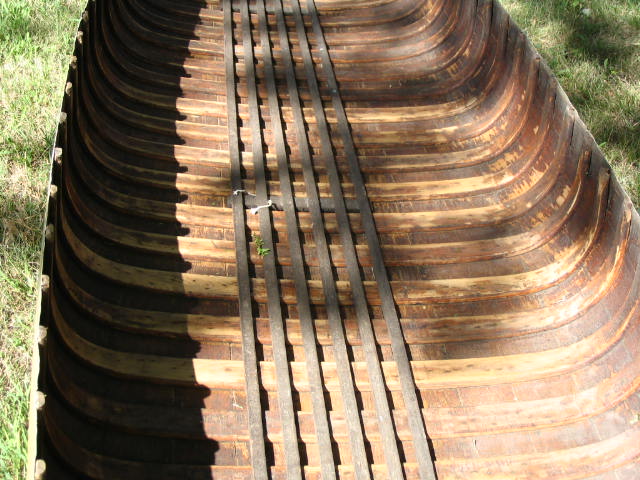

A couple of questions -- did you ever find a serial number plate? Is there any story on the floor boards? Most of the Morris floorboards I have seen (including my yet-to-be restored Morris -- see pic) have six narrow fore-and-aft board rather than your four wider boards. The wider boards seem like they might be more practical.

FWIW, the 1918 Morris I'm working on has a floor rack with only 4 runners.
