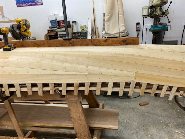

There was a mistake made.......symmetry matters.

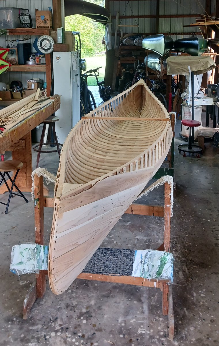

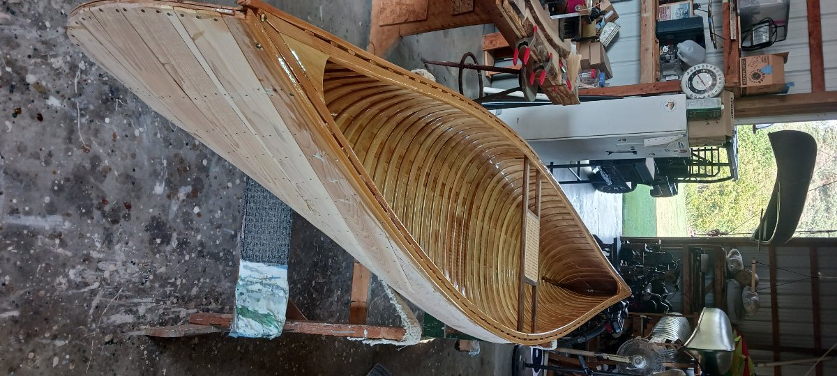

Update. I'm in no hurry, obviously. But here is the canoe with the inside varnished and ready for the next step.
Lovely! Clearly the ‘sliver’ planks were no problem. No thwarts in this canoe? What is the fastener at the tip of the stem?
I'm undecided on thwarts. I may put one behind the seat. The seat will get lowered somewhat. The fastener is new to me. It's a cup washer. Covered by stem band eventually
I may remove the cup washers when the time comes. But I also have a cup washer at the end of the outwales and they will stay so the piece had less chance to split. Weight is zero.
I find the intersection of inwales, outwales, and stem band troublesome. There's a lot to hold together here and I find it difficult to decide where to put screws close to the tips of the outwales to hold securely but not split the delicate pieces here, including the tapered outwales, inwales, stem tip, narrow deck tip, etc. -. Maybe a stem cap like on some Maine canoes which will hide the fasteners and provide wear protection... but generally I don't like them aesthetically.

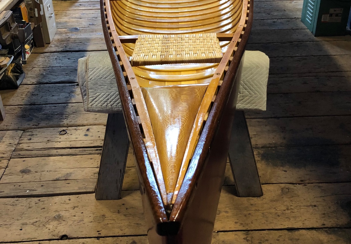

Thank you Michael. I do use tapered drills & countersink combinations. I even downsized from a #8 to a #6x1.25" screw at the ends of the outwales. Seen here:
Since the outwales extend past the stem, the last screw is only 2" from the outside curve of the stem. In the next view, prior to installing the brass stem band which passes between the outwale ends and onto the deck, the issue is that a screw from each side into that narrow & 'busy' area is fraught with danger: read... split wood! I even thought about drilling a hole through all members including the stem head, then installing a rivet and rove to pull it all together. The trouble there is that a rivet would be difficult to remove when it's time for re-canvassing.
Next time I think I'll let the deck pass over the stem head, though it's hidden from view by the stem band:
I'm not sure the tips are a major problem. The inside rails are well secured to the decks and the outside rails to the inside rails. Screws through the end of the outside rails will pass well into the decks and then depending on your choice into the far inside rails. The same is true from the opposite side. I have never seen a need to place a screw so close to the ends of the rails that splitting has been a major concern.
On a Traveller the copper end cap also somewhat ties the outside rails tips together.
It is only logical to pre-drill and properly size the pilot drills to match the screw selection. As an engineer with machinist experience I will confess...I cannot eyeball these. I use the screw and drill charts and measure everything with my verniers. I think that these tender areas need to be carefully drilled with the correct drill in order to avoid removing too much or too little wood.
And, beeswax or Irish Spring on the screws so that they elegantly shape their threads.
Agreed about waxing the screw threads. I always do so - doesn't prevent splitting but it does help prevent broken screws. As for splitting, you are correct, Patrick, that splitting can easily happen especially in the more delicate areas. But that's because people don't drill and countersink properly, or because they drive screws past the depth of the countersink, in which case the screw head acts as a wedge. I always take pilot holes and countersinks seriously and have never split a pice of wood.
You are wise to decrease screw size near the ends. As long as you have a screw large enough to have holding power, smaller screws can do the trick and even look better as the gunwales decrease in dimensions.

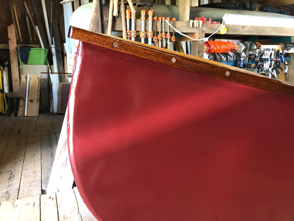

I go parallel for stem band screws including over the deck as well. My real problem is with the very old screws that don't have equal material beside a given slot.. On the gunnel try putting a fat side down beside another with the skinny side down. One restless night right there. And same goes for the vertizontal , 10 o'clock next to a 2 o,clock ? right.

Following up and in strong agreement... Slotted screws only, with slots aligned horizontal on gunwales, vertical on stem bands, etc. In other words, align slots parallel to the lines of the structure. In long decks where deck panels are fastened with screws, for example, align slots with gunwale. I hate seeing square-drive and Phillips screws in old wooden boats, except where originality requires. The Willits brothers began using Phillips at one point and Penn Yan used Frearson, so I use those as appropriate.
Some people frequently denigrate slotted screws because (especially in brass) slots can be buggered up, and in any metal, screwdriver tips can jump out and damage wood. Careful, thoughtful installation is the key, along with good screwdrivers. I use a nice set of parallel-tip screwdrivers (not wedge-shaped like most screwdrivers). These things seem almost magical. It's amazing that even in screwdrivers, a really good set is very well worth the investment. And with hand screwdrivers, you have control, you can feel what you're doing. It is tempting to use a drill/driver, but this is a good way to end up with damaged wood adjacent to the screw.
