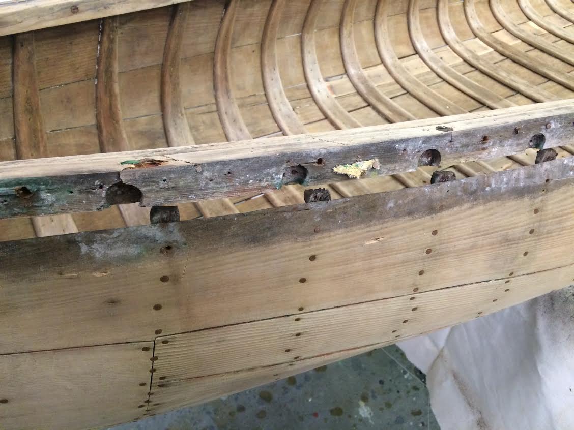

Here is the only photo of an original rib pocket on Kathryn’s 1893 Morris. As I recall all of the rib tips were rounded and kinda stuffed into the pockets. Some tips had like 5 tacks in them..

Exactly like our early one. I'll have to see if I can find some photos from when it was opened up during restoration. They would be prints though because this was a long time ago (about 25 years). Still have the canoe but now you can't see the pockets.

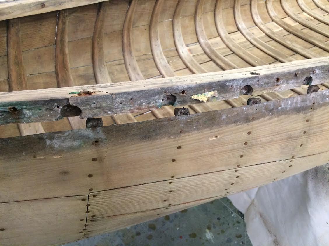

View attachment 43202 View attachment 43203 Here is another shot of Kathy's very early canoe (1893 or earlier) and shot of a Al Sienkiewicz's 1900 Morris showing just the tops of the pockets.
I was going to say that Kathy probably had more photos. I didn’t keep them all.
I was truly amazed at the amount of tacks in each rib tip. That along with being 125 years old caused Ferdy and I to need to scarf in ALL but one new rib tip.

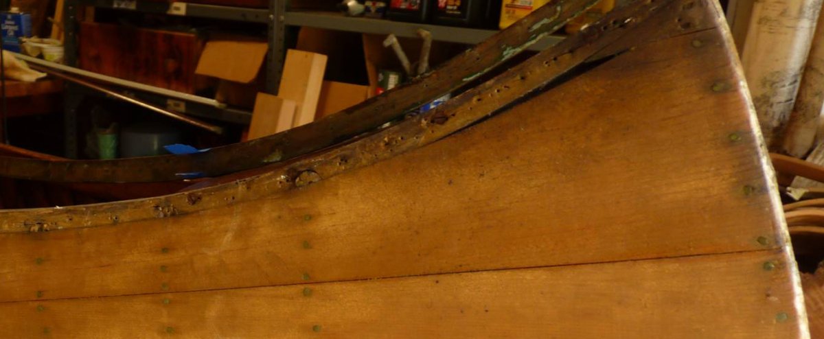

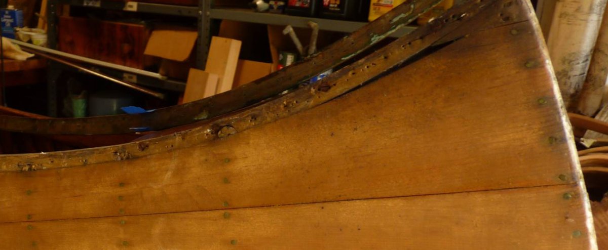

Not a great shot but here is a picture of early 8400 canoe if it helps.
