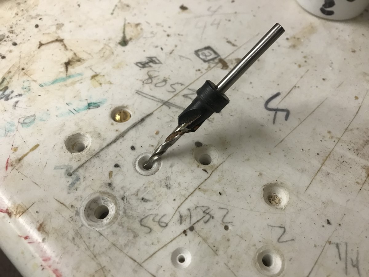

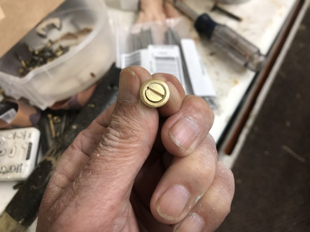

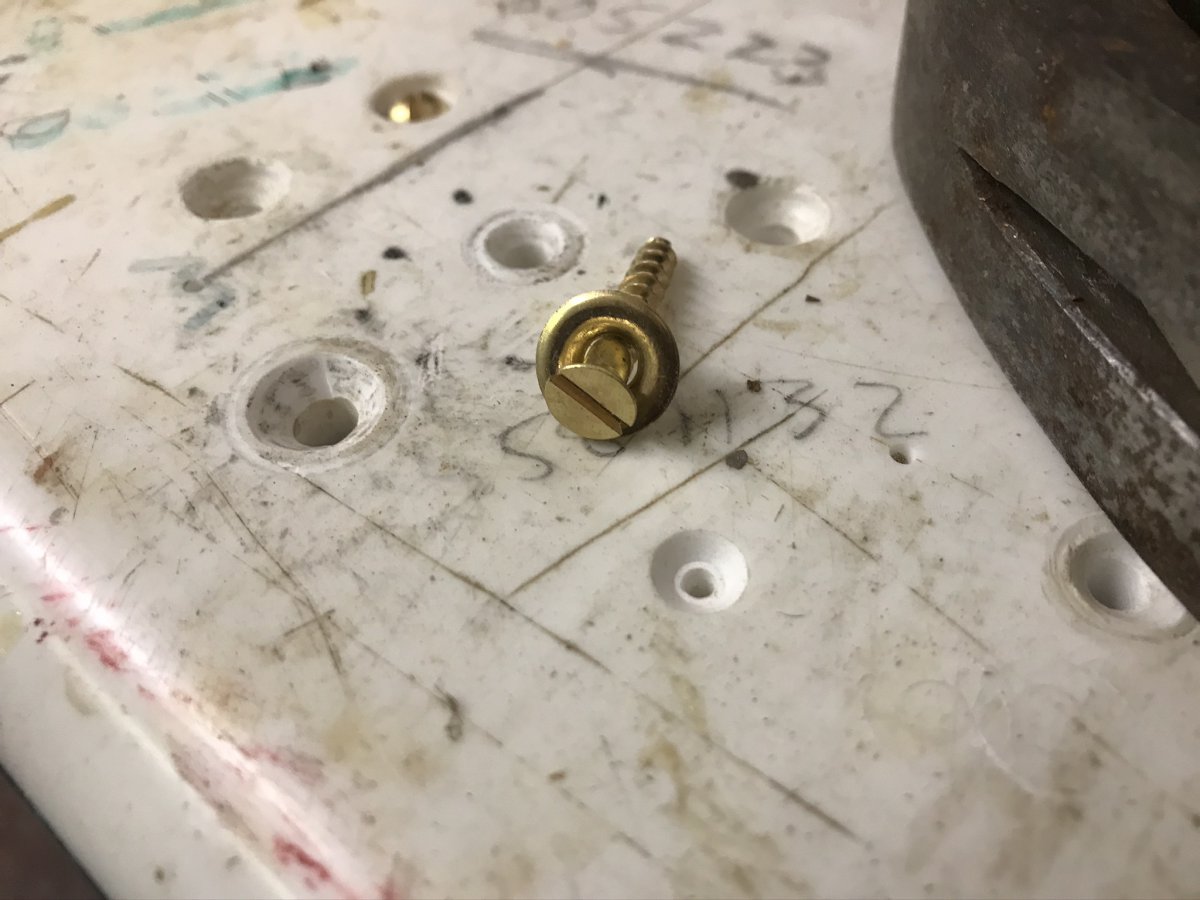

I have made them from regular finish washers. Using a drill/countersink that will match a #8 wood screw, make a hole in something harder than wood. I used a piece of Corian countertop. Then put a #6 finish washer over the hole and #6 flat head screw through the washer, into the hole. Pop it with a hammer until the washer flares out around the screw.
I found that a #6 finish washer and screw make a better size for the typical #8 keel screw.
You may need to screw around with the depth of the countersunk hole to get it right.
I’ll edit this with some photos soon.
