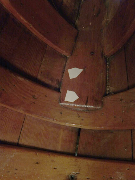

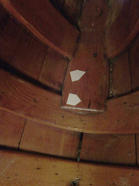

I have no tag.
I do have what appear to be tag mounting holes in the forward stem at the splay, see pic.
On the centerline, spaced 2 -3/16 in, fore and aft.
Is that the proper spacing for a post-1910 Morris tag ?
