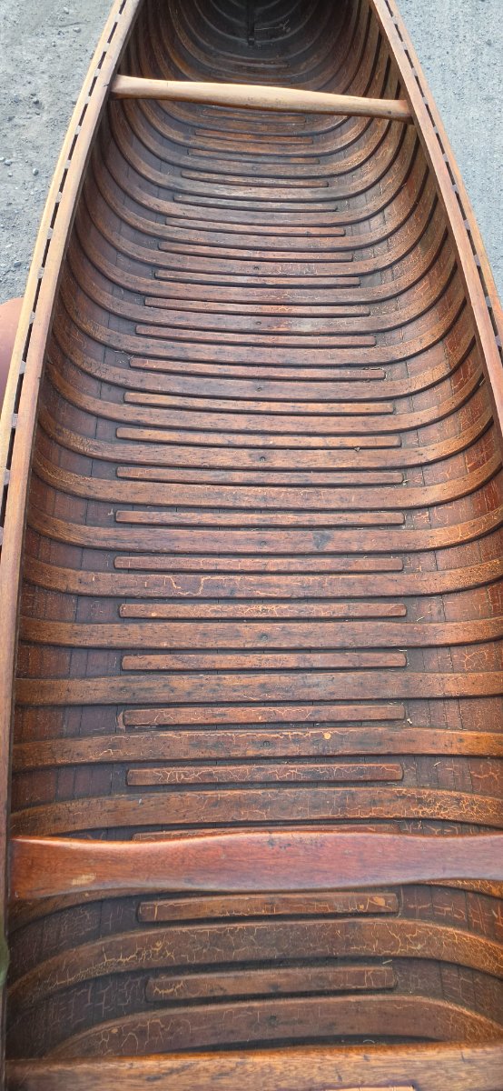

Welcome, the Old Town canoe with serial number 43304 is a 17 foot long, AA (or top) grade, Otca model with red Western cedar planking, open mahogany gunwales, mahogany decks, mahogany thwarts, mahogany seats, half ribs, and outside stems. It was built between May and July, 1916. The original exterior paint color was dark red. It shipped on July, 8th, 1916 to Allentown, Pennsylvania.

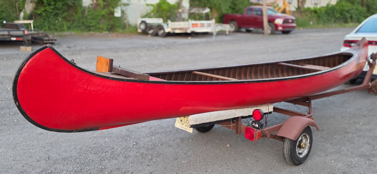

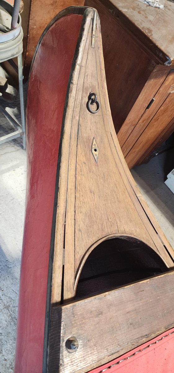

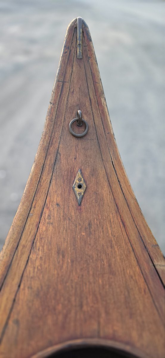

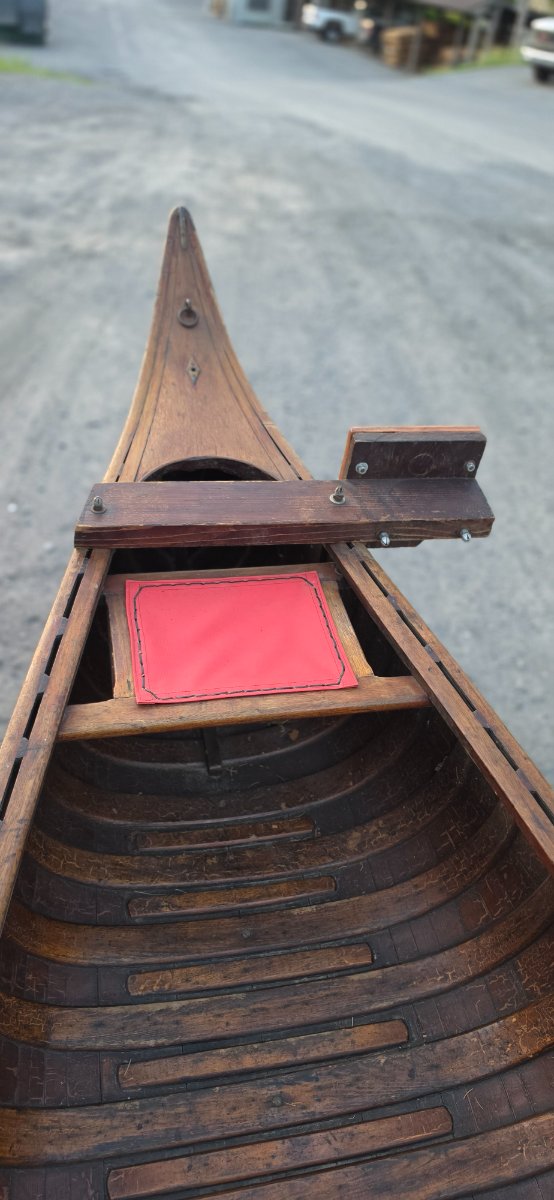

Hey Benson, Thank you so much! That definitely sounds like it. There are no Old Town markings but the description is accurate.I think it was fiberglassed at some point. So maybe down the road I can recanvas it. But for now it is in good shape. Also had rope rings and I believe diamond shaped flag holders and someone added a motor mount. Also a "hook" on the bottom Don't know what the value is but I liked it. I paid $750.

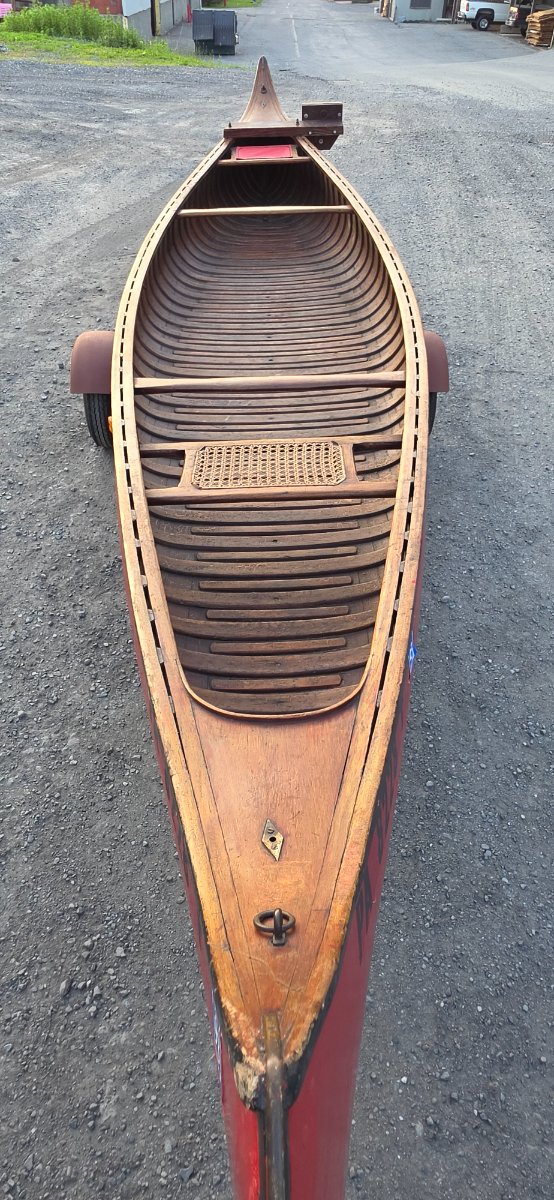

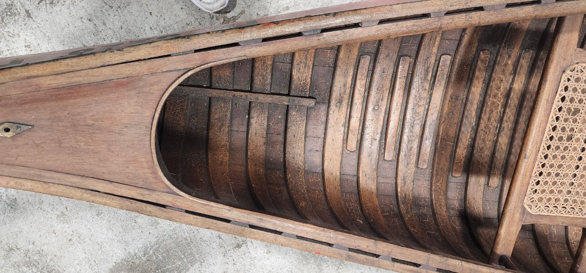

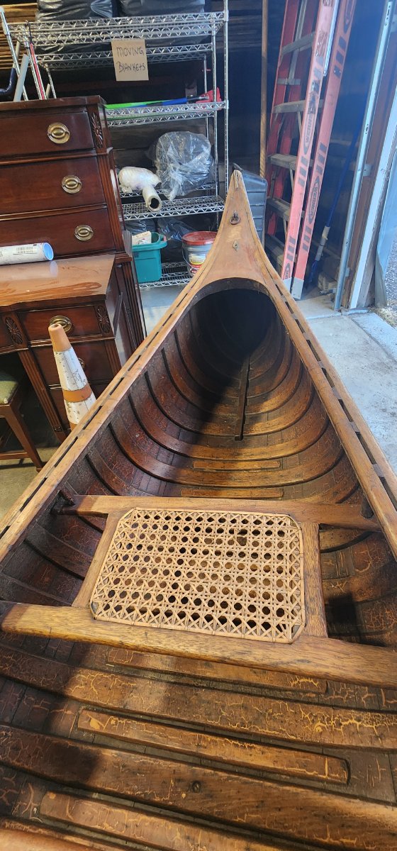

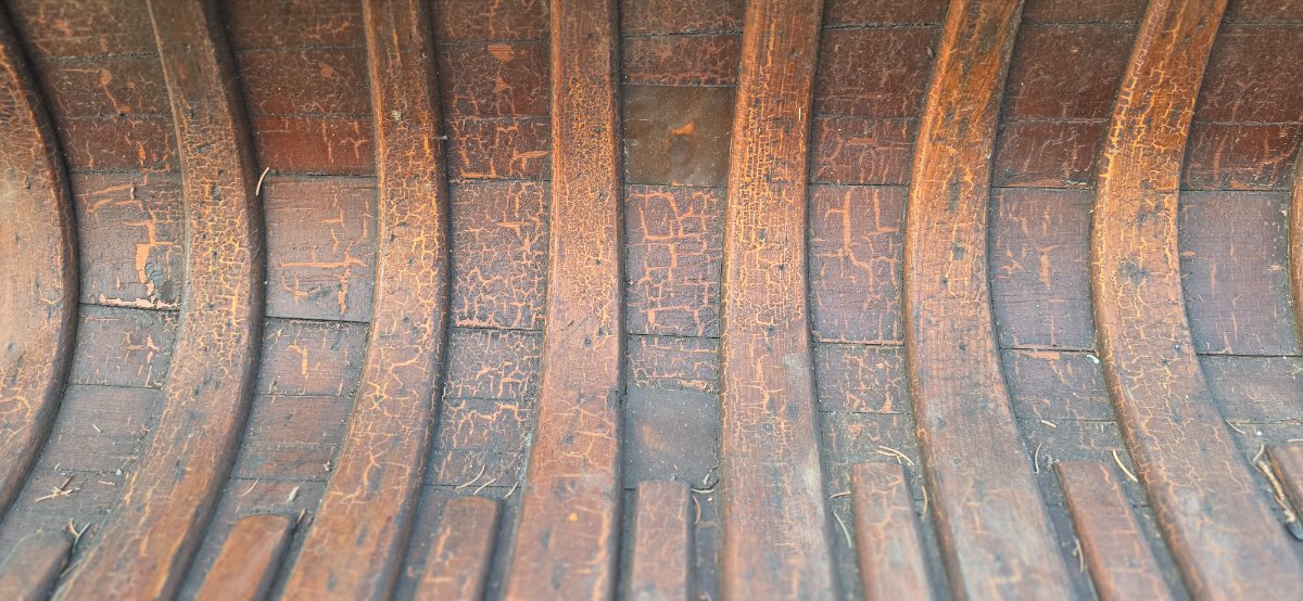

Wow, you got a great one at an excellent price. $750 would be a reasonable price for an old one in rougher condition, but this is an outstanding canoe from what I can see in photos. Teens-era Otcas were well built and this one is at the very top with its mahogany trim and outside stems. In this model and era, Old Town really paid attention to the details - beautifully chamfered rails and those gunwales that transition from open to closed at the ends (and more). And on top of all this, the canoe is exceptionally fine condition for its age! Great canoe!
By the way, it LOOKS like canvas to me, but maybe in person it's more obviously 'glass. Hope not but if it is, it can be reversed.

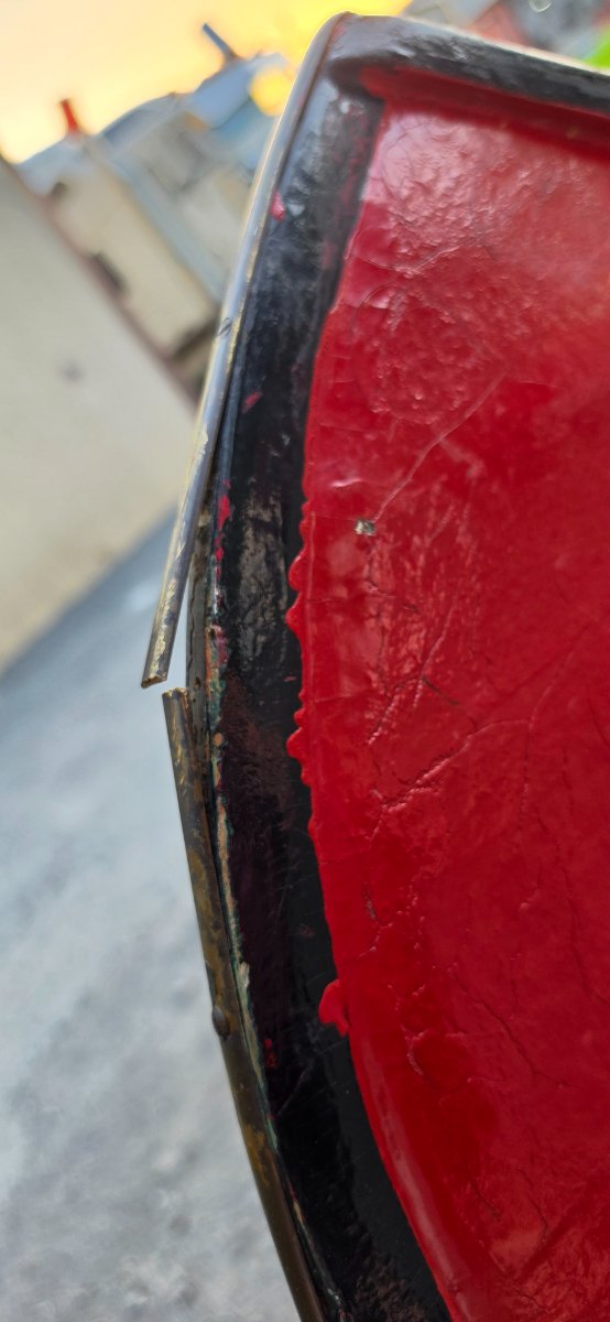

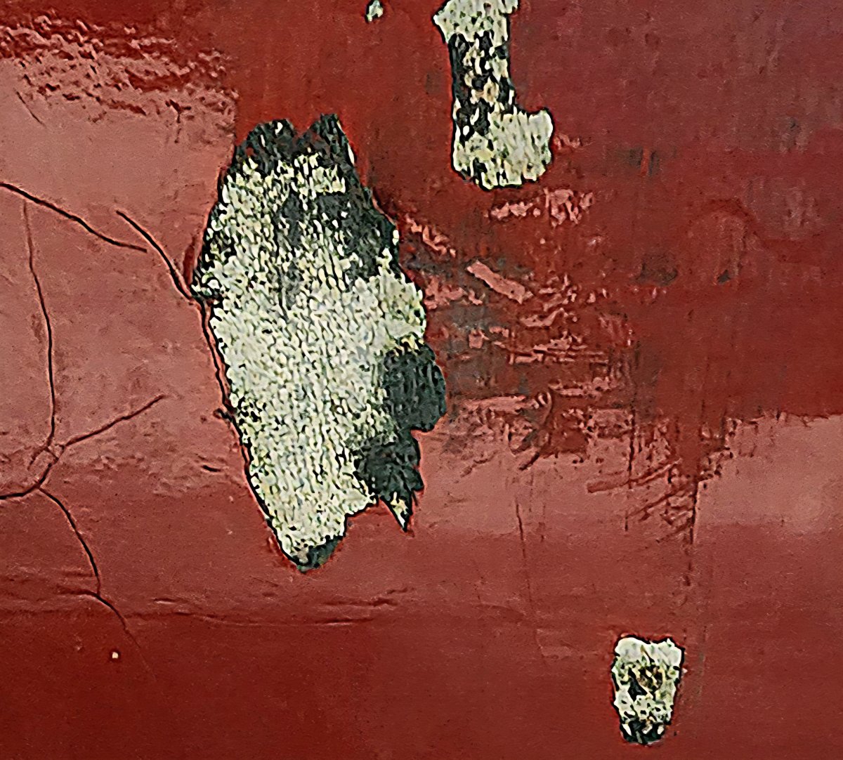

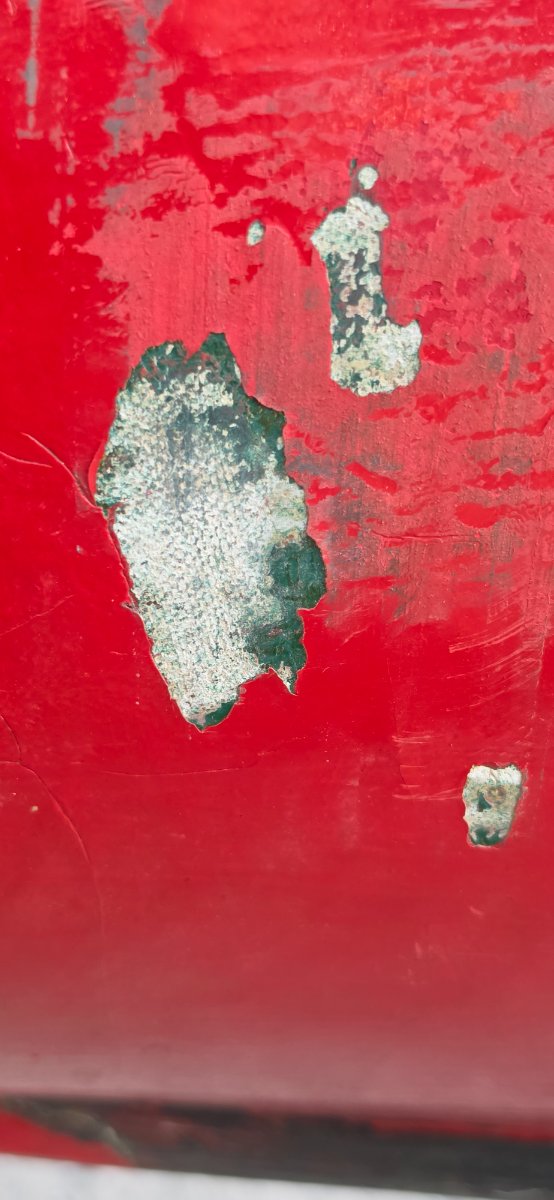

Thank you Michael. Maybe it isn't fiberglassed. I was told it was. I included the photo where the paint is missing to show what kind of material is underneath. Kind of new at this. Ha ha.

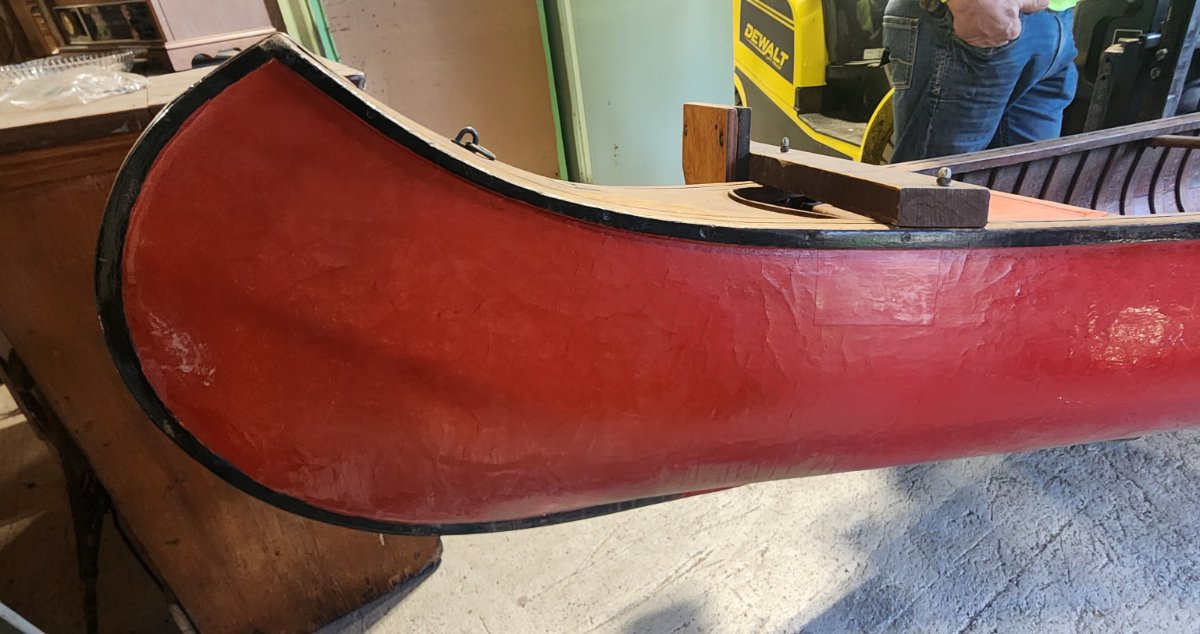

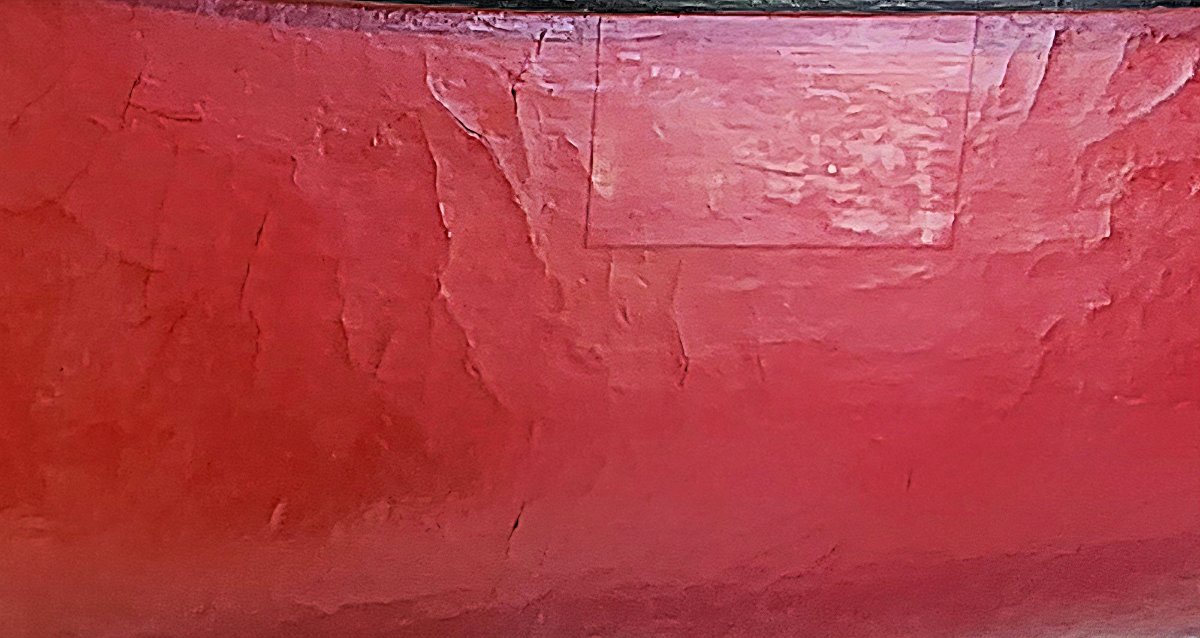

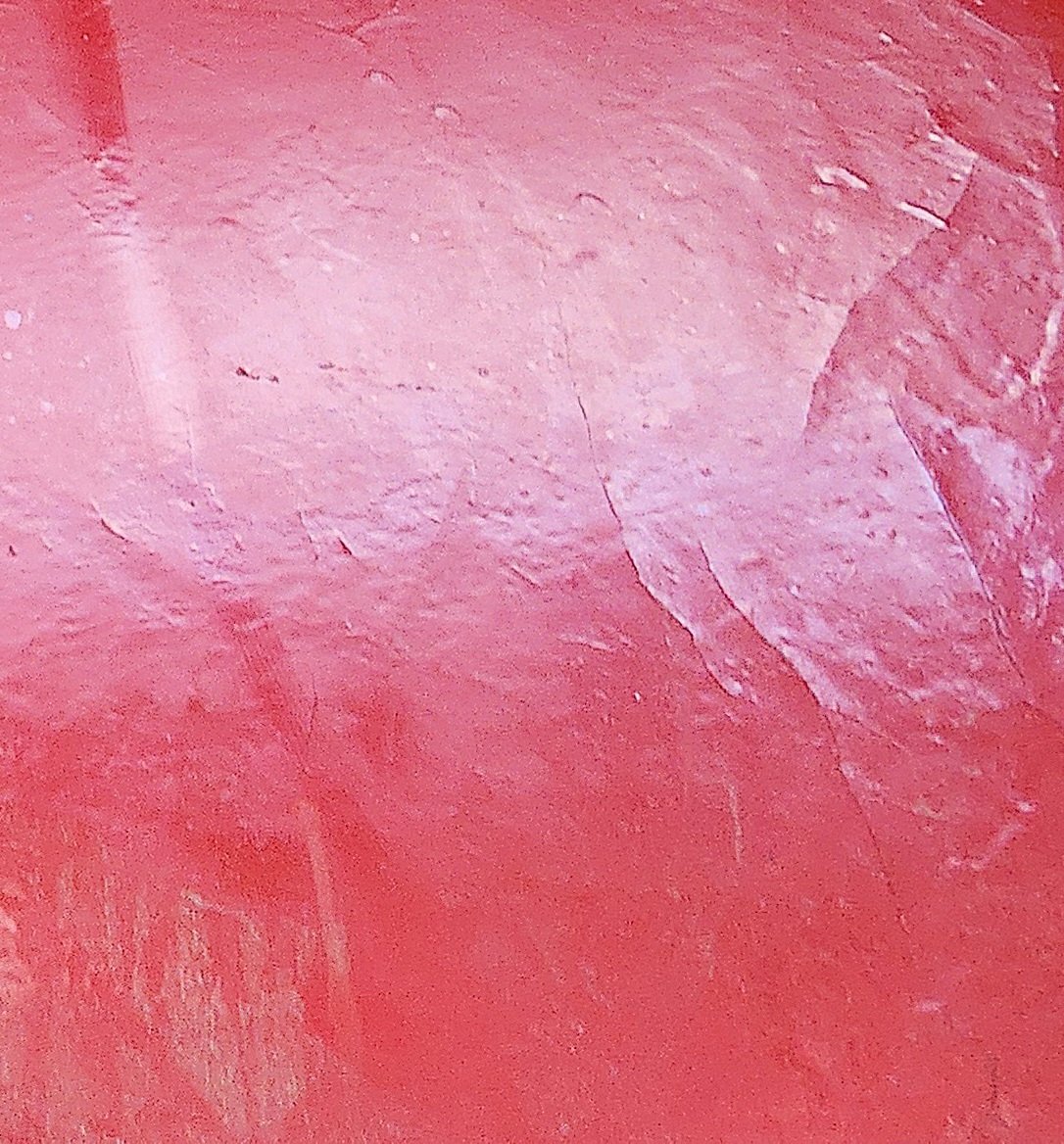

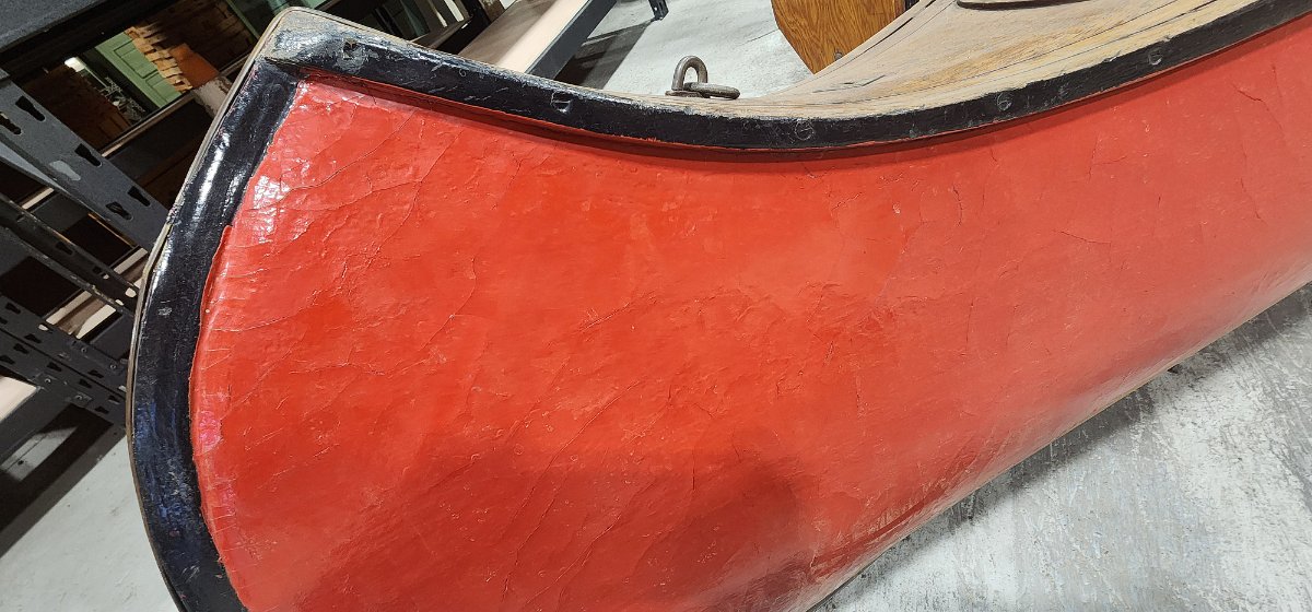

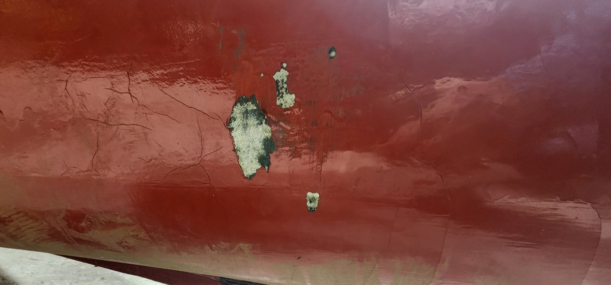

Here's a few more pictures of the paint. I'm not sure if fiber glass and canvas wear the same over years as far as cracking but maybe these pics will help.also I tried to sharpen up the pic of the material that was exposed where some paint had come off.

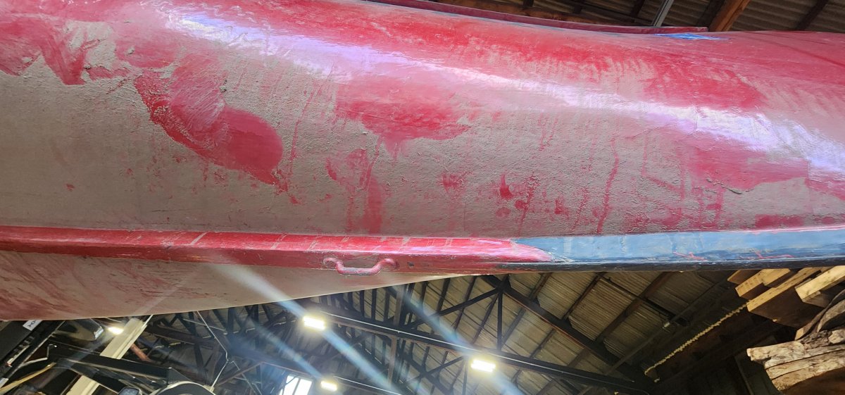

Wonder what the loop on the keel was for?
My guess is that this may have been for towing by a motor boat. Some Old Town canoes a bobstay mounted in a similar position for this purpose. The link below has some more details.
It sure looks like canvas. Try tapping on the surface with your fingernail. Canvas has a dull sound; 'glass will have a harder, sharper sound like you're tapping on hard plastic. There's one sure way to find out - tear into it. Canvas should not be adhered to the hull but 'glass will be, and old canvas like this should tear fairly easily; not so for 'glass. If you think you might not restore it, it is better to leave the covering intact, however.
I finally had rhe time to take some better pictures.From what I can see and from everything I've read and you guys have said. I feels like canvas to me!
