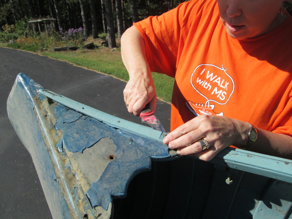

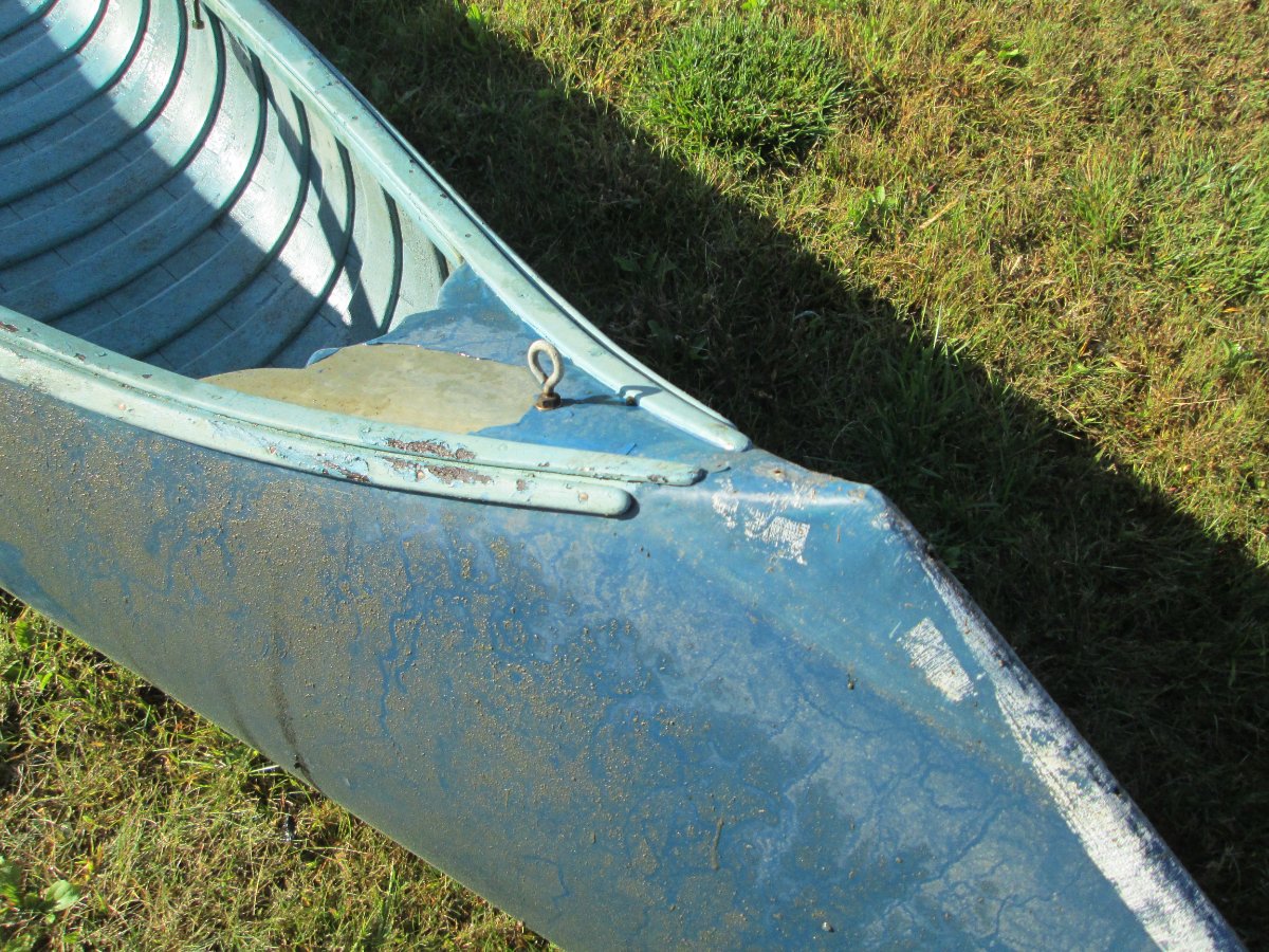

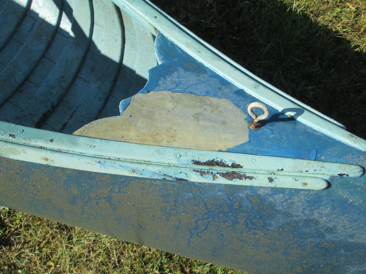

Dave Wermuth Who hid my paddle? May 2, 2025 #2 Couple photos attached. Not sure if it's early or late or mid. 1930's? Attachments IMG_2094.JPG 248.4 KB · Views: 202 IMG_2093.JPG 324.3 KB · Views: 183 IMG_2112.JPG 188.1 KB · Views: 203 7.7.20.jpg 198.9 KB · Views: 204
OP OP W woodworker Curious about Wooden Canoes May 2, 2025 #3 Dave thank you that was a big help. How did you bend the mahogany? Tom

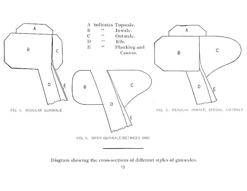

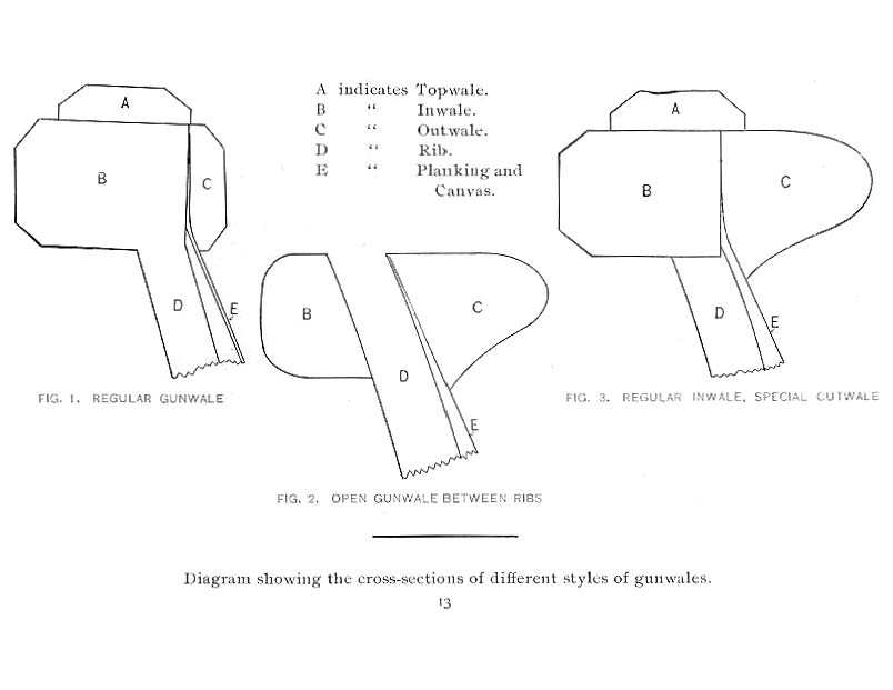

Benson Gray Canoe History Enthusiast Staff member May 2, 2025 #4 I believe that most Kingsbury canoes had regular closed gunwales so the diagram from the Morris catalog at https://forums.wcha.org/attachments/40310/ may help. This is from a general discussion at https://forums.wcha.org/threads/15625/ about bending gunwales. Benson
