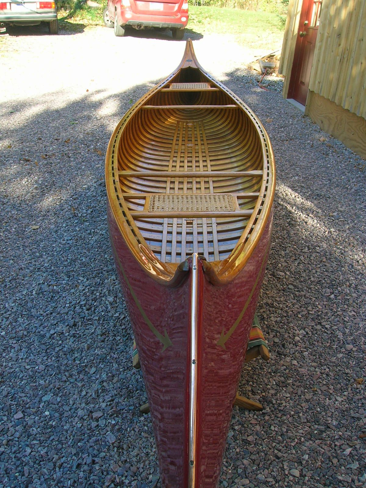

Pictures and opinions of bow seat?
I;m slowly progressing on the stripping and repair on this canoe. I'm doubtful I have the original bow seat. It appears to be different wood than the stern seat and gunwales. Also, there's no mast support in the floor of the canoe under the seat. Could anyone offer advice as to what bow seat this would have originally had? and any possible pictures? If not the sailing holed seat; just a version of the stern seat? I'm also looking for advice on making the floor rack out of cedar or mahogany as far as looks and versatility? Weight isn't an issue as it's already a fairly heavy canoe. Jamestown seems to be my best bet for varnish and two part teak cleaner. Probably going with Rollin for filler that's prove itself and canvas. I'm glad to see the other thread on the interest of the Kennebec decal as mine has the smaller version on the deck coaming and I wont be able to save it.

Hi John,
Your mast seat appears to have pressed cane, whereas the stern seat has hand-woven... so you are probably right about the seat being a replacement. With the longer decks on this canoe I'm guessing it was the A-grade and trim would be mahogany. The original bow seat would be a version of the stern... someone here probably has one they can post a picture of. The disk drive on my computer doesn't work or I'd find a picture from the Kennebec catalog, if there is one. But there certainly wouldn't be anything "wrong" with continuing to use this mast seat even if it isn't original, as it's part of the canoe's history... and if you wanted to sail the canoe you have a start on what you'd need. If you re-create the original bow seat, I'll bet you can find a home for that mast seat by posting in the classifieds.
Kathy
There are Kennebec threads at http://forums.wcha.org/showthread.php?3986, http://forums.wcha.org/showthread.php?7507 and http://forums.wcha.org/showthread.php?9049 with pictures. The images at http://forums.wcha.org/attachment.php?attachmentid=6436&d=1226254804 and http://forums.wcha.org/attachment.php?attachmentid=15516&d=1305808934 show the bow seat. The one attached below is from the 1927 catalog. I agree that the bow seat does not look original. Old Town floor racks were usually spruce but cedar or mahogany should be fine. Good luck,
