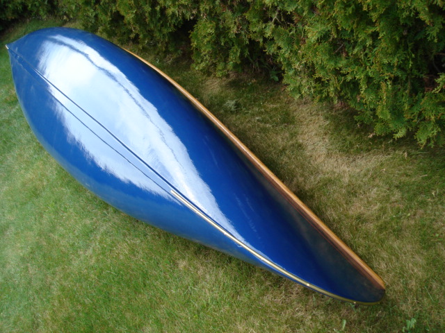

One option is a 'shoe keel' like the one shown at https://forums.wcha.org/attachments/38705/ for example. Keels have been discussed here quite a bit over the years so the search function should get you plenty of opinions. Keel questions often seem like a religious topic for many people so I generally avoid the subject. I'm basicly agnostic on this issue and own canoes with and without keels. The short summary is that keels can be some help if you expect to be hauling a canoe up on a dock alone, sliding over big exposed logs in a small stream, sailing, or learning the "J" stroke. They also provide a bit of extra strength to the hull. The down sides are that keel screws occasionally leak in old canoes, keels add weight, and can make quick turns more difficult. The leak issues can be resolved by replacing the bedding compound. An experienced paddler can usually handle a canoe with or without a keel. Removing a keel from a canoe that was originally built with one raises an additional question about the holes in the ribs from the keel screws. These can be filled with wooden plugs, cut off screw heads can be glued in, or they can simply be ignored. All of these things come down to personal preferences in my experience.

There is one style of keel that I like. The shoe keel that I have on my Chestnut does not interfere with paddling, but it does offer some protection.
The shoe keel has been around for a real long time. Howie's very early Rushton Indian has a shoe keel. If I were in your situation, I'd give that serious thought. The issue will be the holes will not line up correctly. A shoe keel is mounted with off-center screws. You could still use the existing holes but you will need to add more.
