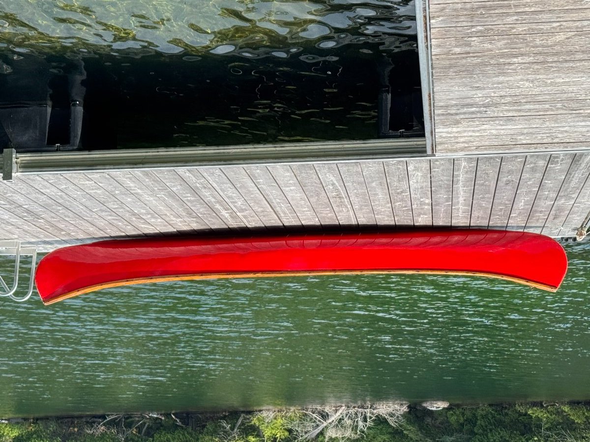

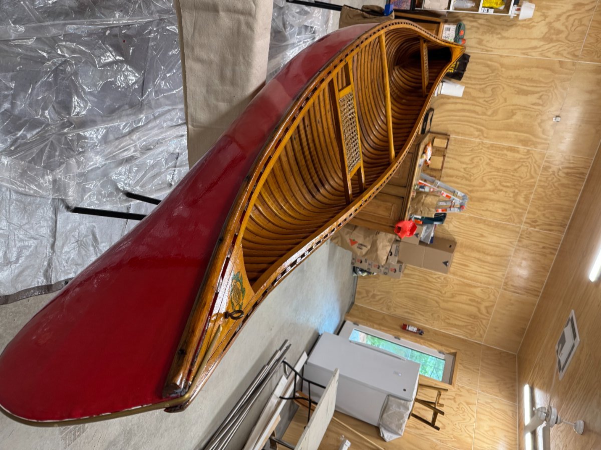

Well I finished the sanding, painting and varnishing (gunwales only - the interior was in good condition) and I am pretty pleased with the result. The paint job is far from perfect but it is fine for my purposes. IMG_9261.jpegIMG_9260.jpeg
