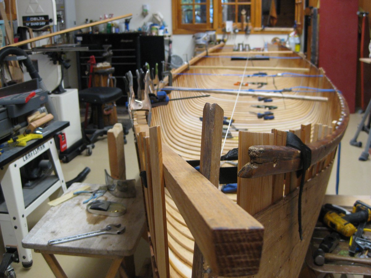

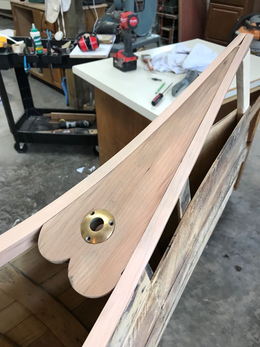

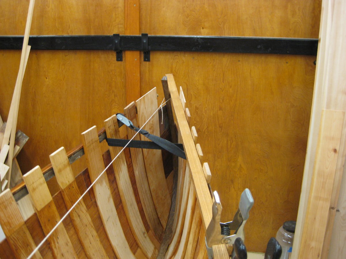

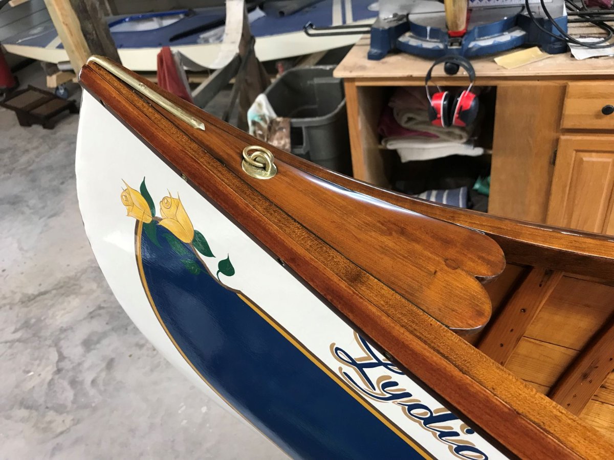

On the Rushton Indian Girl I restored a couple years ago the inwales are tapered on the inside. Tapering on the inside gives you the added advantage of being able to fit the inwale and the deck concave curve together better. As an aside the outwales are tapered also in both the horizontal and vertical axis. Pictures attached. If you have trouble sleeping tonight you can watch the whole restoration video. Resurrection of a Burn Pile Rushton Good luck with your project.

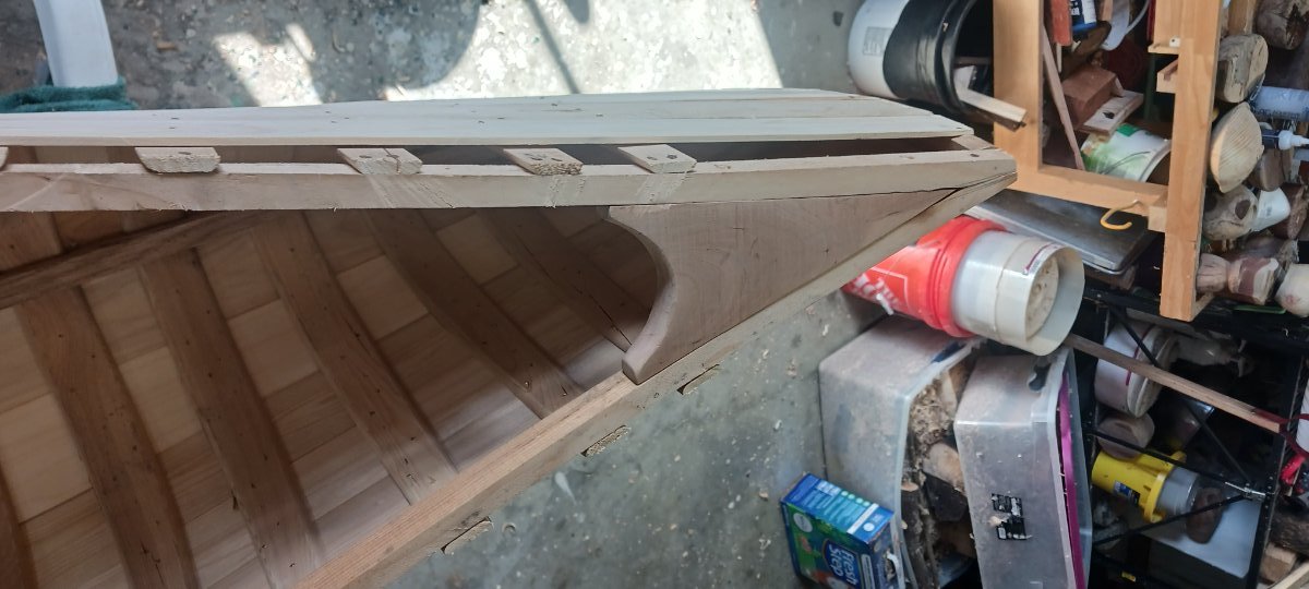

i've done it both ways. I now leave them intact. this photo is of my current new build, still under construction.
Okay, now I have to dredge up the intestinal fortitude to start cutting on the 20 ft ash gunwales.
Right now I'm thinking I'll taper the inside of the inwale and run it past the stem. Then do a tenon notch thing like Jerry Stelmok illustrates in the book he and Rollin wrote. (Page 107-108).
