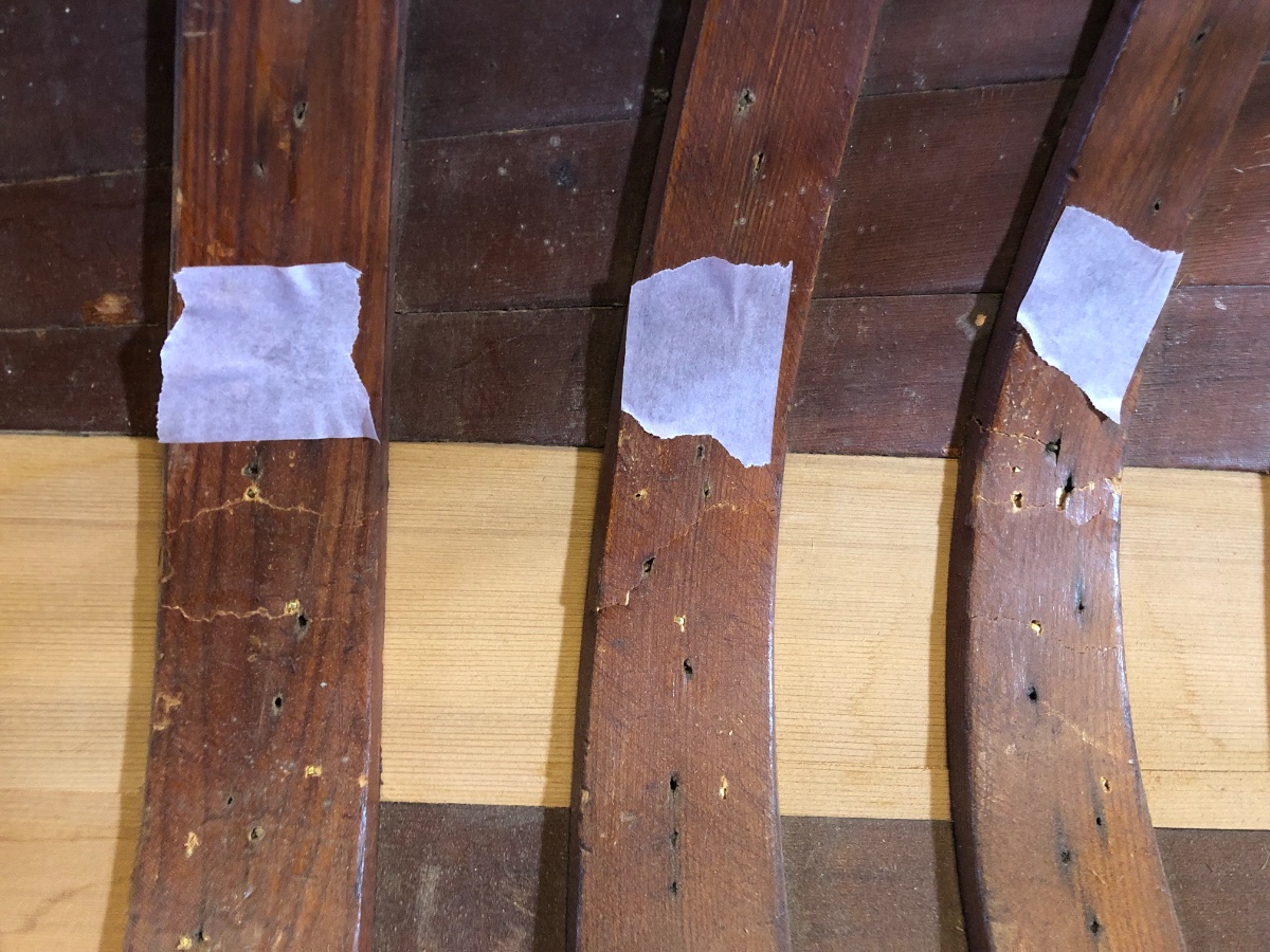

And besides, I still have stripping to do as well. But over the winter, while we had single digit temperatures, I had some new rib failures. While recently looking over the canoe in anticipation of warmer temperatures I discovered these fractures; there is fresh wood visible within the breaks so I know they aren't old breaks. I'm wondering if it was just the cold, or if my previous rib replacements and planking had introduced new stress into the canoe? The four ribs are indicated by the pink painters tape. On close inspection I suspect the new tacks played a part...
Pat,
Don't hesitate to pre dill the holes for the tacks (of course not to big). That has happened to me over the years but not 4 in a small section like this. Dry brittle wood and certainly at the bend :confused: with freshly added stresses. I've had ribs crack on my old Gerrish's just from moving and twisting them. Heard them pop!
