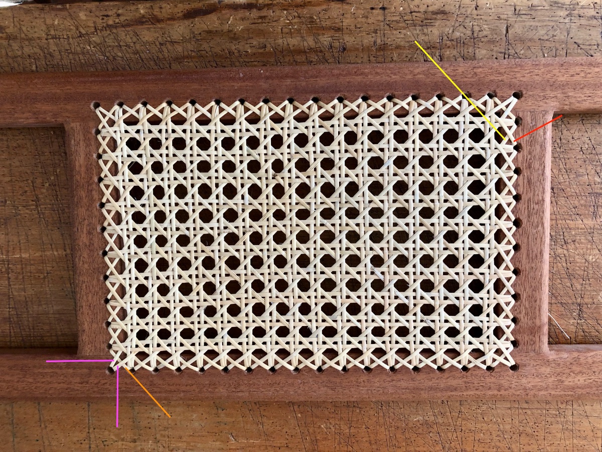

In another thread (and in order not to drift from that thread) found here: https://forums.wcha.org/threads/artificial-cane-for-seats.24184/ we discussed the minutiae of cane and technique. Here, I'm making another set of seats for an as-yet undetermined restoration. It'll probably go in another 50#er I acquired which has elegant D-shaped mahogany outwales. Anyway, having completed 6 steps of the common 7 step pattern, I was reviewing my work and on inspection I found what I think are two consistent errors. In the picture below, I think the red indicated canes should have passed under the yellow on each side of the seat. As well, the orange indicated canes should have passed between the pink at each of the four corners. Your thoughts are welcomed!
